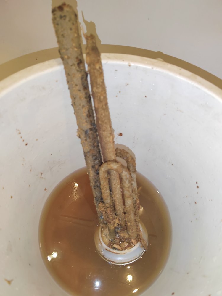

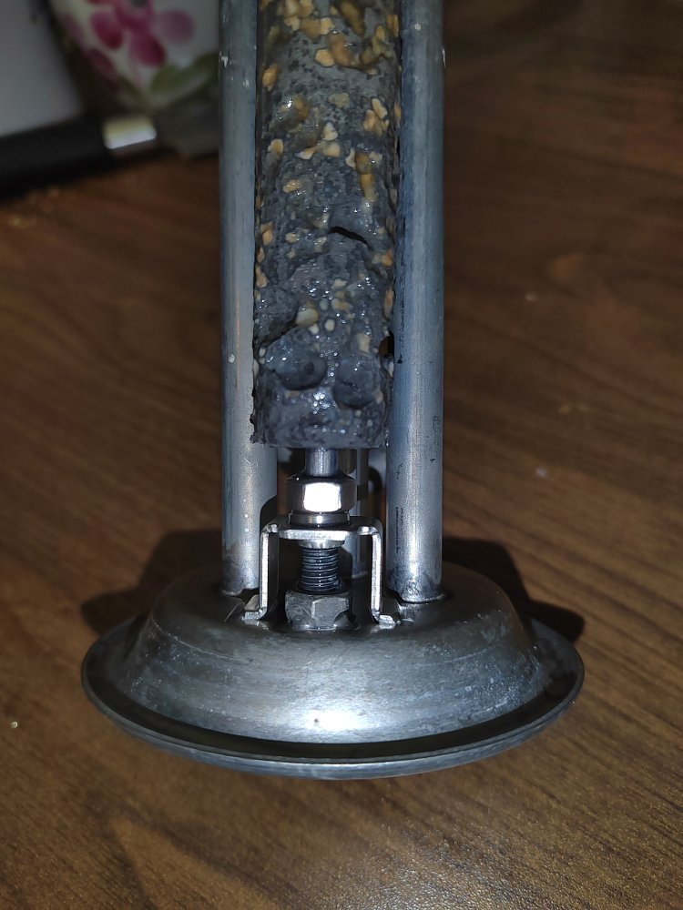

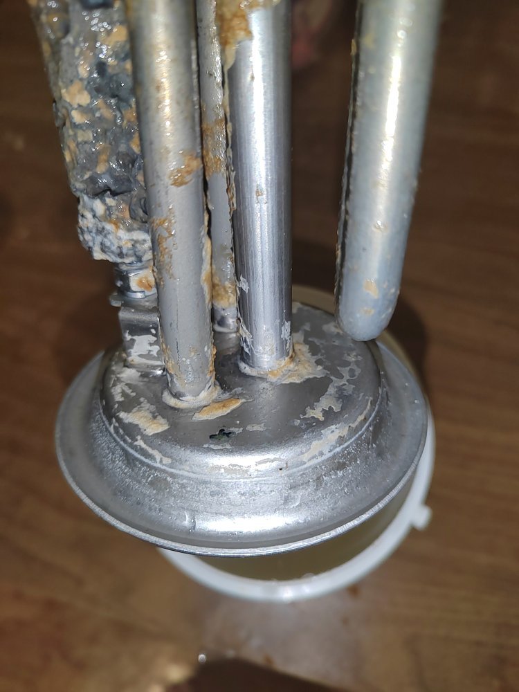

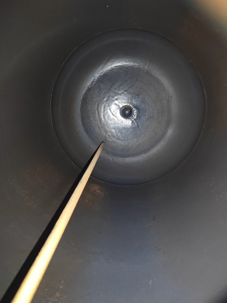

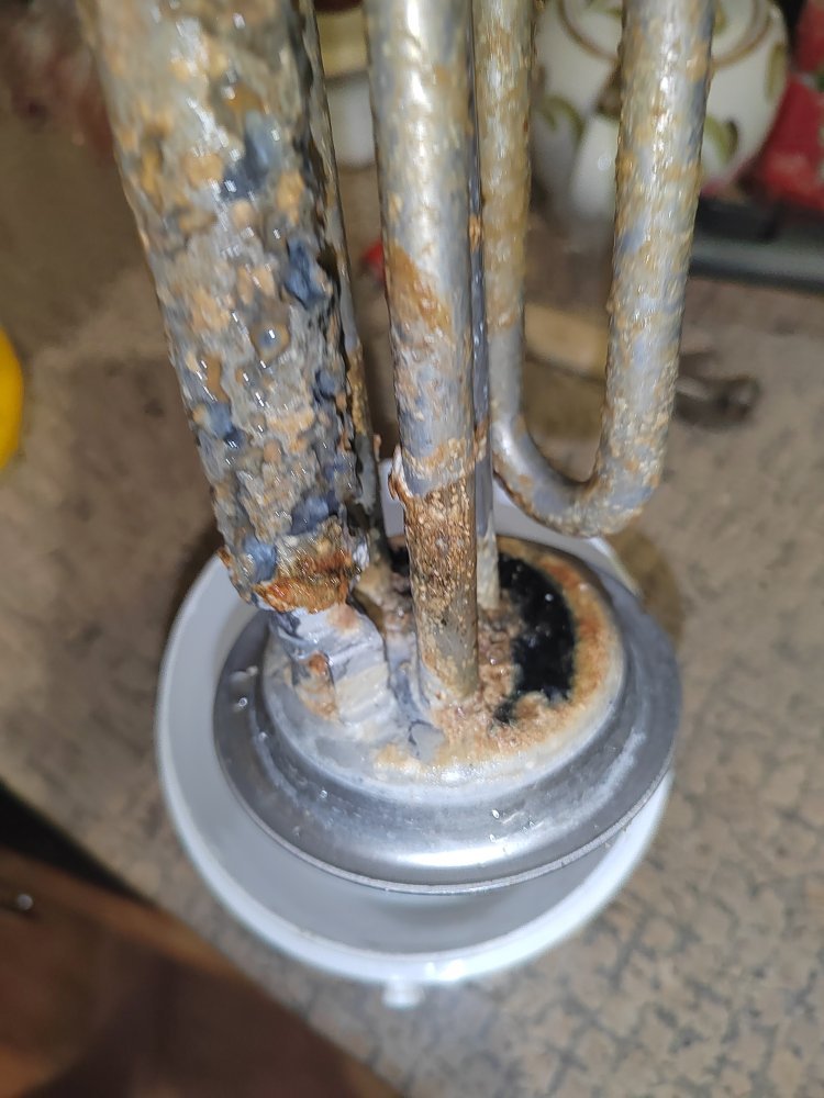

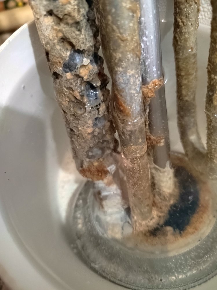

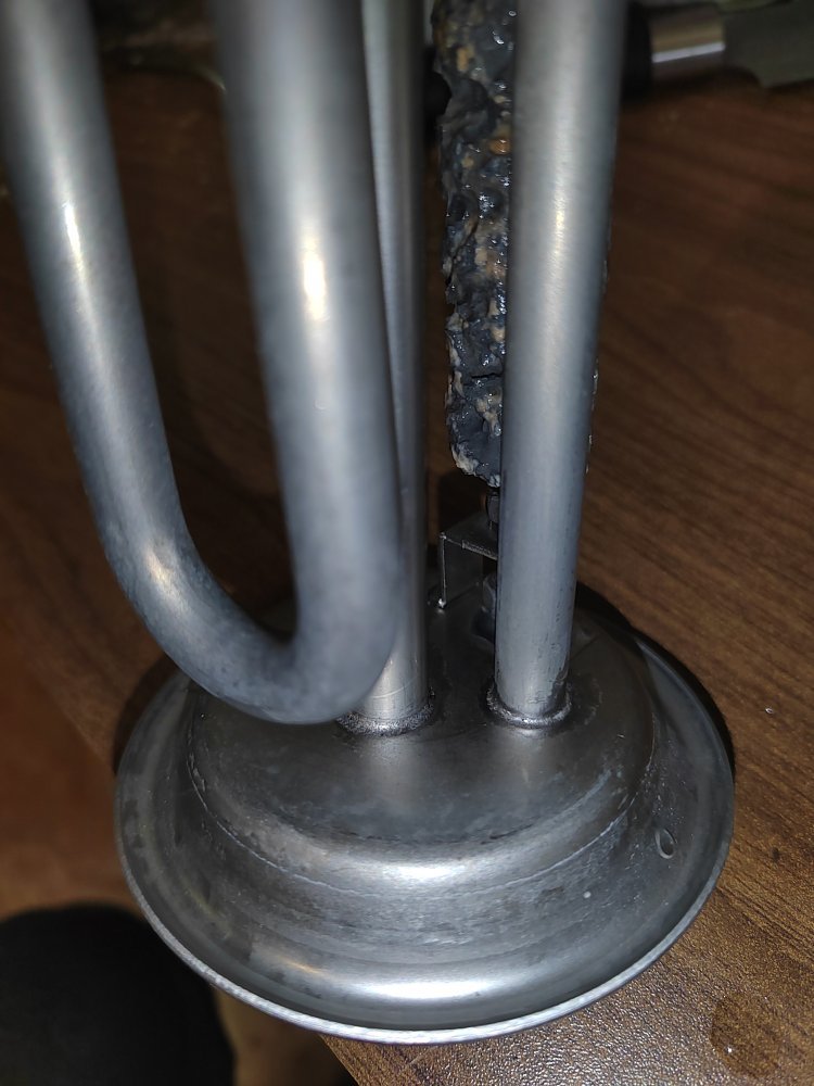

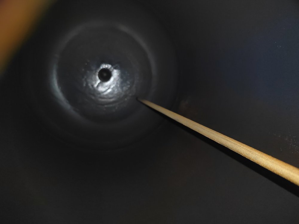

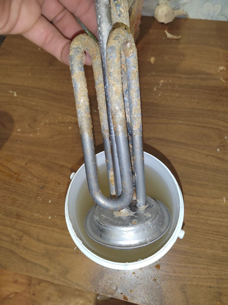

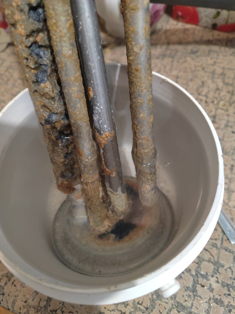

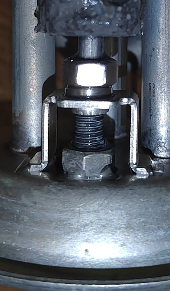

I disassembled a 7 year old water heater. There is scale buildup on the heater, the magnesium anode is in good condition. tank is in excellent condition. The heater was placed in an EDTA solution overnight. In the morning, most of the scale was dissolved. Made a fresh solution. and placed it again, we'll see the result in the evening.
IMG_20231210_001112.jpgIMG_20231210_002302.jpgIMG_20231210_002604.jpgIMG_20231210_002612.jpgIMG_20231210_002829.jpgIMG_20231210_003023.jpgIMG_20231210_081717.jpgIMG_20231210_081725.jpg

Looks like you also have an anode rod on that heating element and it's in bad shape needing replacement. Some heaters have more than one anode rod. To get a longer warranty aka 12 years vs. 6 years they simply add a second anode rod.
Yuppers- the anode is supposed to disappear over time. That saves the tank from being eaten away.
Just like having the anode in your radiator saves your radiator from being eaten away.
That TrilonB (EDTA) works nice! Now to find out if amazon sells it…. Haha.
