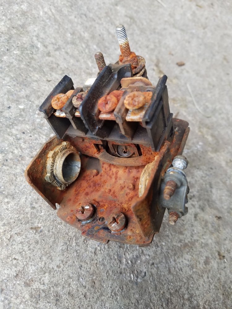

Not quite back together. The 4” high wood platform it was on since 1973 was toast. Ripped it out so now it sits on the concrete. So had to run to hardware store for a bit more exhaust length now. Once that is in I can fire it up. Already tested for water and gas leaks- thats all good.

Iron oxide is good for your blood, not good for your pressure switches…
