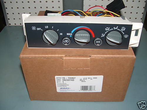

I’m not sure what the part number is for my 95 but it looks the same as the 15-72548 just has three connectors on it. One for the blower and two that come off the circuit. It doesn’t have the side connector like the 96+ does or the ribbon circuit on the back with the removable or replaceable lights.
Here is what mine looks like other than the plastic on the back is all broken up. I think it’s the right part number for the 95. I took these photos off of flea bay!! Even RA doesn’t show a Delco one for my truck!
That top pic looks very similar to the control unit that the 2000 truck has. The only difference is the buttons for the AC and recirc are on the top.

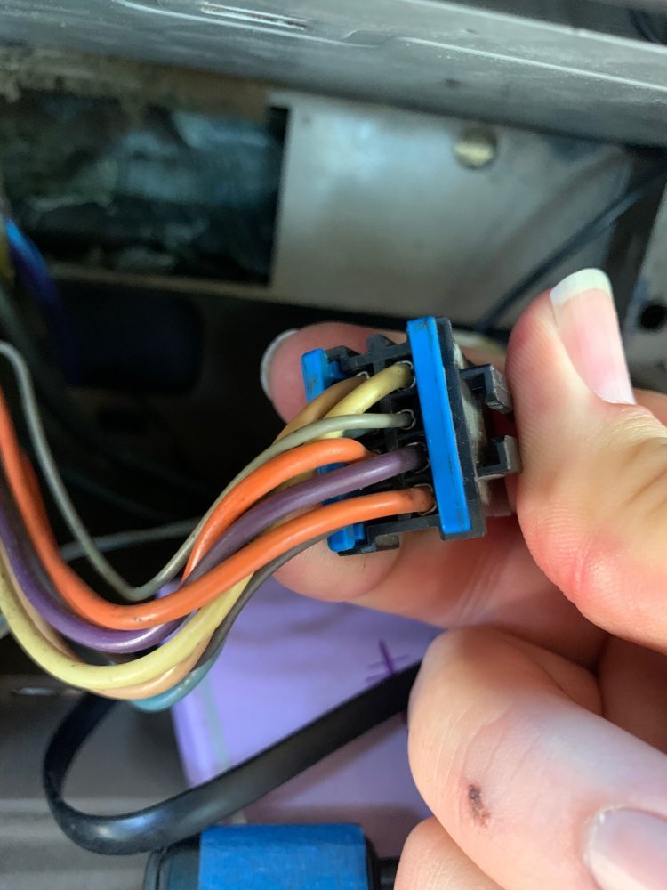

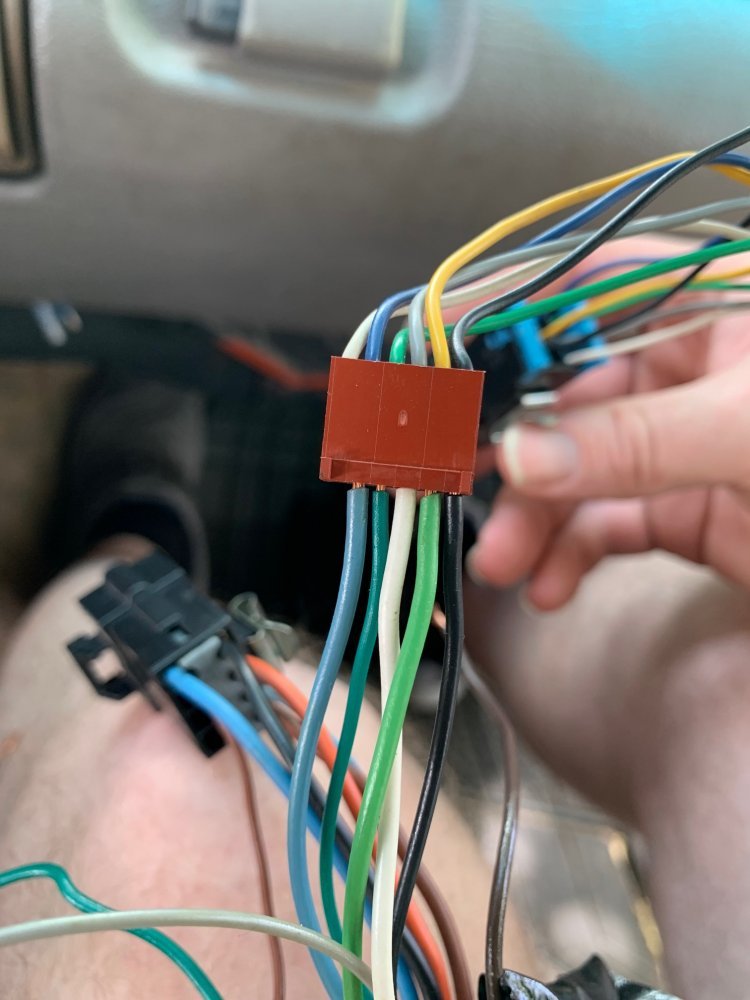

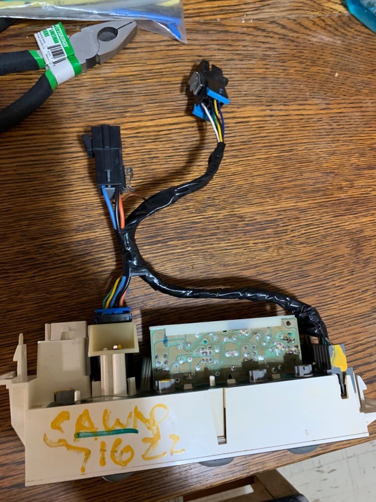

I found some diagrams on DP from the service manuals for both 95 and 97 year models. the connectors are different but looks like they use the same wire colors and same number wires. the diagram for the 97 is spread out between several sections, blower, air delivery, temp, and compressor control where the 95 diagram is on two pages and simple. I will see if I can put the different sections together as best as I can on few pages and compare them. I think it will just be a matter of scavenging a newer control and the connectors. using the connectors from the 97 harness and the ends on my current control to create a conversion harness to plug in without having to butcher the harness in my dash making a direct plug and play conversion! this will same me some money :)

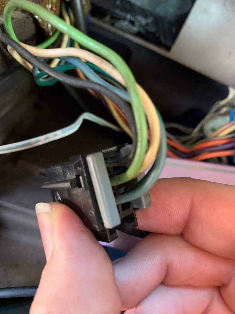

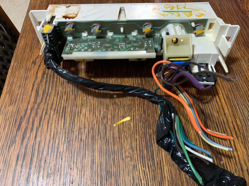

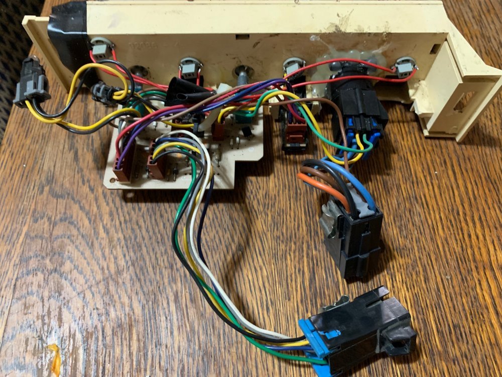

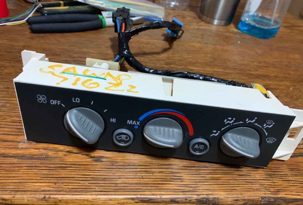

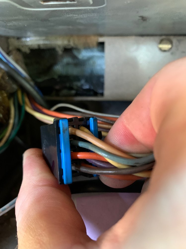

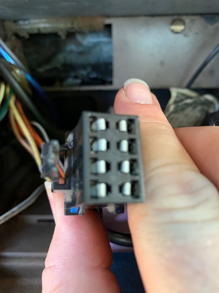

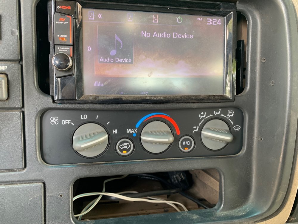

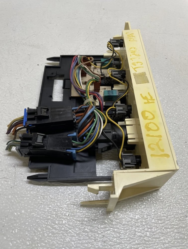

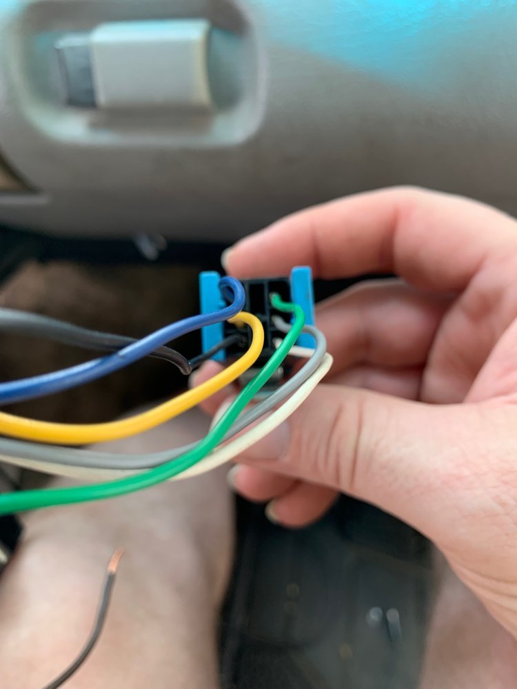

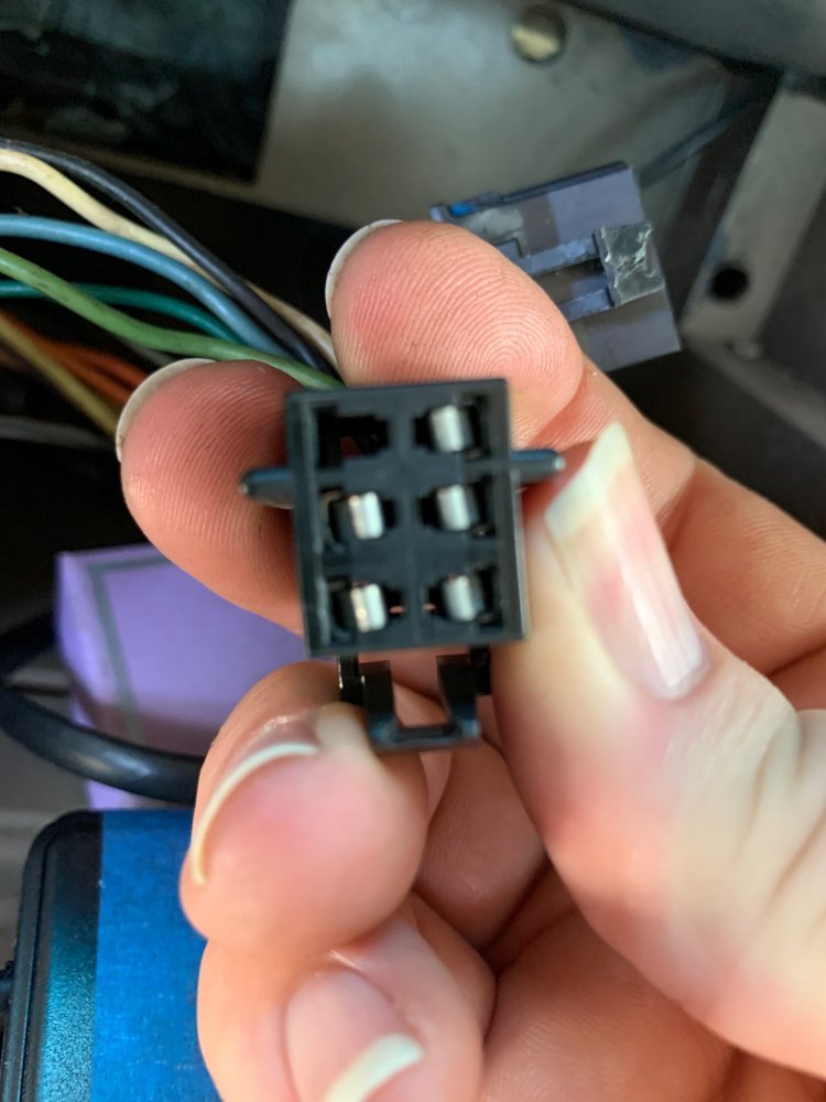

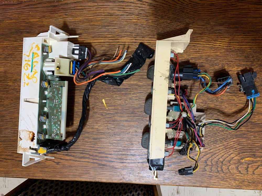

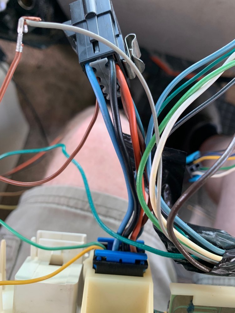

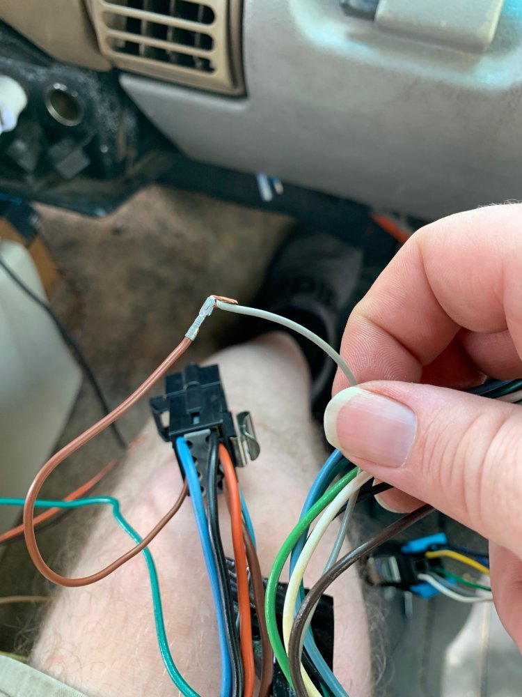

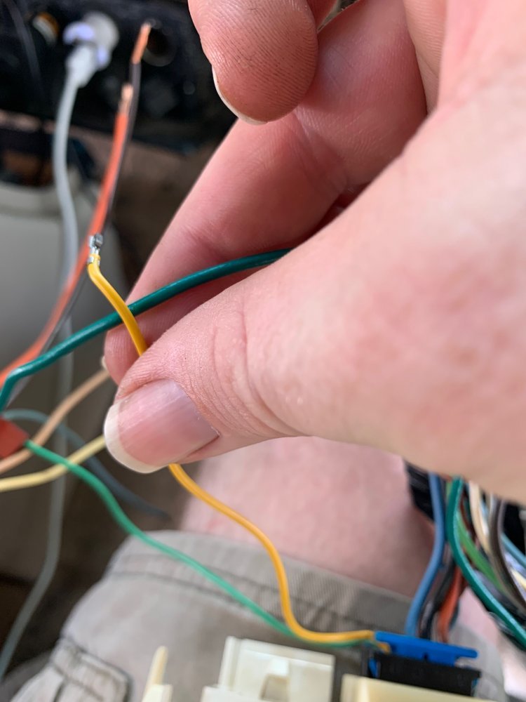

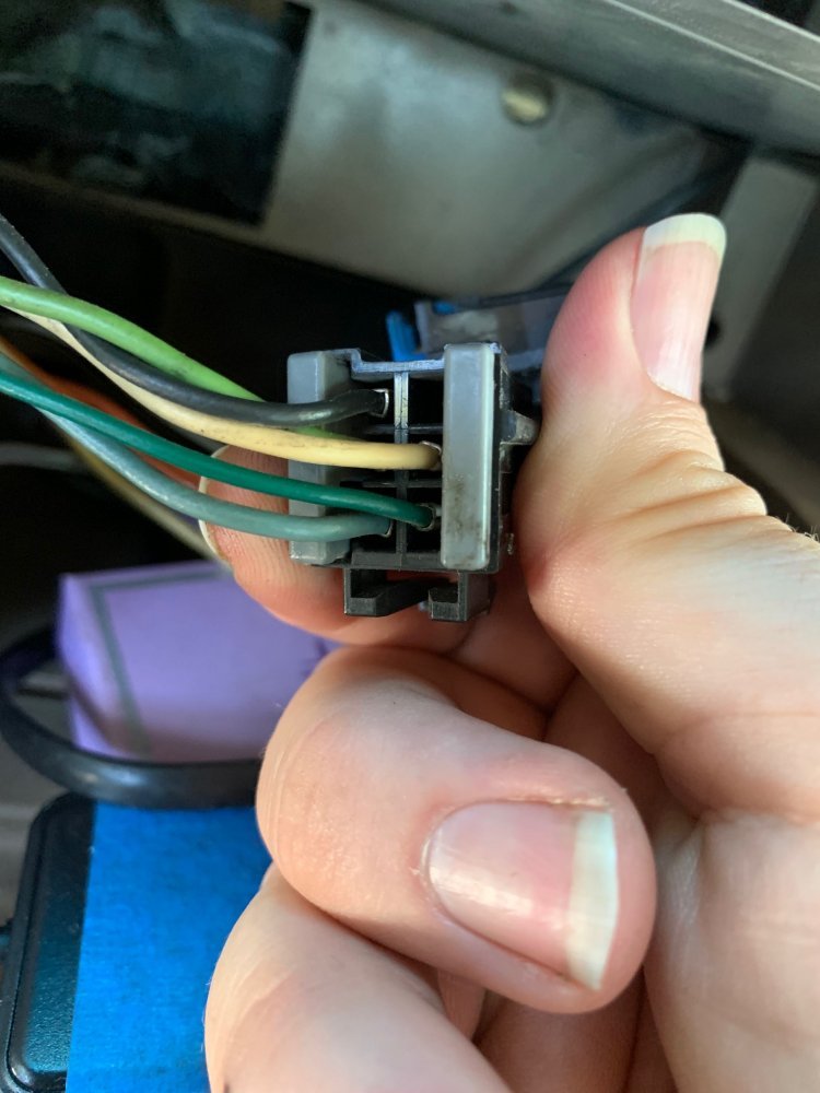

Well guys it was a success! I officially converted my 95 truck from the 15-72267 control to use the 15-72548 control from a 97 truck. went to the Wrench-A-Part yard this morning and found one along with snipping the harness pigtails for it. while looking at the wires on each controller and the harness in my dash, I discovered the diagrams didn't have all the colors right! it took some poking and prodding around with trial and error to get everything working.
I ended up using the blower switch from my 95 controller since I couldn't get any of the fan speeds to work with the junk yard one. also re-used the blower harness from my old controller since I kept the old switch. didn't have to replace any of the dash door motors ether. once I figured out the wires, everything works. even turns off the compressor when you turn the blower off now :)
Here are some photos of the two controllers and of the my truck harness along with the finished product. after soldering all the wires up and heat shrinking everything and installed.
IMG_3330.jpgIMG_3331.jpgIMG_3332.jpgIMG_3333.jpgIMG_3335.jpgIMG_3336.jpgIMG_3337.jpgIMG_3338.jpgIMG_3339.jpgIMG_3340.jpg
Just learned there is a 10 photo limit per post. her are the rest... And for the record, before someone asks lol the connections I made with the wires pushed into pins was just while I was testing and making sure I had the right ones connected. I clipped all of the mess out and soldered everything up nicely then taped over them shown in the second to last photo. Also did not make any cuts or butchering on the dash harness, if I need to replace or do any future repairs, it can be disconnected using the factory plugs :)

the funny part is before I did this. when I touched the knob for the floor / vent / defraust. you would hear a "zippp-thunk" when the mode door moved. now its quiet and changes flawlessly! so does the recirc door. :)
