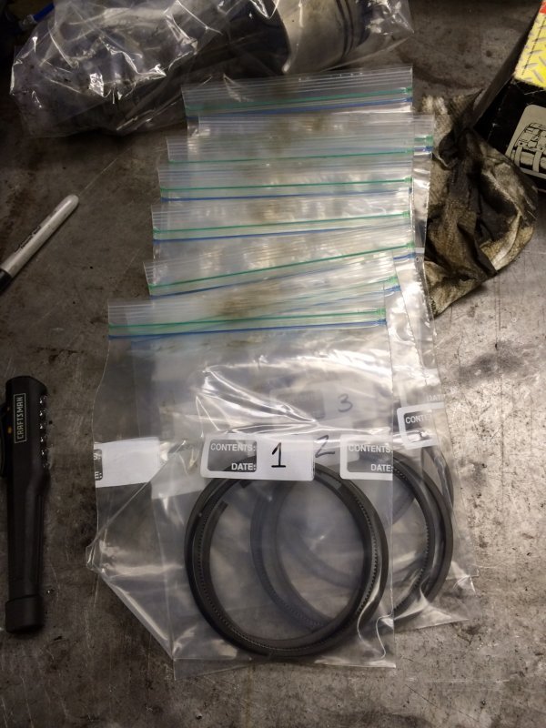

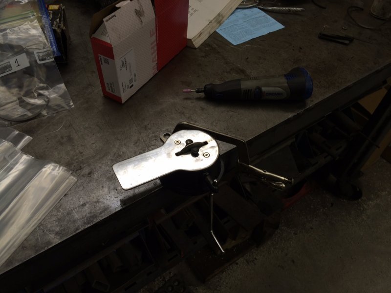

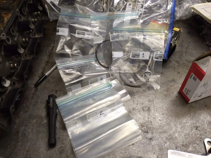

I got the rings filed last night. They're all lined up and bagged per cylinder.
Tonight I'll be doing piston cleanup and some other random tasks. I'm waiting on my thread chases to show up so I can clean the threads in the block before cleaning it and starting assembly. I should have them Wednesday.

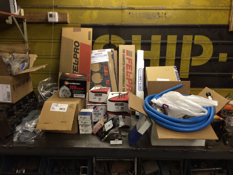

As stuff rolls in it's starting feel like Christmas in here...or maybe Valentine's Day presents for my 'hoe??:DView attachment 44251
That heater hose sure is purdy Nate. :eek: Thats a nice looking pile of parts, but my problem is, as the new parts pile gets heavier, my back pocket feels lighter. In fact, sometimes it gets to feeling like there's nothing there at all. :D
Matt
Matt
I hear you Matt...this engine should have been my diet plan, I've lost a lot of weight so far this year and it's all from my back pocket!!
That's not heater hose, that's the fuel hose that came with my Raptor fuel pump from Leroy! I bought it last fall when I thought I had a fuel leak problem and I never installed it. Now will be the perfect time! Also I did have a fuel leak....the hose clamp I neglected to put back in place on the return line at the pump when I did my lifter repair job. :confused:
Oh and the oil cooler and lines from Leroy also weren't in the pic. Thanks Leroy!

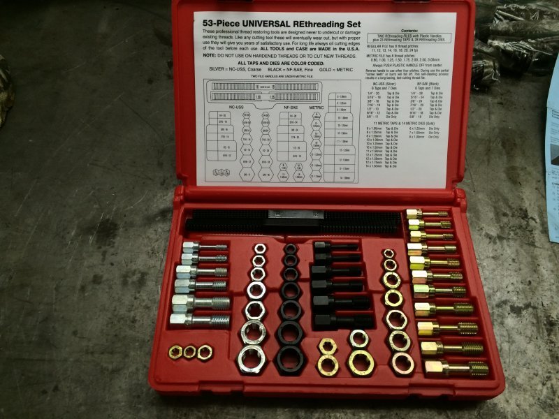

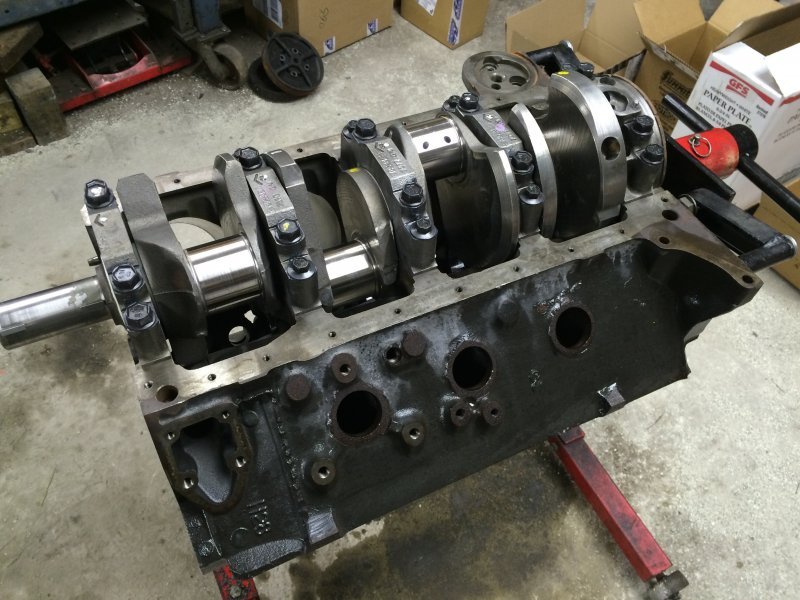

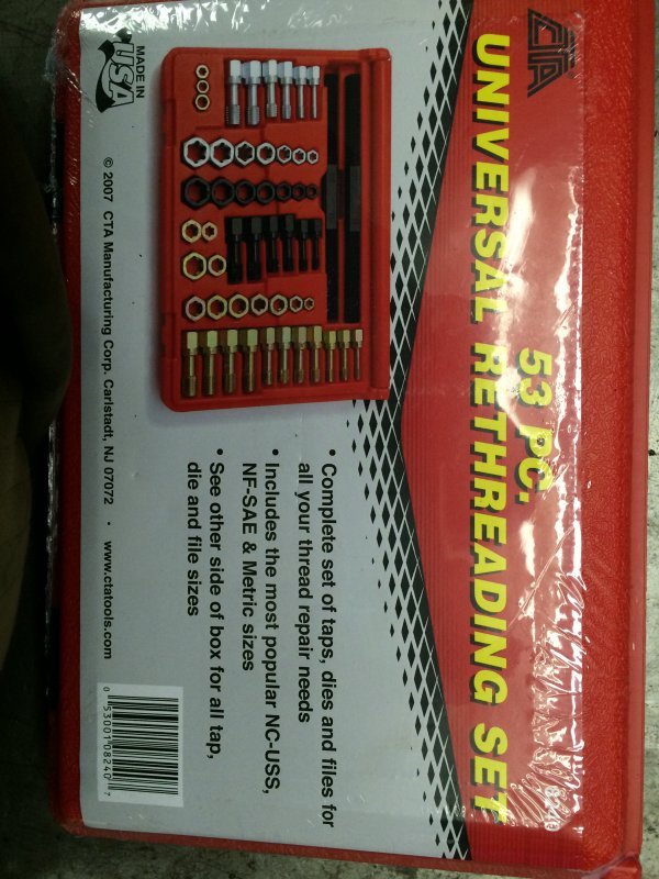

Chased all the bolt holes with my new thread chasing kit. Crankshaft is in with a nice 2-3 thousandths bearing clearance. Tomorrow night piston and rod installation begins. It's going to be an engine again soon! :)

Thanks Matt. Getting new tools is almost as much fun as getting new engine parts. I should have gotten a set like this a long time ago.

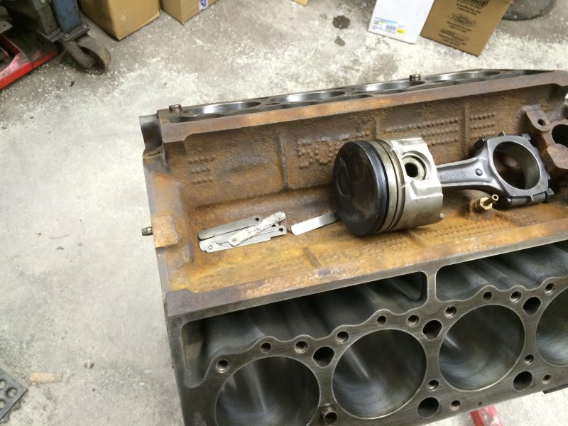

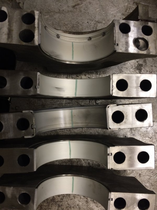

I've been making slow progress lately and I'm calling it a day today, but as it sits right now I've checked rod bearing clearance on all 8 rods (all around .0015 so right on the tight end even after crank polishing) and I have rings and pistons installed for #1 & #2. I should have the short block pretty much done tomorrow. I think I'll be pulling the truck in the barn mid week next week to start disassembly since I nees the studs, rockers, oil pan and other parts off of it to complete assembly. I also need to do all the fuel system upgrades and get the trans rebuilt....so a ways to go still.

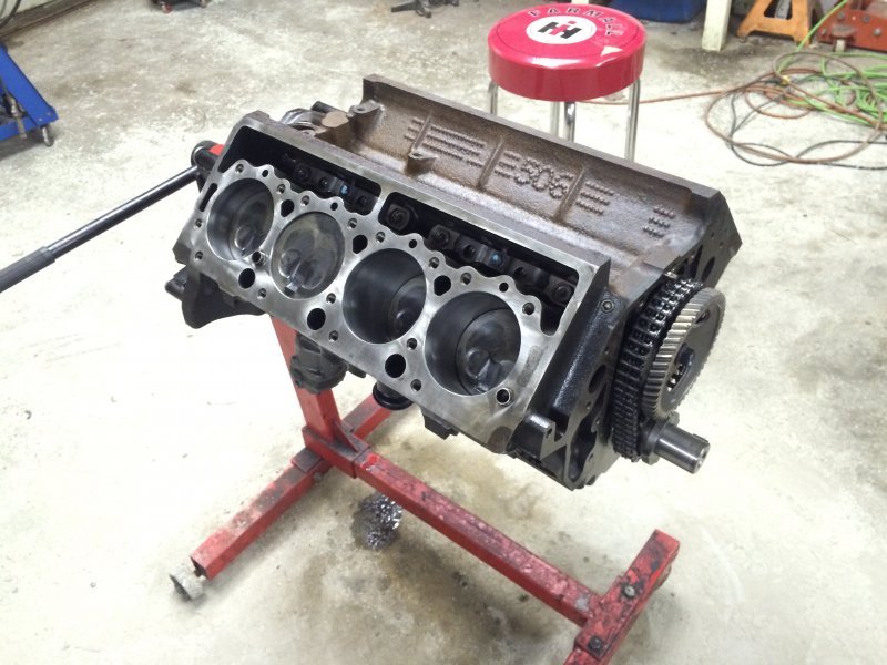

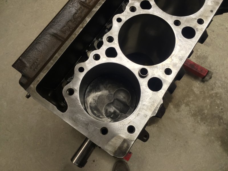

Short block is assembled wirh the exception of coolant and oil plugs - I need to get some more sealants first. Tomorrow will be head assembly. image.jpg
Thanks Matt. I originally wanted to stay true to the heritage of the engine and go with the Alpine Green, but I didn't know how much I'd like that after a while. After looking at a few colors I decided to go with Cast Iron Gray. It will look industrial but go well with the color scheme of the truck.

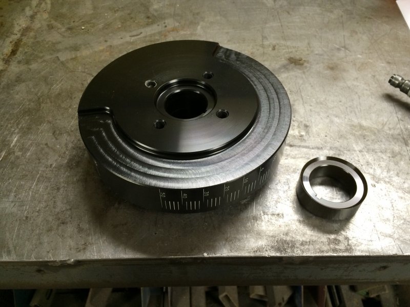

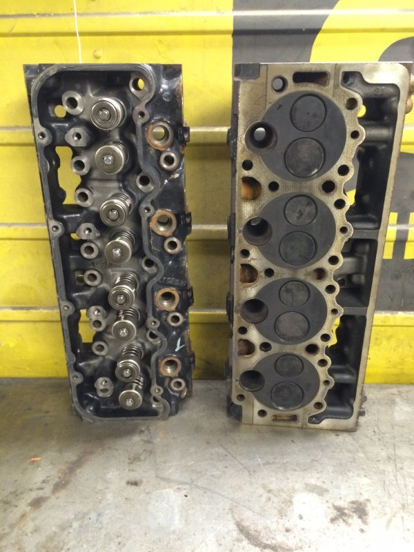

Ok another fun part showed up today!! The Fluid Damper from Leroy...nice and shiny and black, mmmmm. I got the heads assembled too. This is about the last thing I can do without the parts from the old engine so I'm done for now. Tomorrow night I have some chores to take care of then Wednesday night should be pulling the Tahoeimage.jpg image.jpg image.jpg image.jpg in the barn to start disassembly :)
Nothing like pics of shiny new high quality parts! :) So Nate, whats the plan on the precups? I assume your Optimizer came with NA cups, so are you swapping over the diamonds you just put in your other 6.5?
