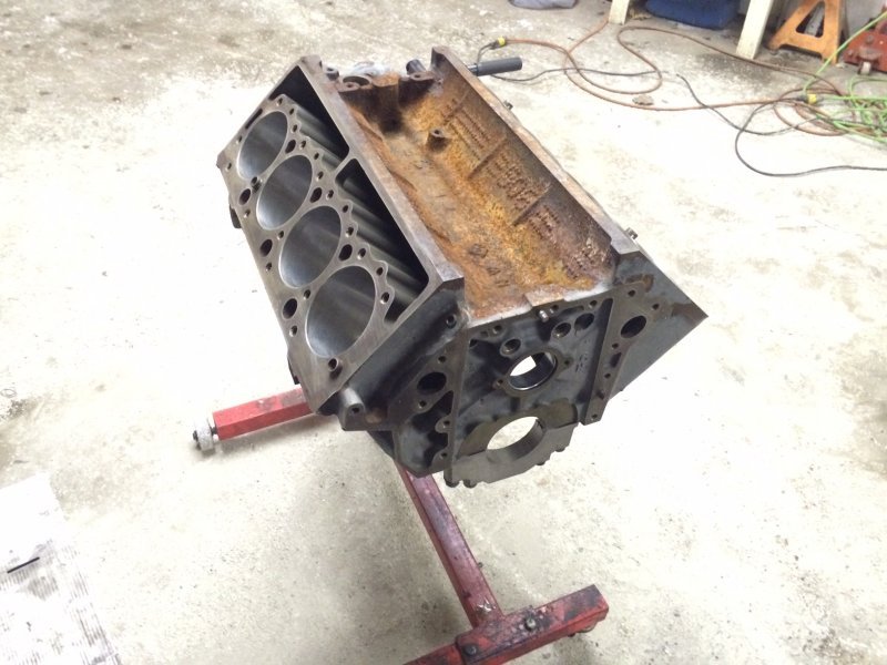

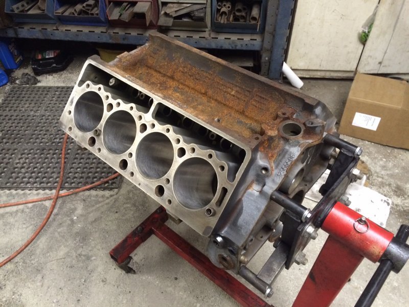

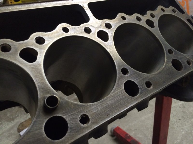

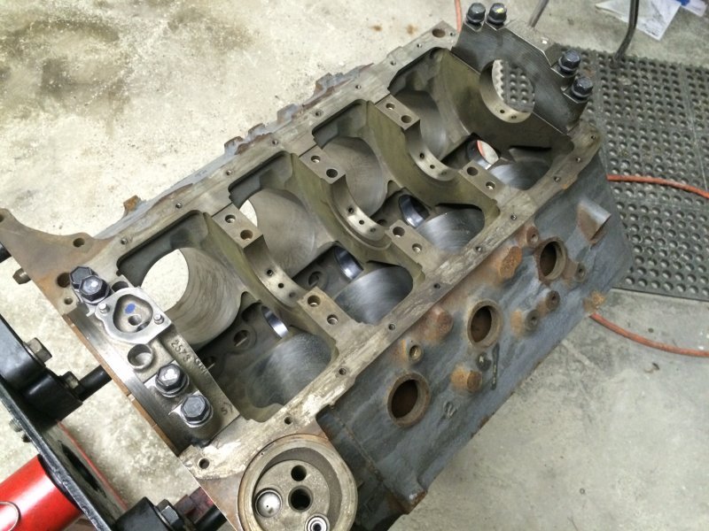

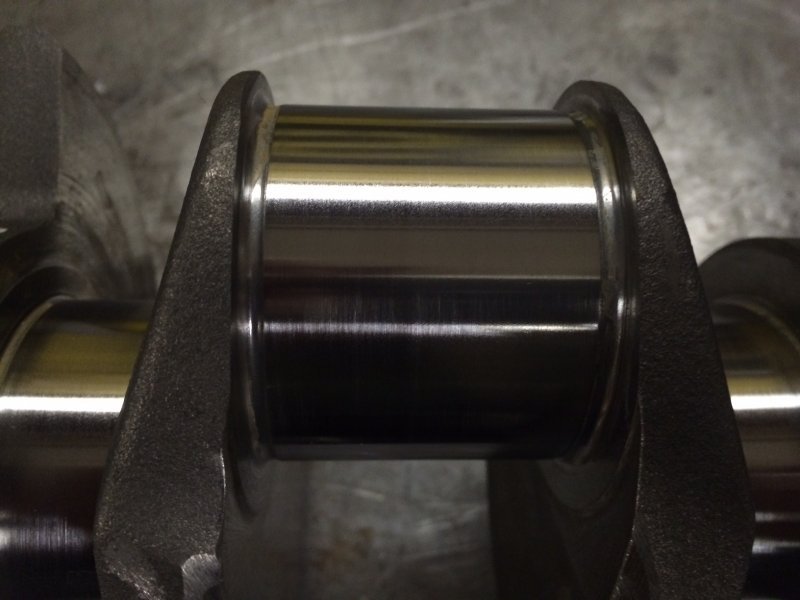

Actually I lied, I do have something to share. Here are pics I took when I got the parts home. I'm disappointed in myself...for some reason I thought that the cleaning operation at the machine shop would take care of the rust in the valley, but unfortunately it did not. If I had known that I would have wire wheeled it before cleaning. So now I'm hand wire brushing it to clean it, but not throw dust everywhere. It hasn't been that bad actually, and I've been vacuuming the rust off so it's not getting anywhere it shouldn't, but it's still a bummer. I don't have any pics post wire brush yet, I'll post that tonight.
Note the cam bearings that aren't copper colored!!:DPM BLOCK1.jpg PM BLOCK2.jpg PM BLOCK3.jpg PM BLOCK4.jpg PM BLOCK5.jpg
I hope that's just a stain on the main web and not what it looks like.....o_O
If they did caustic soda bath on the block with the cam bearings in place, you should consider replacing the cam bearings.
Don't forget the clean and chase the blind holes with a bottoming tap. Run each hole a couple times until the tap comes out (mostly) clean. Dipping the block doesn't clean that stuff out....
