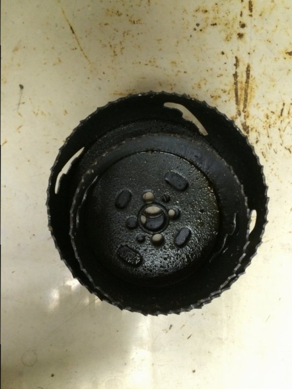

I plan on using a standard 3" silicone elbow after the IC instead of the 3"-4" elbow I am using right now. This will gain me an extra inch to move the IC over which should allow me drop the IC down enough to get it down and away from the hood. My original thought with the 4" upper intake was that it allowed a more consistent or gradual flow path from the IC outlet to the individual intake runners. I think that might be true if this was a naturally aspirated application, but since this is forced induction I think it becomes a moot point. Now if I could find a 3"-4" cobra-head coupler I might be able to accomplish this goal without redoing my upper intake. If you find one please share it with me because it would save me some fab work potentially.
As far as oil change durations, I absolutely hope to extend them further in the future, I'm just trying to keep flushing the engine while it's still breaking in by doing more frequent oil and filter changes. It will be interesting to see how the oil analysis results turn out during my next couple changes. I think when I do the driver side header I will also do a remote oil filter setup so access to the filter doesn't constrict my header design.
Going from the 4" to 3" will get you only half an inch.
I'm going to offset the tube in the opening so the outside opposite the IC is at the same location so that I will gain the full 1" reduction in diameter. Here's a picture of 2 hole saws to illustrate what I'm trying to say. image.jpeg
