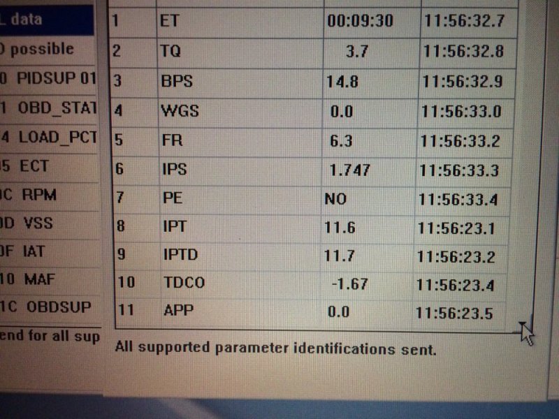

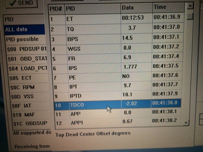

Second I checked the timing. Below are the screen shots of the screen before and after TDCO relearn. The -2.02 is where I had it set the last time I did it. After the relearn I'm at -1.67. I'm just going to leave the pump where it is because based on everything I've read that should indicate that I have the pump in a good place. Also Pump Timing and Desired Pump Timing are closer to each other now, so I think that's further evidence that I'm doing ok.
Initial scan:

After TDCO Relearn. FYI, I was going to try doing the TDCO Relearn with Car Code, but I was having laptop issues, so I just used the KOKO procedure and verified the results with Car Code later.
Initial scan:
1.67 is where my 6.5 likes to be too!
