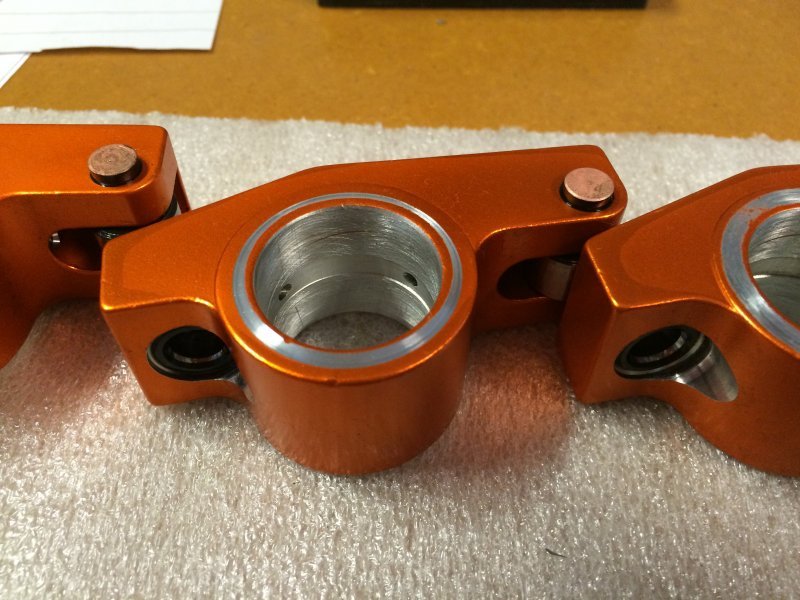

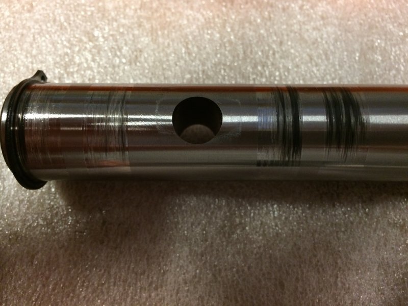

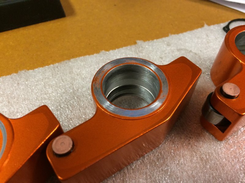

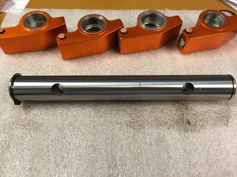

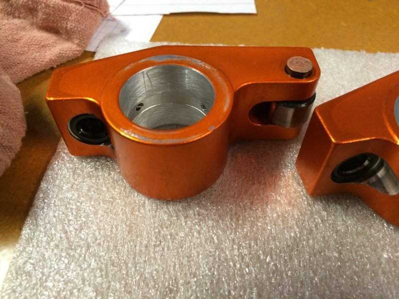

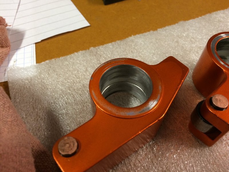

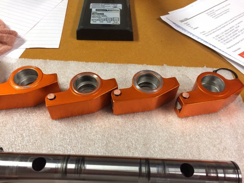

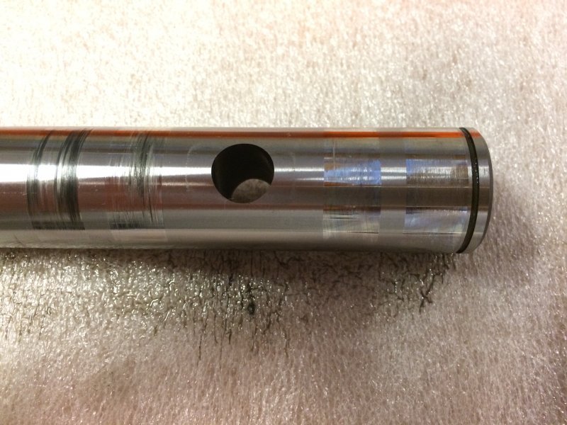

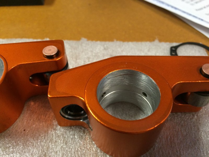

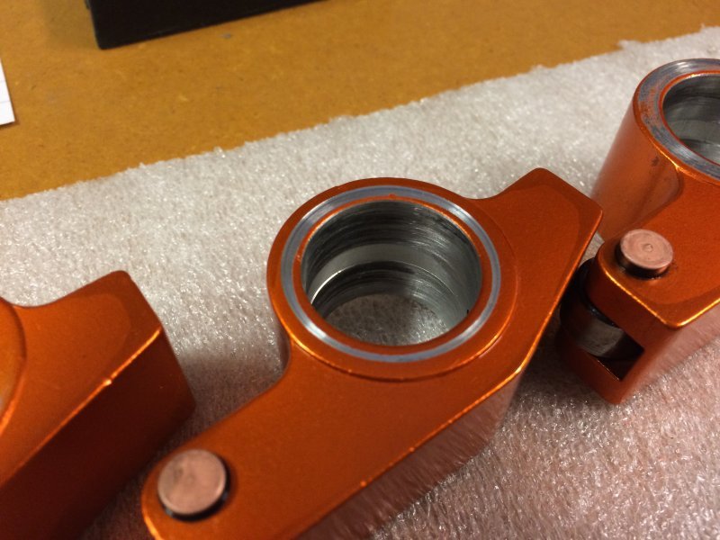

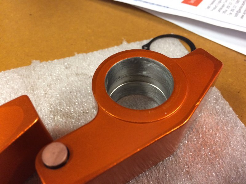

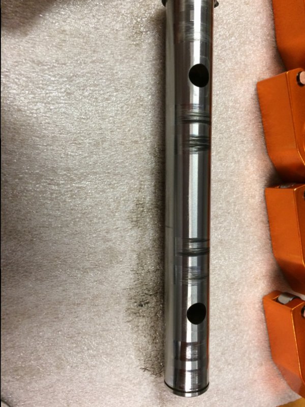

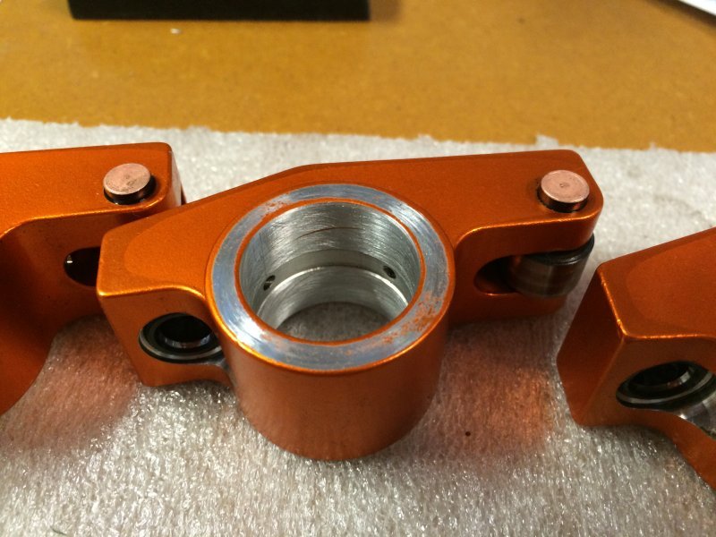

When I cleaned my rocker arms so I could check pushrod length and valve-to-piston clearance I found that the shafts were seriously galled from the coolant in my oil! I contacted Harland Sharp directly and then sent my rockers to them for inspection. They agreed that the problem was contaminated oil and therefore it wasn't a warranty problem. Interestingly, the aluminum rocker arms themselves were ok, but the steel shafts were damaged. They told me that I could simply flip the shafts over and be ok or they could replace the shafts for $100. Since they had the rockers already I figured it was smart money to have the shafts replaced. Harland Sharp was very good to deal with, they're just a family business and very passionate about their products. It was a really pleasant experience dealing with them.
After my situation was handled to my satisfaction I contacted Leroy to let him know my experience since he is the vendor for the product. Since he had just installed his rockers the way they felt was fresh in his mind and when he looked at the side wear on my rocker bodies it got him to thinking further. His rockers were sealed under his valve covers so he couldn't easily inspect further, so he asked me to look at my rockers. He suspected that the middle rockers were tight to each other. I installed mine without pushrods and this really highlighted the problem....they were very tight! He has a home remedy that will take care of the problem, but I have a little time so I'm going to see what HS's solution to the problem is.
Here are some pics of my initial damage. I guess next time I have coolant in my oil (which hopefully is NEVER) I will not drive with that condition going on if there is anything in the engine that I hope to use again. The coolant also took out my turbo - I noticed some marks from the compressor wheel rubbing the housing so I felt the shaft and sure enough it was moving in there. I disassembled it hoping I could just put new bearings in it, but the shaft is scored. Rather than just do a cartridge I'm just getting a whole new turbo since it doesn't cost that much more. I am keeping the old turbo as I can use that to play with different wheels some day I figure :D. Of course the turbo that I bought in December has gone up about $100 on Ebay :mad:. I found it on the interwebs from I think the same vendor, but after I purchased it they told me it was out of stock....I suspect that they realized it was at the old sell price on their website, but who knows. So instead I am buying a JM Turbo off of Ebay.....it supposedly has the same specs so we'll see what it looks like when I receive it.
Here are some rocker carnage pics.

More pics. The last pic shows the top of the shaft, which is the side of the shaft that doesn't experience load and therefore doesn't wear.HS shaft overall.jpg HS shaft R end.jpg HS shaft top.jpg
