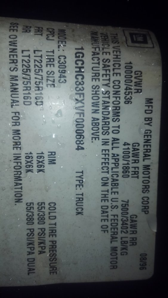

Yes it does. the HD version also has a larger reservoir it's noticeably different. same bolt pattern but has larger inside piston bore. I noticed yout vin number starts 1GCHC where mine is 1GCGC I would need to find a vin decoder but might be an indication of HD.
Look in your glove box for the RPO codes. there will be a bunch of codes on a sticker. look for these codes.
JB3 : BRAKE, POWER, DISC/DRUM, 4600 LBS
JB5 : BRAKE, POWER, DISC/DRUM, 6400 LBS
JB6 : BRAKE, POWER, DISC, DRUM 7200 LBS
JB7 : BRAKE, POWER, DISC, DRUM 8400 L85
JB8 : BRAKE, POWER, DISC, DRUM 10000 LBS
JC4 : BRAKE, POWER, DISC, DRUM 5600 LBS
JC5 : BRAKE, VAC POWER, 4-WHEEL DISC, 7200 LBS
JC7 : BRAKE, POWER, DISC/DRUM, 12000 LBS
JCB : BRAKE, POWER, DISC/DISC, 20000 LBS
JD3 : BRAKE, HYD POWER, DISC/DRUM
JD5 : BRAKE, DUAL POWER, DISC/DRUM, 6400 LBS
JD6 : BRAKE, HYD POWER, DISC/DRUM, 7200 LBS
JD7 : BRAKE, HYD POWER, DISC/DRUM, 8400 LBS
iirc the code JC7 is for HD braking system on these rigs. I think mine is JB8 which is the normal front brakes with HD rear brakes. I would need to verify this info though.

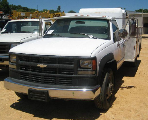

Ok.. my front end isn't like the one in pic it has the other kind of headlights..and isn't that tall. So I'd assume mine is one of the ones that just got the extra options..
But since those options include brakes and suspension. We're probably still on the right track.. .
