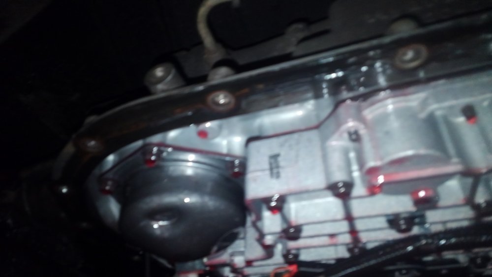

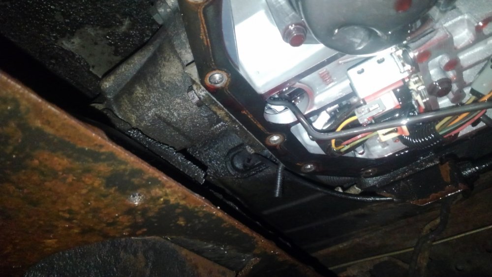

That gasket is stuck on. It was put on with gasket maker.. but leaked on bottom side against the pan. If I clean the pan good can I just put new rubber fel-pro gasket on the pan and put it together. Or do I have to fight this thing of of the tranny

Also the bolt holes in the tranny pan are recessed in ( towards the side that goes against the tranny) anyone have a simple way to Flatten them back out.. keep in mind I I don't own a vice or have special tools.. just basic mechanics tools.. I had thought about putting it face down on a flat piece of steel I have and find something to put over the whole from other side and hit it with a hammer.. maybe put a stak of quarters on it..
And to the gasket that is stuck on the tranny, I would recommend scraping it off and cleaning up both surfaces well. normally gaskets don;t need any goop to make a decent seal here, but since the pan needs some TLC. you need to get a good gasket and use a thin layer of permatex #2. allow it to get tacky before installing. and don't over tighten the bolts causing the gasket to squish. that alone will cause a leak.
The gasket that was stuck to the bottom of the tranny was one of the reusable ones. So I cleaned it up really good on the bottom side. And cleaned the pan lip excessively good. I used the method @ak diesel driver recommended with a piece of wood to flatten the holes. And I put the pan back on with that gasket still stuck to the tranny. Refilled it with fluid and it has not dripped one little bit since. But I'm still going to keep an eye on it for a while.
We learned a new hack for cleaning the lip on a pan when it has a lot of permatex or whatever stuck to it. Obviously scraping is good you can with a razor or paint scraper etc. But for all the little s*** that's left on it after that, take a regular kitchen sponge like a Scotch-Brite sponge that has the green scrubby side on the back... Get it damp with hot water, and use the sum fast orange or gojo hand cleaner... Use that to scrub the lip of the pan. Obviously don't overdo it but if you take your time with it it takes the s*** right off and give you a nice clean surface.
