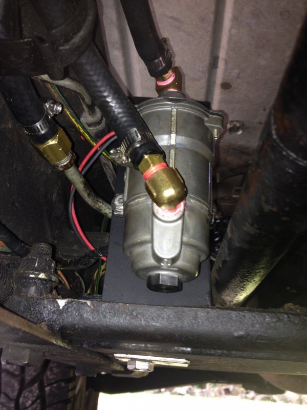

Question For Members:
Leroy's Diesel Walbro pump goes in next weekend. Crawled under the trucvk and took a close look with pump in hand. Hookm up to the front hard line to the top of the pump looks pretty simple and there is plenty of play to move it around. Rear hard pines looks a little trickier with the barb fitting. I was think of looping a section of hose around the back of the pump with a 90 and barb going into the base of the pump with the barb pointing foward. Any Suggestions?
Some will benefit by using a 90* barb fitting or a street ell and the straight barb. ALSO FYI Im stocking some very high quality 3/8" fuel hose now. Anyone interested let me know. Will go on site soon.
Finally got the Walbro lift pump installed. Fabricated a support bracket out of 1/4" plate and mounted it 002.JPG on the cross member. Bracket is offset to the front of the cross member, and everything is safely tucked away and protected from road debris by the bracket or cross member.

2 days driving to work with the Walbro pump, and so far so good. The engine seems to be running smoother at highway speeds and pulling a little stronger and a little less rpm drop when I hit the over passes.
