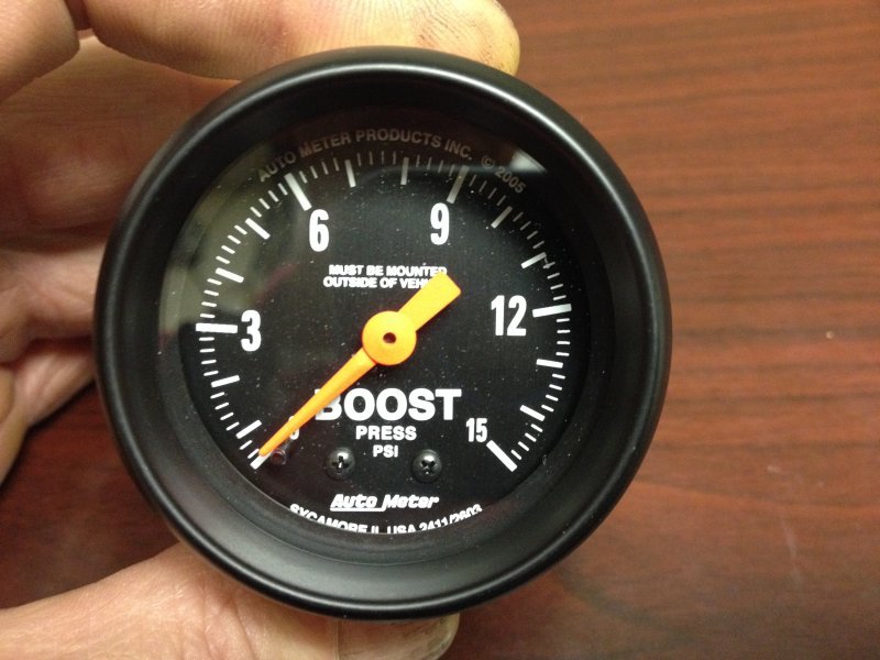

Two gauges on order and one of them is the Autometer 0-15 printed to say "BOOST" Looking forward to getting it installed so I can see what the boost is like while driving. I'll post a picture of the gauge when it arrives.

Boost gauge just arrived from Autometer with the custom face. This is an Autometer Z-Series gauge013.JPG
Dont mount that in the cab :) its says to mount outside vehicle only. Must have a PMD inside it? :)

Pretty sharp eye Burning Oil. The warning is an oops on my part. The guts of the gauge are a simple mechanical pressure gauge, but the standard product was intended to be a fuel pressure gauge. The warning is so people don't bring a fuel line inside a vehicle, and I think the rep I talked to at Autometer told me fuel in the cab was also NHRA rules violation.
When I placed the order, I forgot to have them delete the warning in addition to changing the label. I was kind of happy pretending the warning wasn't there and ignoring it, but now .........
First, the custom shop made the gauge exactly like I ordered. Then, diligent members of this forum do there best to protect me from myself. Man, I'm starting to think dumb and ignorant, BUT happy wasn't all that bad.
