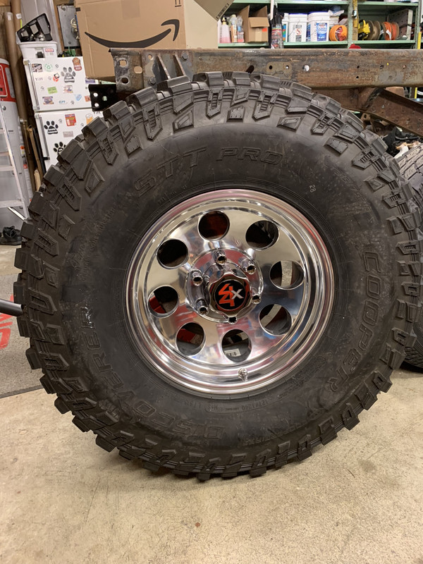

Then spent some time with the tire spoons scooping these bad boys on the wheels. I decided to get the Cooper Discoverer STT Pro in 315/75R16. Read a decent amount and they seem to have good reviews.
New tires VS old tires. The Mickey Thompson MTZs served me well. I managed to get about 55k miles out of them. I probably would have ran them a second time but I've started growing fond of coopers after running the Discoverer ST Maxx on the dually.
And, yes, they are on the truck. It was 10PM when I finished, so you'll have to wait for daylight picts :lol:

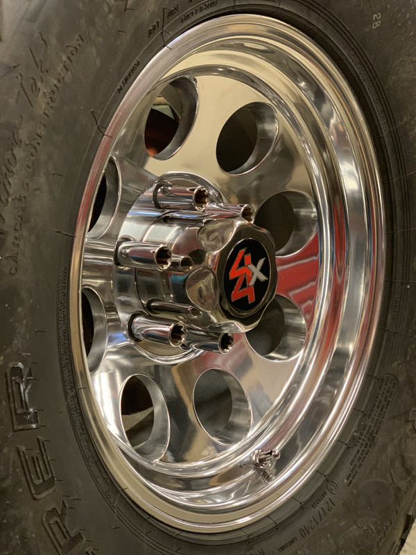

You might be wondering what the plan is, since I ditched the PY0s... well, I'm going back to the truck's 6-lug roots. I picked up a full set of Procomp 069 wheels in 16x8 polished... Took me forever to pick the wheels I wanted... with the offset, size, and hole to diameter ratio I liked. Mounted them up in the garage and used balancing media
Finished product with my stainless caps and socket lugs.

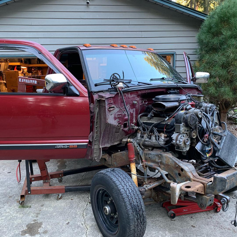

Got the front clip blown off.
Then got everything disconnected from the cab and pulled the seats out.
Then used the engine hoist and the help of a friend to remove the cab and set it aside. (yes the receiver is in the back of the cab to balance it out!)
First time the cab and bed have ever been off this truck.

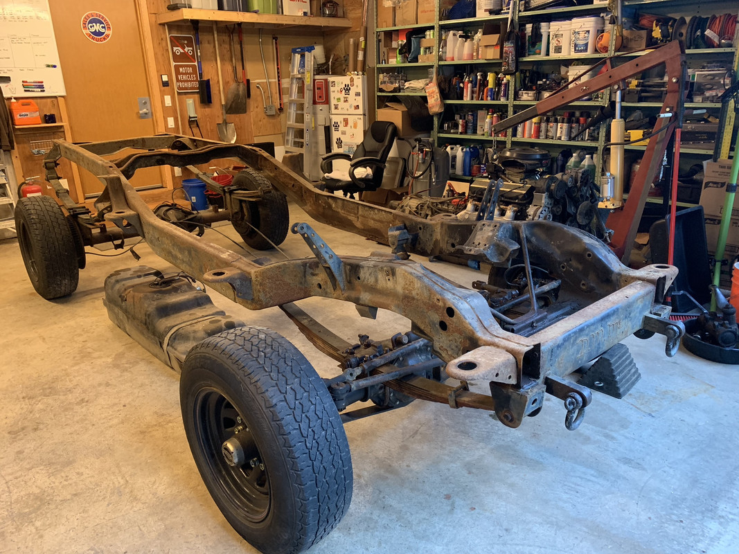

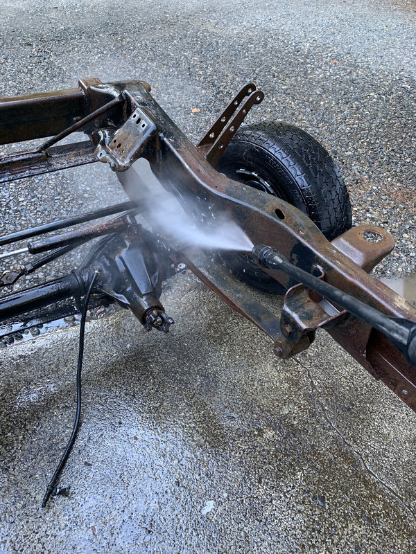

Started with a good pressure washing of the frame. Need to get all the gunk off it.

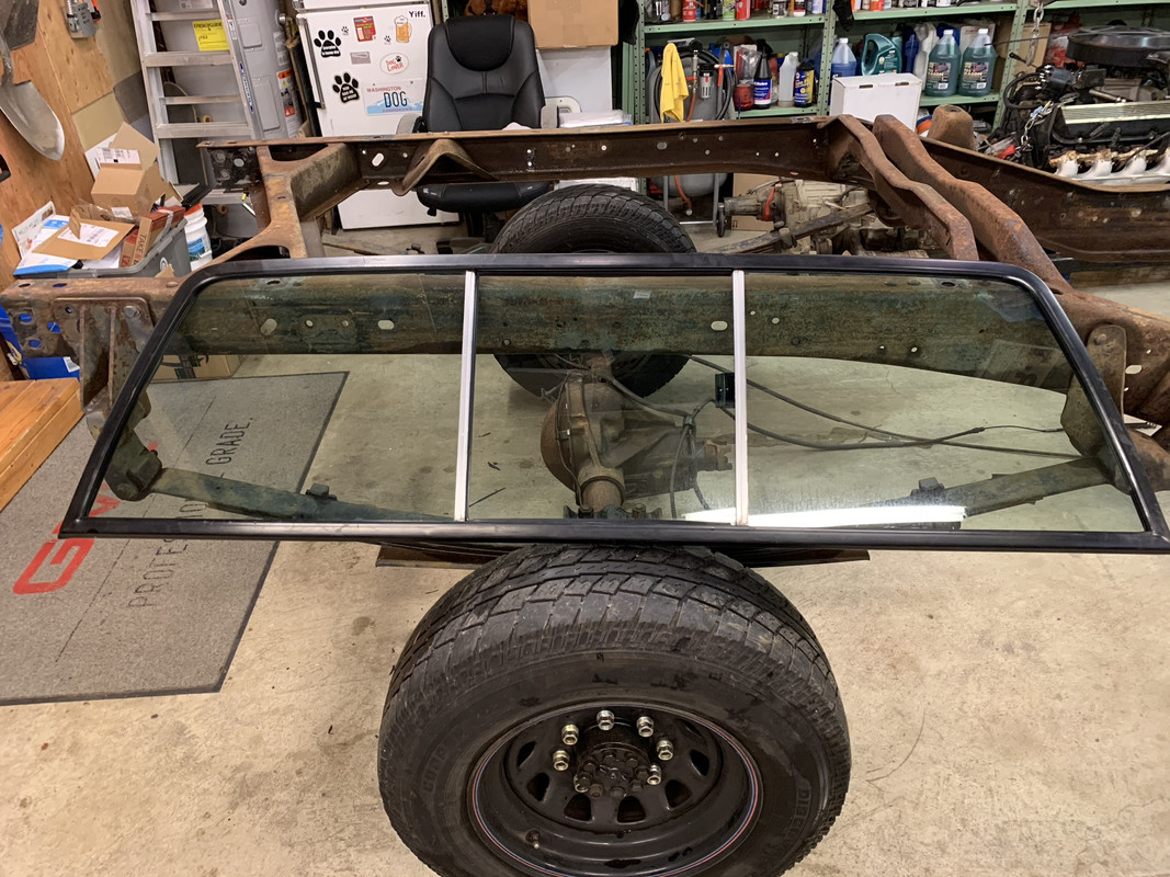

I also made a couple junkyard trips... Found a factory 3-piece slider window in good shape.

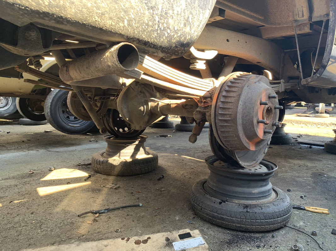

And picked up the new rear axle - 14SF from a 95 K2500, 6 Lug, 3.73s (will be re-geared) and a G80.
I've had a few people ask why I'm going from 8-lug back to 6-lug... Well, the primary reason is the 8-lug Dana 44 hubs set the wheels out 1-1/4" wider on each side, so 2.5" of more track width. Combined with the backspace offerings of 8-lug based wheels, I'm sitting at 4-5" wider up front, which honestly I didn't care for. The only wheel I could find that kept me where I wanted was the PY0s I had previously, and they are just simply too narrow and the ONLY option that kept the tires where I wanted them. So back to 6-lug I go. I'm not really towing with this, wont really be wheeling the crap out of it, etc. so the difference between the 14FF and 14SF is negligible IMO. Plus, this wheel/tire combo with these caps is just simply bitchin' IMO.

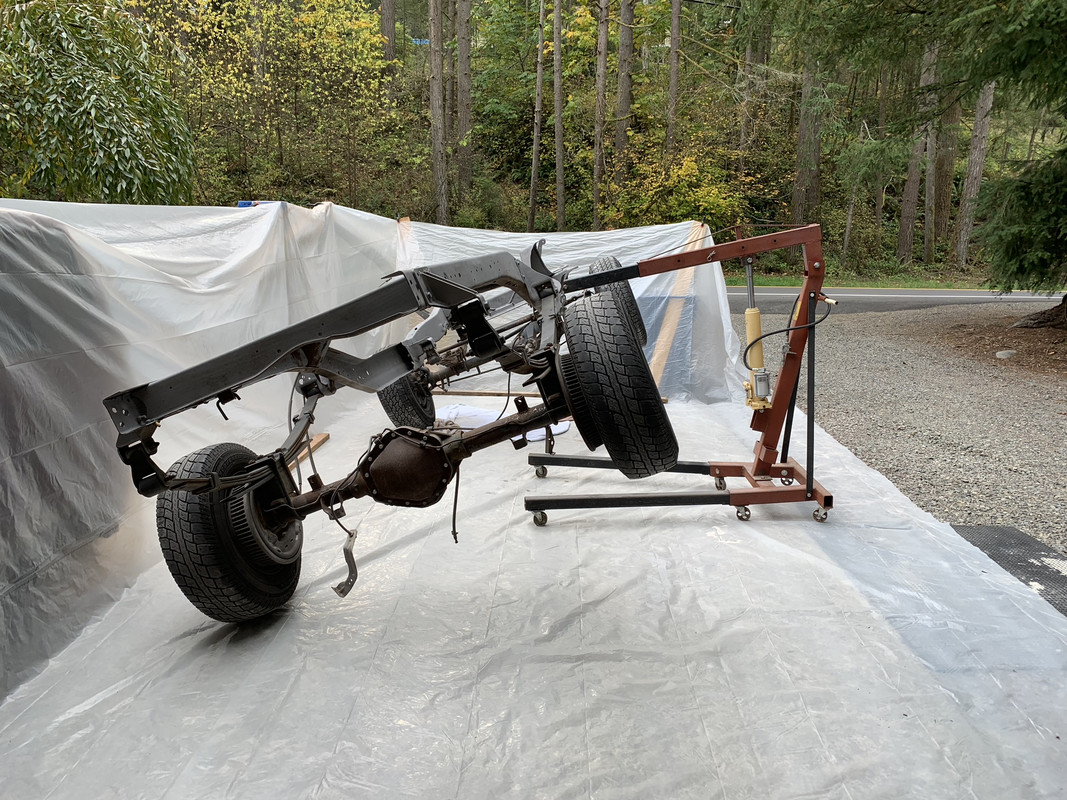

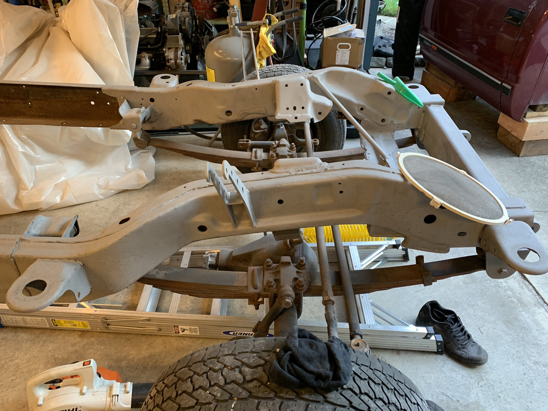

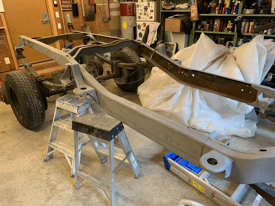

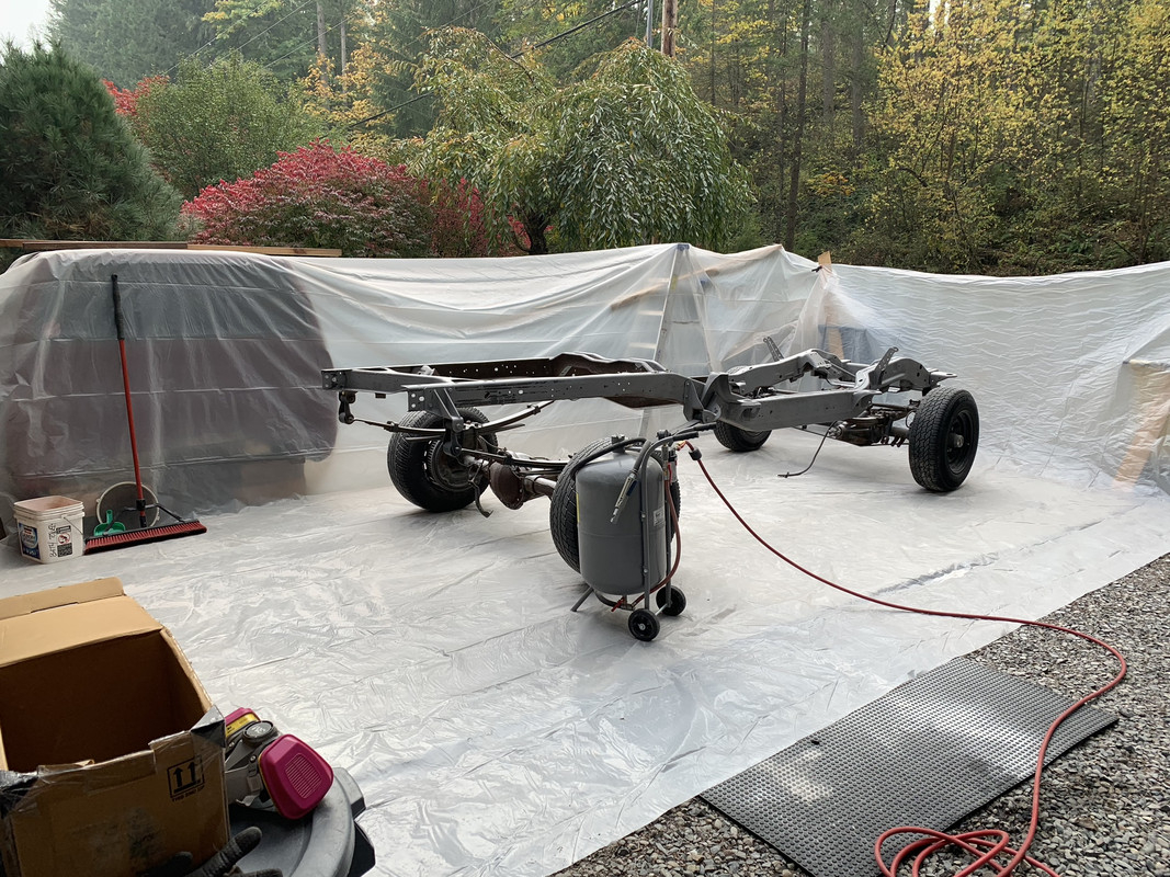

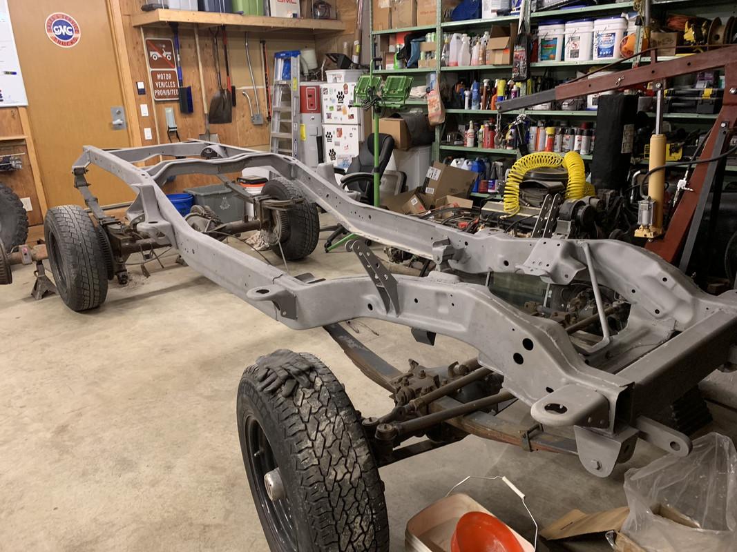

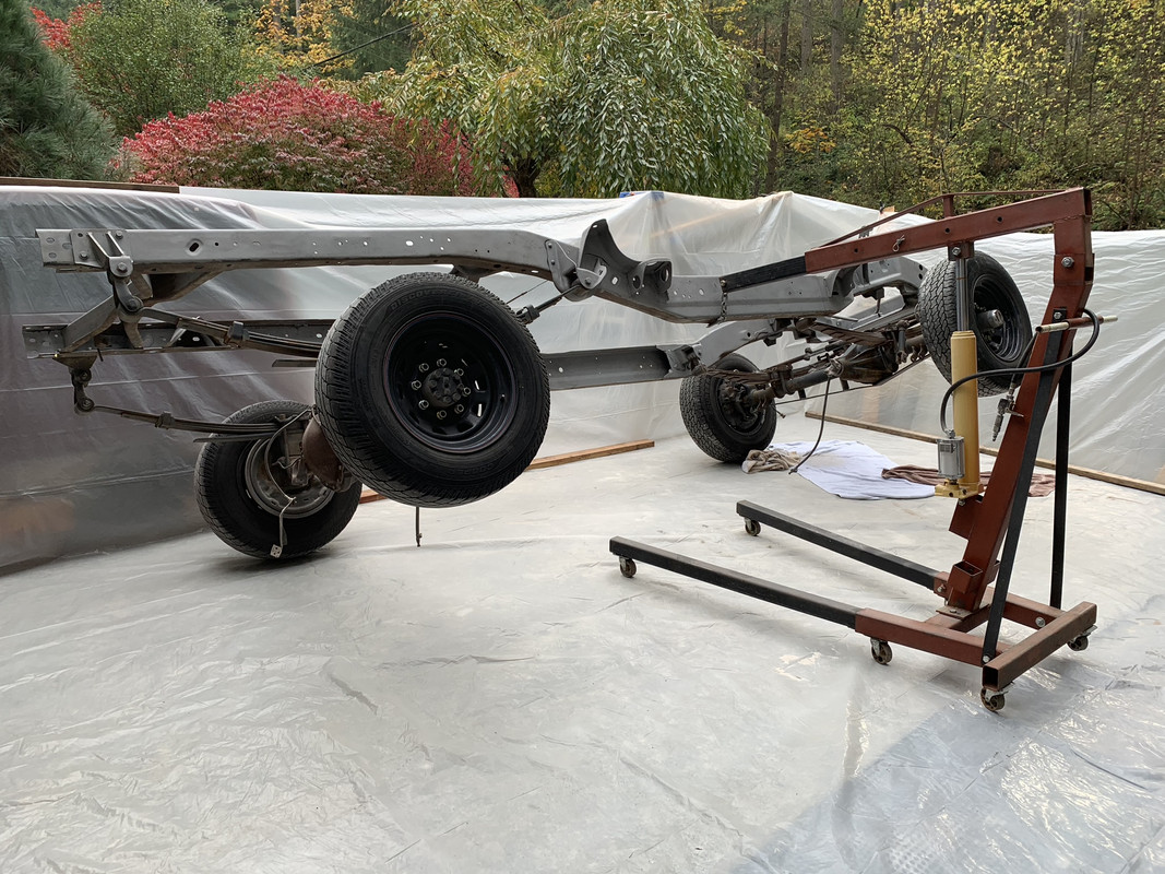

Once I was done screwing around admiring my tires, I spent 3 different sessions in the driveway blasting my frame with glass bead. It was dusty, messy, annoying, yet oddly satisfying.
Day 1 - Engine cradle and outside
Day 2 - inside and crossmembers
Day 3 - Had to lift to get the underside!
