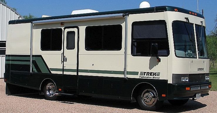

I've listed a lot of information on earlier posts about these subjects but can't find the post at this minute. But I've included a picture of the motorhome.
