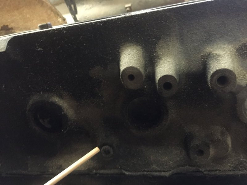

What about removing the block drain plugs ? Do one at a time and see if one side comes out black .
Yes , one on each side of the block right by the engine mounts .
Aka freeze plugs or core plugs.
Yeah, those I am well aware of. I was wondering when the hell GM put pipe plugs in the block waterjackets to drain the block with, like on my old '72 Dodge 360 c.i. Adventure Sport Pickup. Sure as hell would make life simpler for little things like changing heads or a water pump.
My 599 block has them, I was going to put in petcocks to allow draining. You can't on the pass. side, starter is in the way, so I didn't bother.
