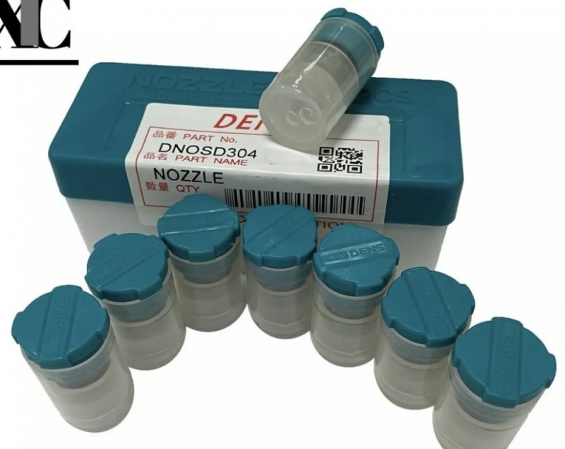

Thanks guys for the replies.These are what I found on eBay.Shows denso on the blue caps and are going pretty cheap.Probably cheap knockoffs as they are only selling for something like $70 for all eight.Just figured I’d let you guys have a look.Thanks for all responses.

Like MOOG, Denso has suffered from a bunch of counterfeit parts on eBay and Amazon:
