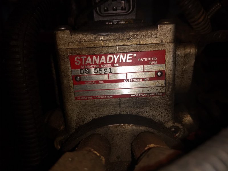

6.2 6.5 td swap
If that's all you know about it don't expect alot for it. Could be the original IP with 230k on it. Got any numbers off the pump?

Check and see if there is a sticker on the pump with a date on it. Mine has a date on the pump from when it was refurbished or replaced, I can’t remember which one right now.

can I use 6.2 IP on 6.5 turbo?
Yes you can. You will want to turn the fuel screw up on it though. It will Bolt up just like the 6.5 IP. If you are using the gm turbo then it will work fine until you decide to upgrade the pump or turbo.
Yes a 6.2 ip will work on 6.5.
But you need to determine what power level you need and make sure the ip you get will support it. 90%+ of them will do fine up to 225hp/475 torque.
Talk to either Leroy or Chris two of the sponsors here about what you want because both of them have access to suppliers for pumps
