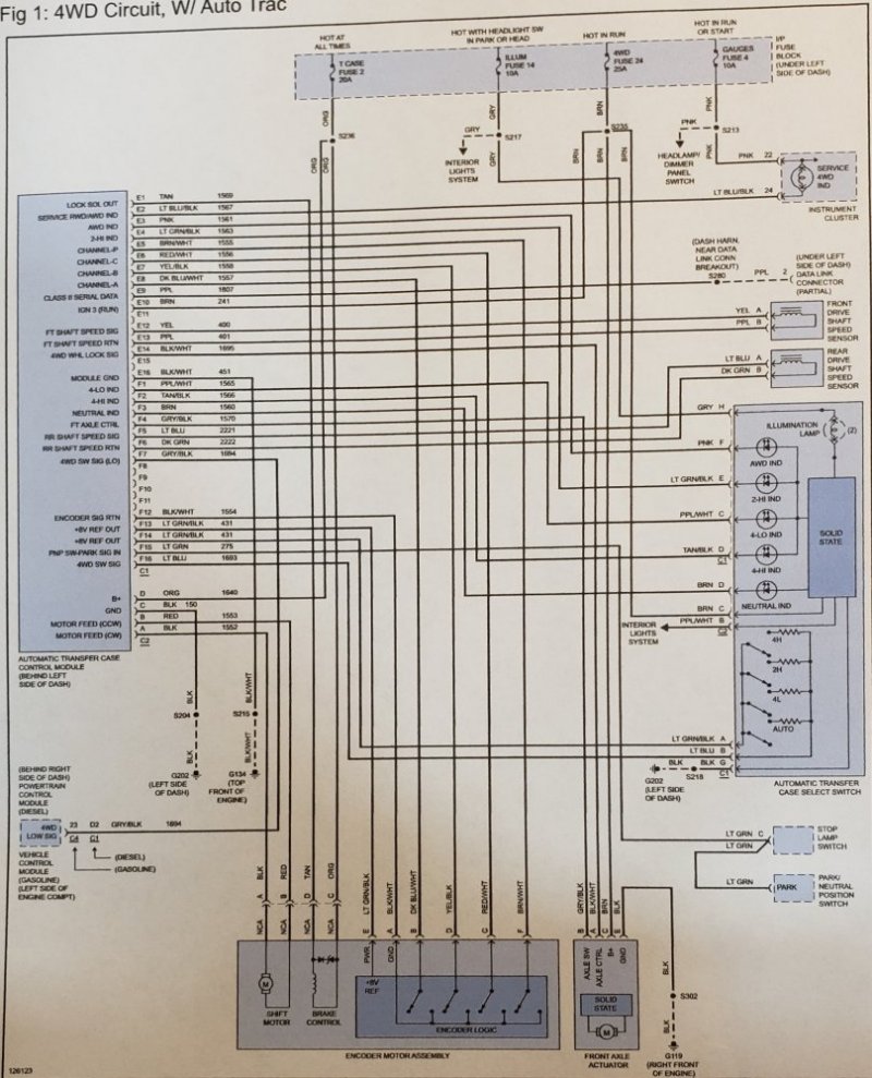

Let me rephrase that. I think the other half of that circuit gets energized with the 8V source when the 4LO switch is actuated, letting that 8V go through the closed switch and to the coil that energizes the relay and closes its contacts to provide a high amp flow 12V to the Actuator Motor to give you 4LO. At least that's what makes sense without diving into the manuals wiring diagrams, which I can't do since I'm currently at work to 10 tonight.

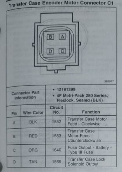

Well went out an did more tests and concluded I need a new tester as the pins are too short on what I’ve got. No success at the plug to the encoder motor.
Got under the truck in the front with help pushing buttons above and nothing happening at the actuator. Pull the actuator and it is stuck in the 4WD lock position. Did some tests at the plug with a test light and I’ve got power there using the ground in the plug. It’s not switching off to the other leads that move the actuator.
Got the replacement actuator and confirmed it’s working when plugged into the harness. So much fun laying on cardboard and doing this in -9F temps. Old actuator packaged up for warranty return.

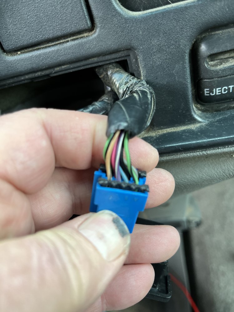

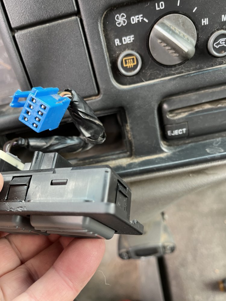

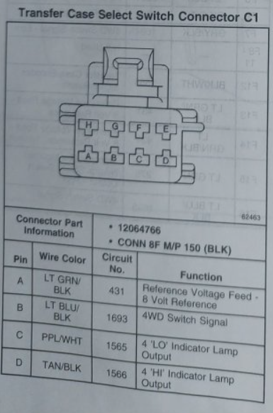

Alright doing some detailed testing starting with Transfer Case Connector Switch C1:

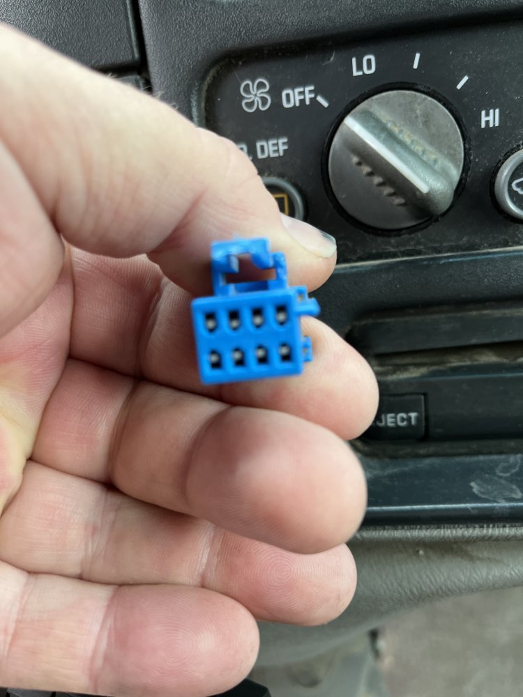

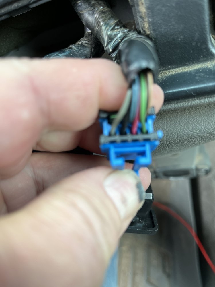

I believe this connector attaches to the switch buttons at the dash. The # of pins is an exact match and shape, but the color coding of the wires does not match. For example, the G (ground) pin has a Red wire, when it says Black above. The F pin has the black wire.
I tested with the plug off and the only combo I got voltage for was G to A at 8.0v. B, E, H got 0.1v; C, D, F got 0.0v.

1. A to B in 4 Lo got me voltage Fluctuating from 2V to 6+V when it should be full battery voltage.
2. Terminal plus Ground to under dash got 8.0v in 2 Hi when it should be battery voltage and 8.0v in 4 Lo when it should be 0 or near Zero. Obviously, this is problem.

1. Select 4WD low, test voltage backprobed at the transfer case motor drive circuits, C1 terminal A to terminal B. Should be battery voltage for as long as the 4WD Low indicator is flashing.
I did this test several times with the same result. Any idea what could be causing the incorrect and fluctuating voltage here?
But A to G (ground) worked perfectly.
B is circuit 1693 which comes from the Transfer Case Control Module to the switch:
