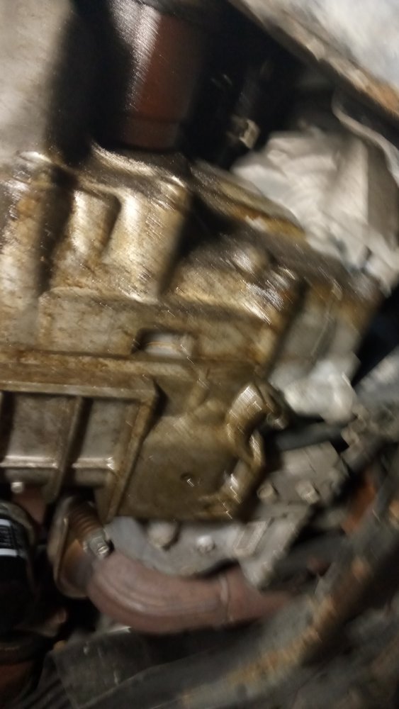

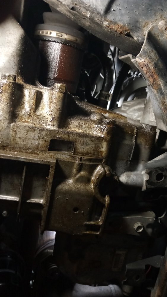

This is a picture of the wet spot on the left side.
That's all the farther I got today.
I haven't figured out where the oil is coming from yet.
Broke a piece of plastic trying to get one of the 2 M6x1 screws out of a C clip.
