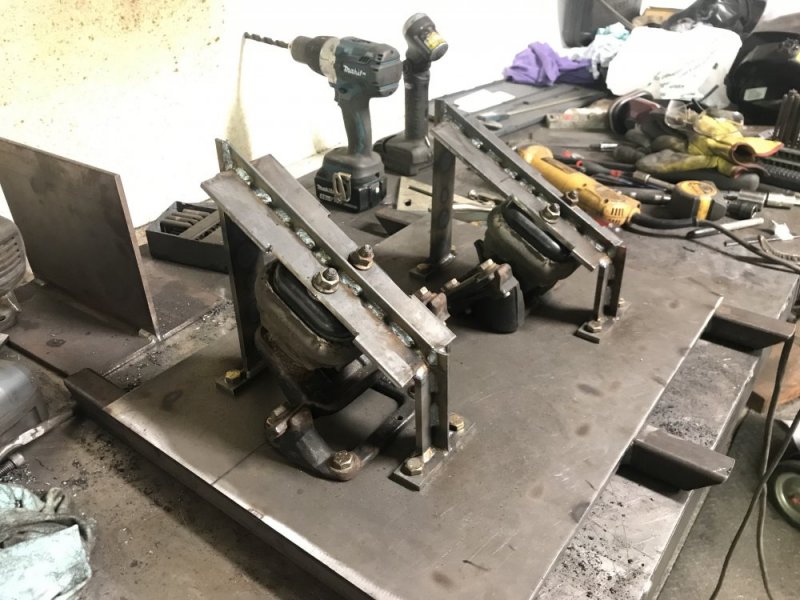

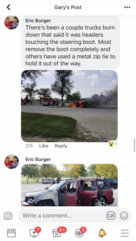

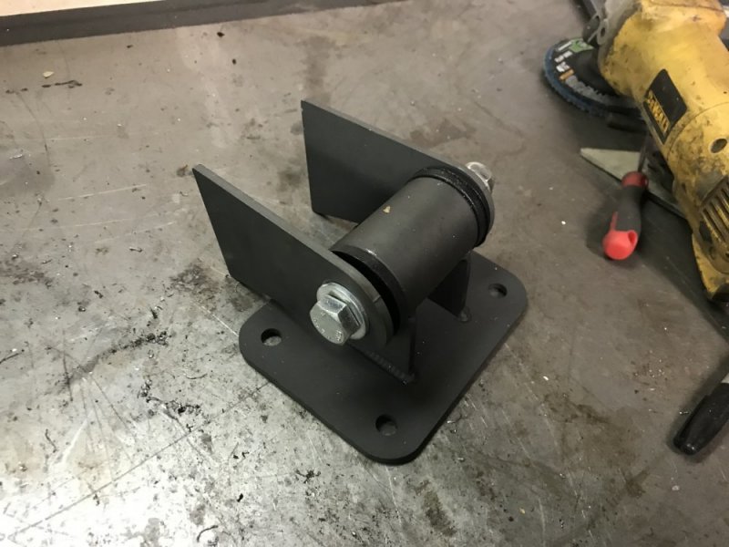

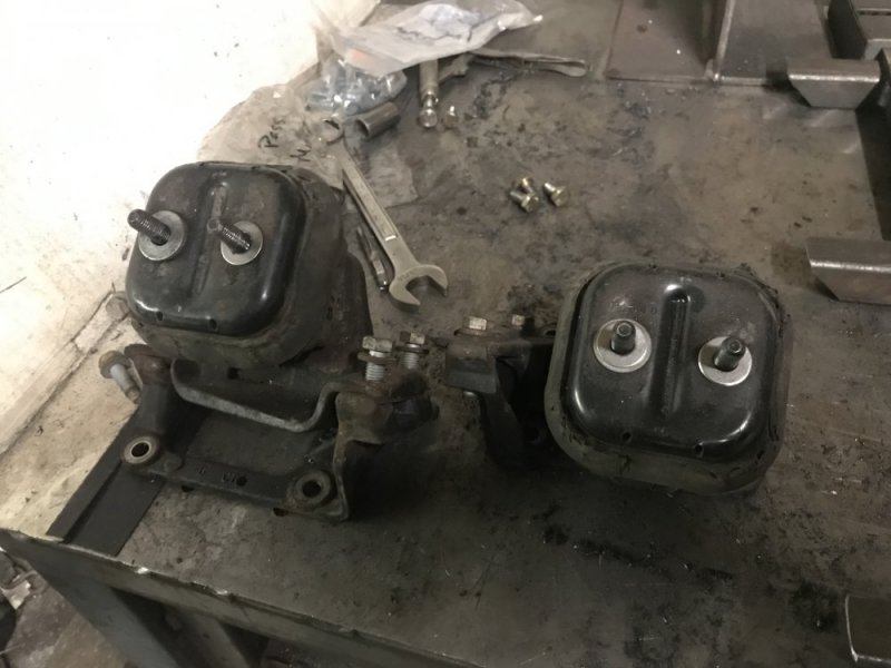

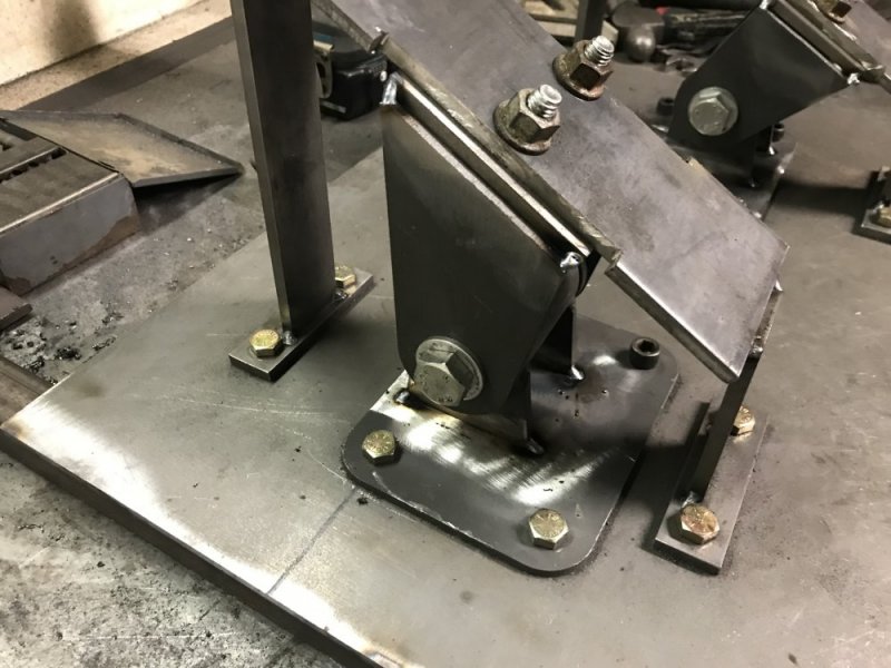

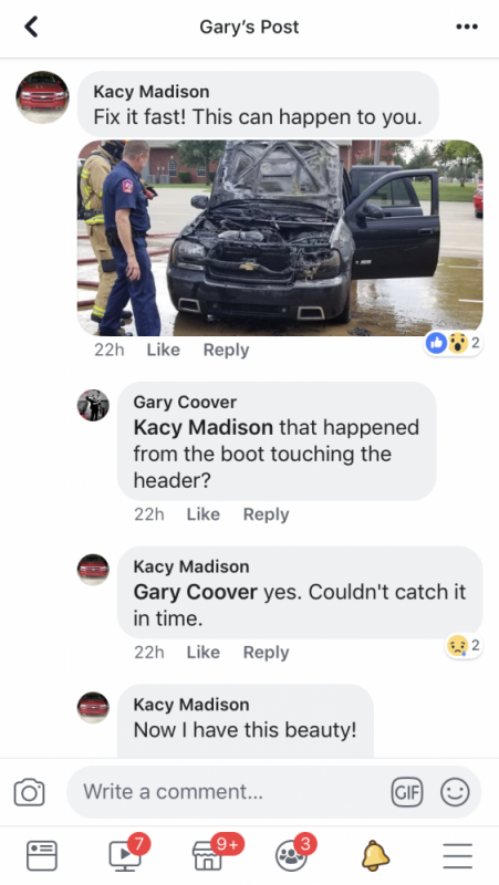

This week I was busy every night and didn’t get a chance to work on the Envoy. Yesterday I started working on new motor mounts for it. I am in a couple Trailblazer SS groups so I can pick up some tips. I saw a post about a guy complaining about a burning rubber smell after his header installation......people told him to take care of it right away and then showed pictures of TBSS’s burnt to a crisp!! Yikes!! There’s a rubber boot around the steering column and some headers are too close to that and it melts it and even sets it on fire. The solution is to put a heat shield on the boot, which I am going to do, but this problem can be made worse by old, sagging motor mounts. When I started tearing it apart I wanted to replace the mounts due to the mileage of the truck (147,000 miles), but didn’t want to spend the money. So now I was looking for mounts again.....both new OEM and aftermarket polyurethane mounts are $300, dang!! The aftermarket ones are really simple so that inspired me to make my own. I bought a set of universal mounts from the same company that made my headers (Speed Engineering) for $50. Then I spent another $20 on fixture materials and started going to town.

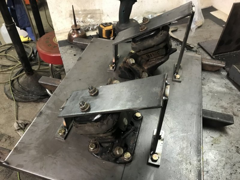

I found the measurements for new mounts. Then I measured how much my mounts had compressed over time. I made up the difference with washers of the correct thickness.

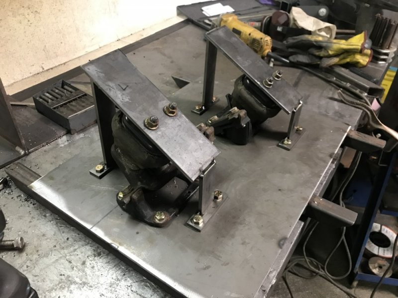

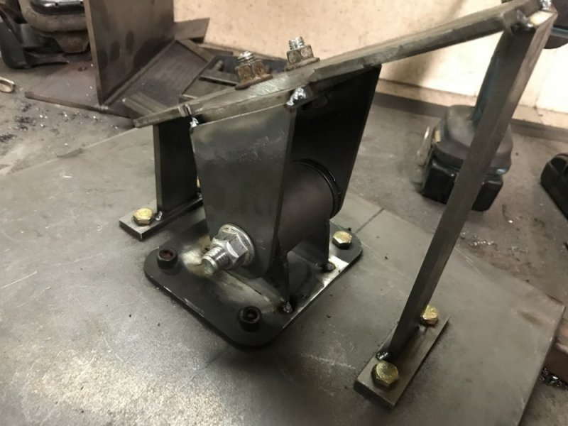

Then I mounted them to a 5/16” plate I got from work.
Of course, while welding reinforcements to the plate I ran out of shielding gas, so I just tacked things together from here on with the little gas I had left.

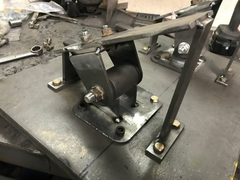

I made pieces that bolted to the plate that would locate the top of the mounts.
Unfortunately I had to cut the SE mounts apart because the Envoy mounts weren’t centered. Once they were cut apart I put them in the fixture so I could mark where they needed to be cut.
D82EA12E-2F85-4EAE-8CB5-A5FE2D07388F.jpegF46B58DA-EF98-4AC4-92FE-9523C727EE88.jpegC346363B-98DD-4A88-8C2B-93B7C9F1A45F.jpeg

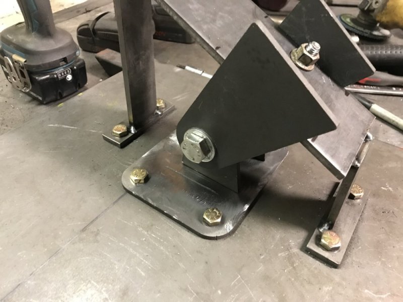

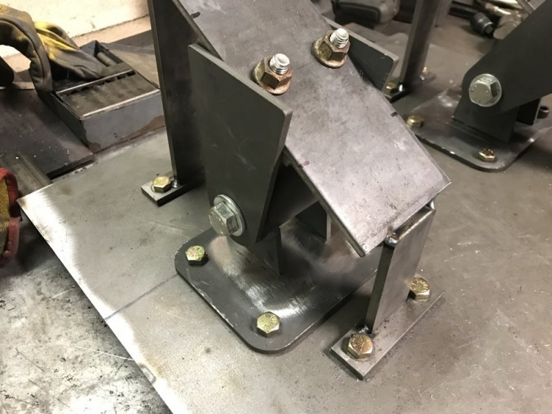

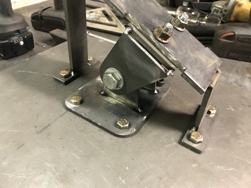

So I cut the brackets down and then tacked them in place.
03731B3C-FCBC-424C-AC2B-E5D9F0F127CB.jpeg984D116C-4598-48D1-96CC-9A0F0DFB6F3D.jpeg4C9CF4A8-7030-4729-81B7-795426ADF117.jpegE9745363-24C3-4109-B9BE-8CCE13608E2F.jpeg
Tomorrow I’ll get more gas and then I can finish welding the fixture which will then allow me to finish welding the mounts.

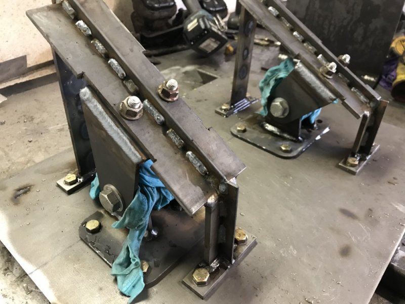

Last night I finished welding up the fixture.
Tonight I welded up the mounts. The rags are soaked in water to keep the bushings from getting too hot. I also poured water on the legs of the mount after each weld to further keep it cool.

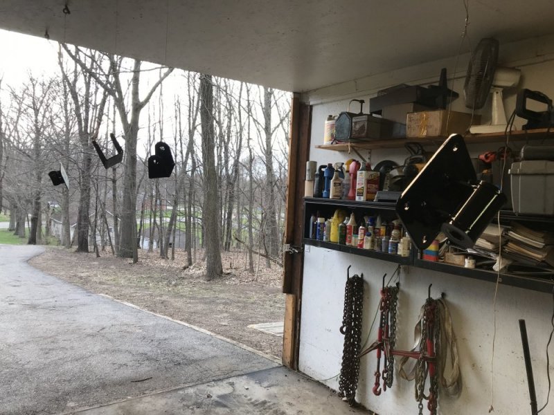

Then I hung and painted all the pieces parts.

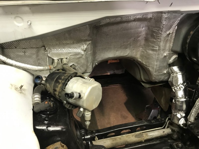

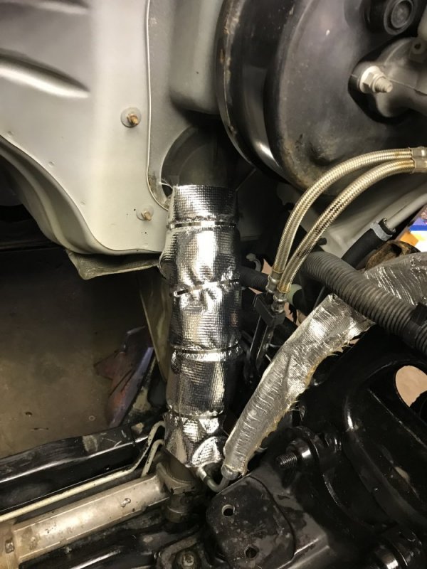

In between coats of paint I started working on the rest of the heat control project. First I wrapped the steering column in DEI Heat Screen.

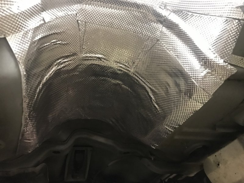

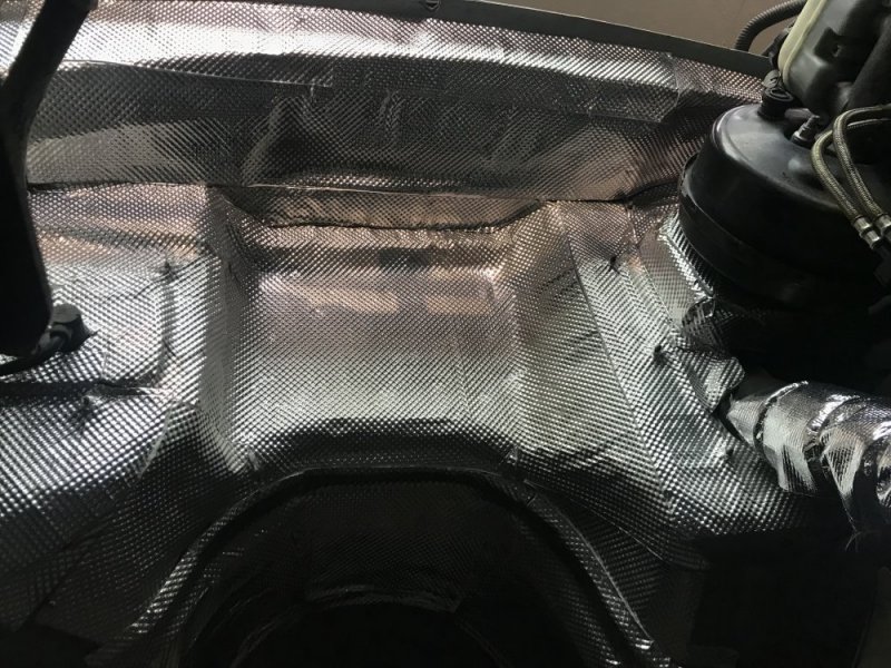

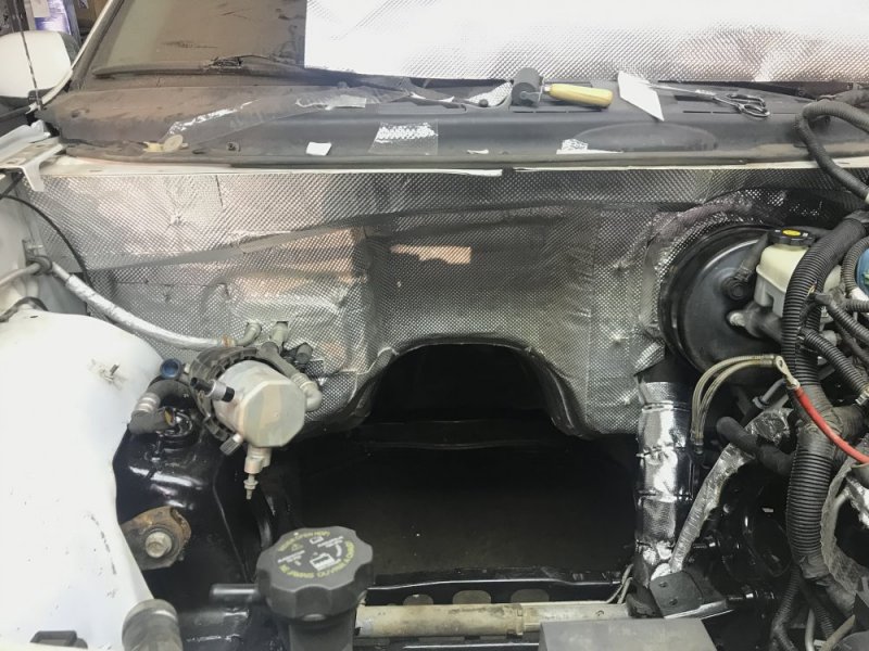

Then I started applying DEI Tunnel Shield 2 to the firewall since it’s easy to do right now with the engine and trans out. That should help keep the additional heat and noise from the headers out of the cab.

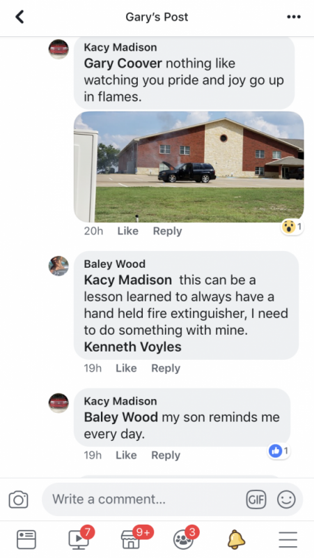

And here was what led me to start on this motor mount and heat shield sub-project.
