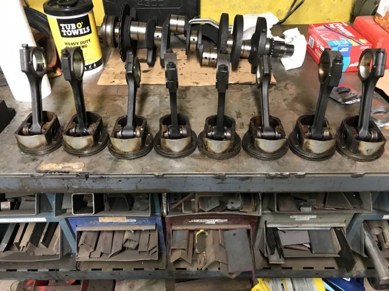

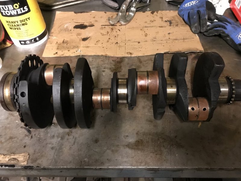

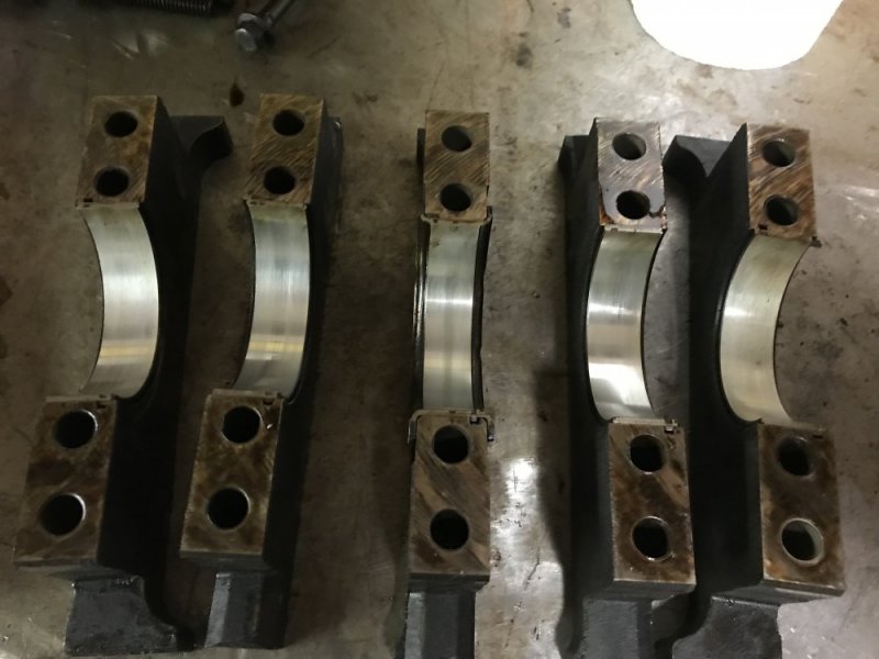

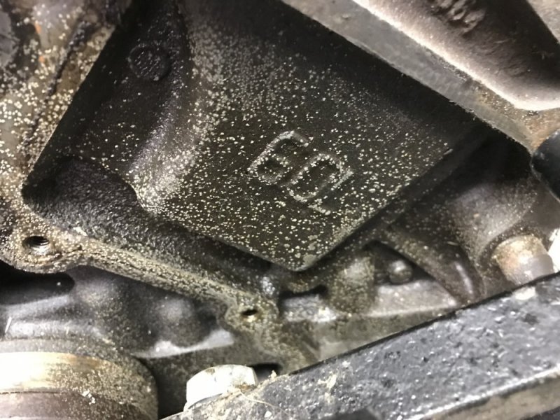

I forgot to finish my thought. They were defintely driving around for a while with the rods hammering and either ignoring it or listening to the stereo too loud. I guess when your parents give you a vehicle you can do that.....I wouldn’t know what that’s like.Never seen a oil pan like that. Crazy what the car manufacturers come up with to make things work.
By the looks of them bearings I’m willing to bet the PO herd a noise and just kept driving around until the noise finally stopped one day. Looks like the PO was one of them people who bought it and never checked or changed the oil in it. Just kept driving wondering what is that noise I’m hearing.

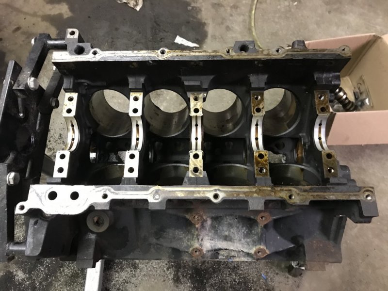

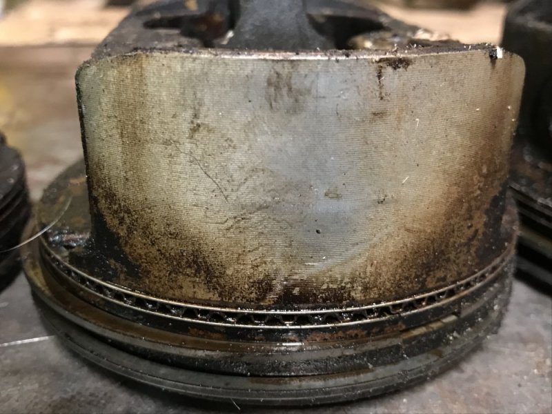

I wondered if that’s what it was. What’s weird is those were #6&8 and #1&2 were the ones that seized. I guess it’s probably that those are the last ones to get cooled so they would get the hottest.Wow those cylinders do not look good- that dude got way hot.

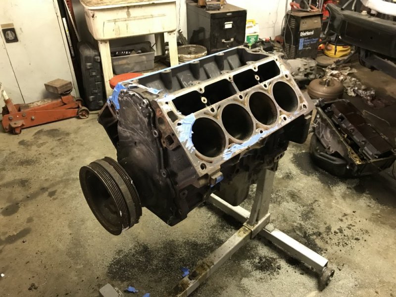

I’m pretty new to the LS game, but I have been reading quite a bit for a month or so on these. What you say is true, but that is more for people going for bigger performance than I am. I’m aiming for a torquey daily driver that will still run on regular gas - that’s why I was looking for the LQ4 bottom end with the dished pistons. The Gen 3 rods should be fine for my anticipated power level (450 - MAYBE 500hp at the flywheel). I tried calling Brian Tooley Racing for a cam recommendation today but got voicemail....when I do get through, compression is one of the things I’m going to ask on a recommendation for so I’m going to leave all piston decisions until after I have that conversation. I feel best changing the reluctor wheel and using all factory electronics rather than add an additional widget into the mix. Same goes for the knock sensors: I’m going to move them into unused holes in the side of the block so they should function the same as the Gen 4 and use the factory harness.The 03 lq4 is the undesireable bottom end. They used the weak rods stock. You already know about the 24x vs 58x. You can buy the lingenfelter converter box to deal with that, but I would get a crank with a 58x balanced for the lq9 rods if it was mine. And 10:1 for an LS is low compression. The lq9 is a bit over 11:1 and runs fine on 87 octane. The flat top pistons actually have better quench height which helps resist pre-ignition along with the 317 head runner design. For naturally aspirated the lq9 is a better option, the lq4 is better suited for boost.
As to your 5.3l aluminum block, they're not that desireable except for street rods and other applications where weight matters. They're known to be fairly weak and don't take well to boost.
I was just thinking about this some more. You bring up a good point regarding the LQ9 pistons - if I have to go the route of new pistons, I may as well go LQ9 and get a cheap set of 317 heads. About the same compression ration but more efficient quench. I’ll have to get 2 new Gen 4 rods, but that’s doable.The 03 lq4 is the undesireable bottom end. They used the weak rods stock. You already know about the 24x vs 58x. You can buy the lingenfelter converter box to deal with that, but I would get a crank with a 58x balanced for the lq9 rods if it was mine. And 10:1 for an LS is low compression. The lq9 is a bit over 11:1 and runs fine on 87 octane. The flat top pistons actually have better quench height which helps resist pre-ignition along with the 317 head runner design. For naturally aspirated the lq9 is a better option, the lq4 is better suited for boost.
