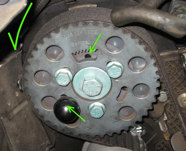

Hey fellas, time is getting close for me to pull the jetta out of the yard and get the timing belt replaced. My son wants it running and driving reliably LOL. I went on an online searching spree this evening looking for all the procedures, do's and dont's. found some good write-ups on it but I'm not sure about some of the things I am reading....
in the procedures apparently I need to loosen the bolts holding the cam sprocket and possibly remove the sprocket to get the belt on. the cam sprocket is adjustable and I am not looking forward to that part. Here is a pic of the cam sprocket with it's adjustment. there are three bolts that hold it on the cam and a lock pin tool that will lock the cam from moving in the head when removing the belt. in the procedure it states to pull the lock pin and remove the three bolts to get the sprocket off. then with the new belt in place on the crank, slip it on the sprocket and tensioner while slipping the sprocket over the cam at the same time while everything is the right positions before tightening the belt (short form of procedure).
I can't seem to find the procedure on how to get the sprocket properly adjusted. wondering if I can not loosen or remove that sprocket leaving it alone. I know some of you have experience with these engines, I'm a little intimidated when it comes to these things fearing I get it right since this thing has to be precise unlike our good old chevys that only go together one way without any "adjustments" like this.

I have been through several belt changing procedures.
All the ones I did the crankshaft timing marks had to be aligned to a certain point and the cam(s) had marks on them too and usually the mark on the cam was straight to the top, then there is no valve spring tension on any lobe to cause the cam to roll.
Then a matter of releasing the tensioner, slipping off the belt, replace front crankshaft seal, on with new belt and tensioner and good to assemble.
If there is a pin through the sprocket to prevent the cam from rolling over, if You remove that sprocket, is the cam going to roll out of alignment ?
What has been suggested. Insert that pin, remove the belt tensioner, slip off the belt, do any other maintenance and back on with the new belt.

I do know having the proper vw tools to lock the crank in place is critical.I bought a pretty nice kit from eBay years ago to do one of those.I do remember having to loosen those three bolts on the cam sprocket along with the big bolt in the middle.Theres no keyway on that camshaft.Its just a interference fit and the torque is 70ft/lbs going from memory.

That is what my fear is, loosening that cam gear and then getting it back where it should be at.
Aren't you supposed to pin everything before taking anything loose?
