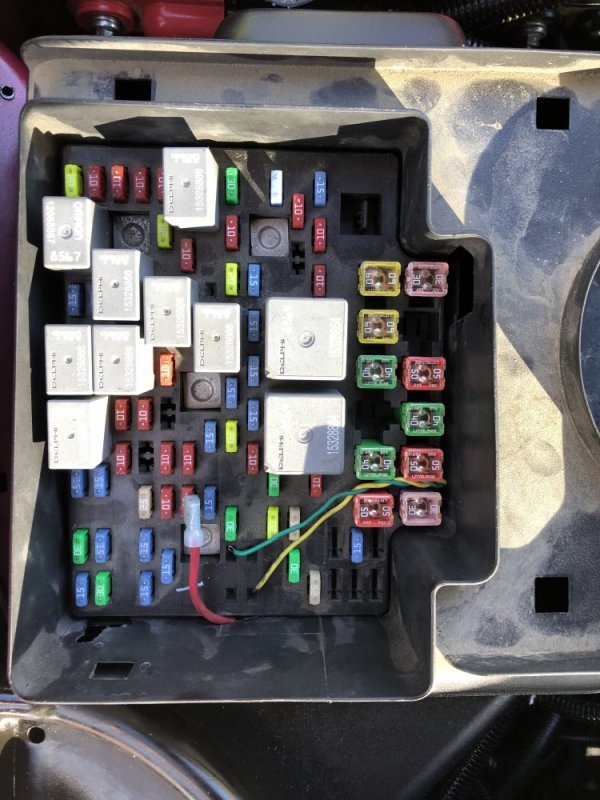

Well guys I’m here to pick it up. Lots more details to come but I have an issue I’d like to run by you.
There’s a few things that need some addressing that I haven’t talked with Eric about yet. But in looking things over, in the under hood fuse block there’s some wires ran into a couple slots where a relay for “EDU” is supposed to be. I just touched one of the wires and the engine died. I can’t believe that this would be acceptable. Let me know what you think. I’m starting have second thoughts about this project. But it runs. FYI the red wire is for my lift pump. The yellow and green are the ones they added.

Yeah they need to supply power correctly. I would take the time to give everything a once over real good before driving out of state. Not sure what you paid, but I’m sure it is enough to warrant a descent inspection. And having something that cuts out the engine that could have happened from a bumpy road- ought to have him be willing to square away what you find.
Yeah I’m trying to go over everything real good. So far the relay wiring which was basically to get power for the ecm relay (I really think there should be a better way to do this than to shove wires into the slots. He did say there should be space terminals crimes on the ends of the wires (which there wasn’t). They took care of that. I’ll probably end up moving it underneath the fuse box and tying into the correct wires after I get it home.

Yeah I think it was just me being a little paranoid and assumptions on my part. I totally understand a few things might get missed. Although I would expect a shop that does this all the time, and has done several hundred, would have a checklist to go through and make sure all is good.
I was assuming (based on talks with Eric and the videos posted as well as other folks posting their experiences) that I could hand over the keys and come back to a perfect truck that was turn key and ready for a cross country trip. In reality, it’s a 14 year old truck with countless things to go wrong from age and Eric isn’t the only one working on it. There’s a few guys (one is pretty young) working with him. While I have no doubt about the work Eric does, I do question the work from his employees. I also have to realize that Eric’s specialty is Duramax Powertrain swaps and not a vehicle builder per say. I also feel like the job was rushed towards the end. But I’ll get it all worked out in the end.

- EDU relay wiring not complete — Fixed
