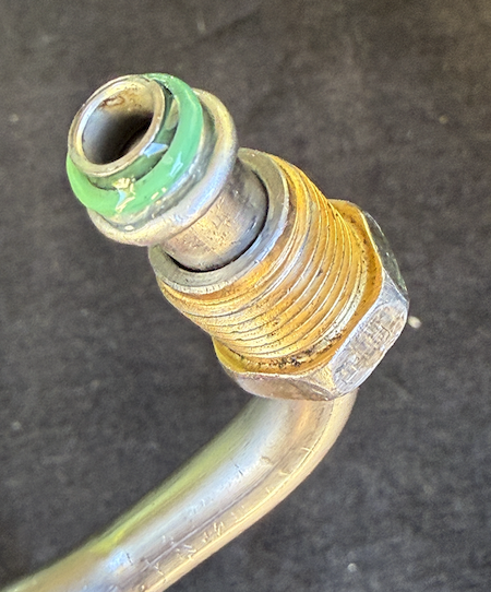

the amount you recovered on the first go-round turned into later charging with only gas and no liquid. using fresh you are charging with almost nothing but liquid. I have never figured it out but most recovery machines when using them to recharge has to have some amount of liquid in the tank before it works correctly.
Not saying this caused your high pressures though. I am sure there was a blockage causing that.
