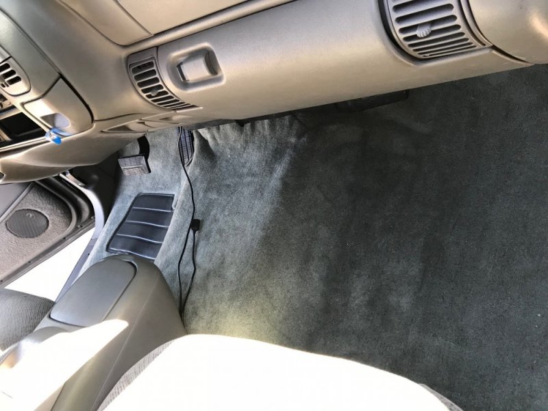

Great 'Soccer Mom' truck. Love the way it drives now that the brakes, tires and alignment are done. That and the removal of dirt, dog hair that remained in it after several years of sitting unused. I did note some rust bubbles along the lower edges of the quarter panels and a couple of the door edges. Not bad save for the driver's side back door. That one needs some real help.
The carpets were cleaned and a new stereo w/backup camera installed on 19 SEP 17. Previous to that I was attempting to remove seats etc. to facilitate the cleaning. Spare Tire Cup bolts just spun as the welded nuts let go due to rusting underneath. One of the rear seat bolts was frozen after a few turns and wouldn't retighten. That nut eventually broke off but that wasn't from rust, rather, over torque application.

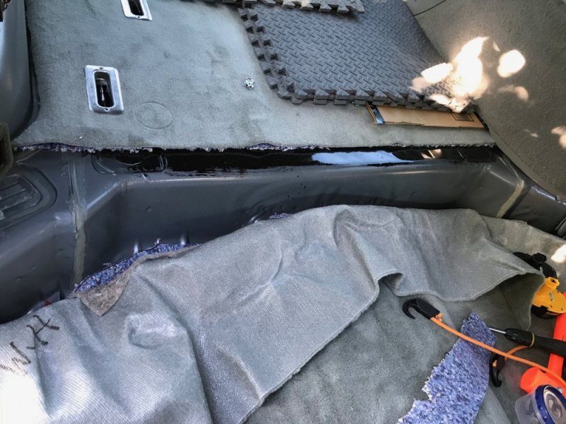

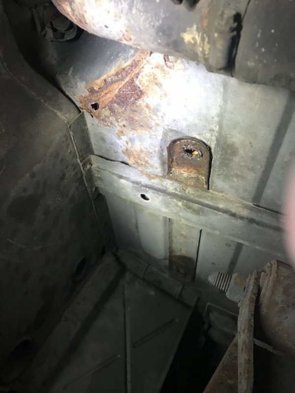

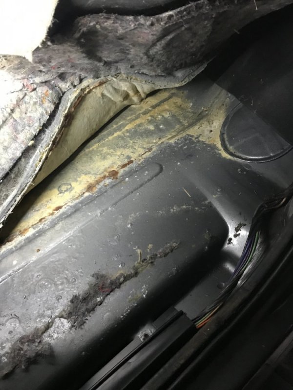

The day after the cleaning I was checking under the carpet to see if things had dried out any and noticed that: A) things weren't dry and, in fact, had been damp for a very long time; B) I discovered a lot of old dirt under the sills and behind kick panels where I hadn't cleaned earlier and C) there's a lot of surface rust on the floor pan from dirt and moisture wearing through the painted surface. 20170922 Rust2.JPG

Search and destroy before winter:
Carpet comes out completely and replaced by LMC sourced product.
Remove all surface paint effected areas where rust is visible or presenting by paint bubbling on the floor pan 1st, door edges and quarter-panels, then address the underside back by the fuel filler lines where there's some issues developing. POR15 degrease, metal prep and coat with top coat the effected areas. Use POR-15 Filler and Sealer on one small hole by the Filler neck, underside.
Color match paint along quarter panel and door edges.
Replace weather stripping around doors to prevent their rubbing on the sill plates again.

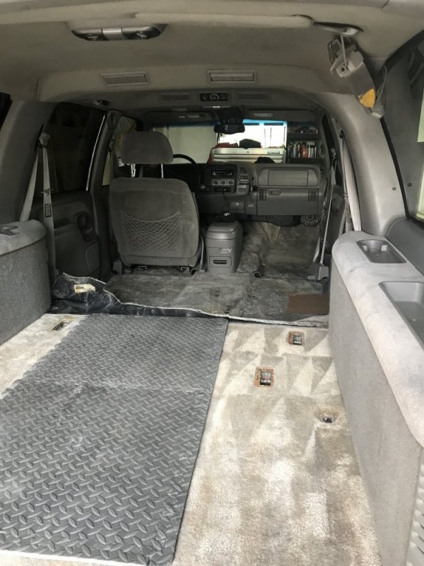

Got the carpet out and most of the panels. The ones I can't get out won't effect the rust treatment effort or reinstallation of the carpet. Cleaned out most of all the dirt and stuff hiding in corners. The bolts holding down the seatbelts in the rear are not coming out with any tools I possess so, I just cut the carpet out and will reverse the process for the new stuff. Tomorrow I'll start the bubbled paint and rust stuff.

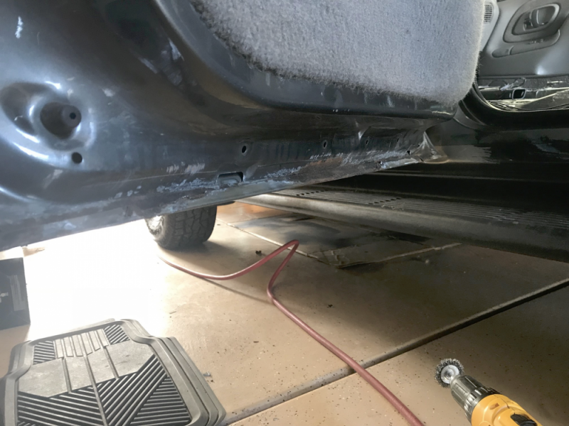

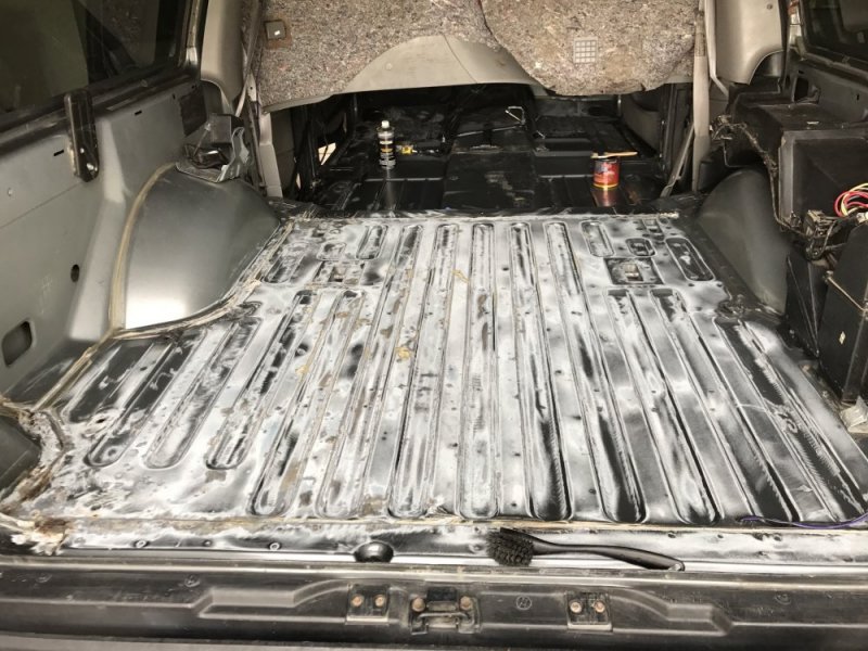

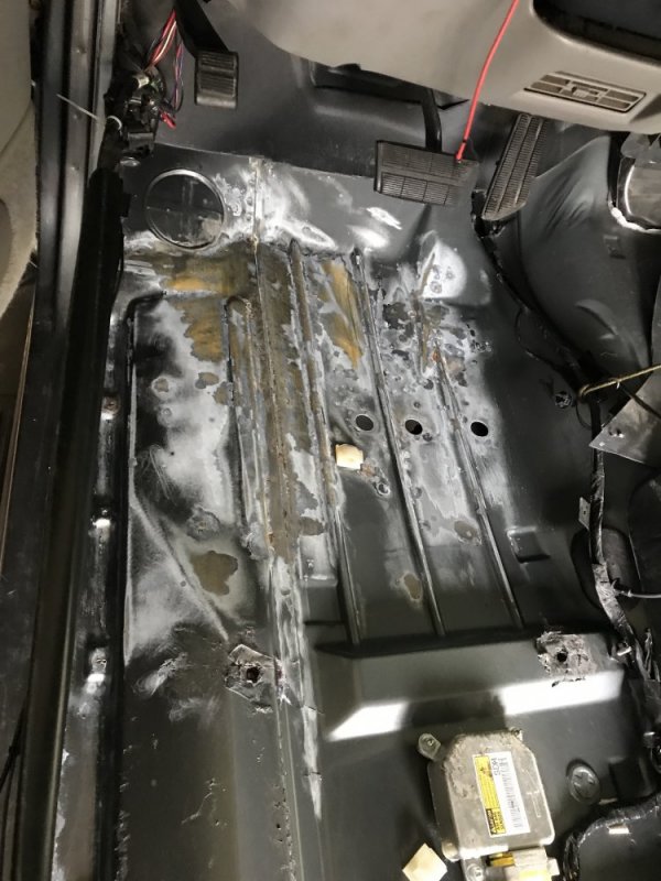

Then it was time to attack the rust and blistering paint using a wire wheel on the drill, DA Sander (60 grit) and small angle sander. On the driver's side, I found that a couple of the floor's drain plugs had rusted through.

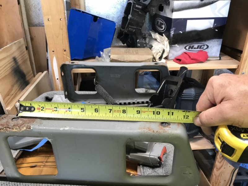

I found the replacements at the stealership but would need a week to get them shipped from Michigan and, oh yeah, $10 each. Yeah, RIGHT! I'll use a couple of piece of galvanized steel with POR15 sealant to patch those holes. $10 ea....

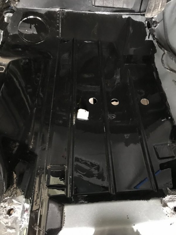

After sanding it was degreasing and then rinsing out with water. Then, treating the floors with POR15's Metal Prep (leaves a coat of Zinc on the bare metal for the POR15 Rust Preventative paint/solution/treatment...stuff to react and adhere too. More rinsing then air blasting the seams I removed factory caulk from (rust underneath) to get the water out followed by time with a propane torch going over the same. Left a space heater on 72*F overnight to make sure it was all 'bone dry' per instructions.
First coat went on in about an hour with second coat to go on w/in 5 hours. It's been three so I'm going to put the second one down in a few.

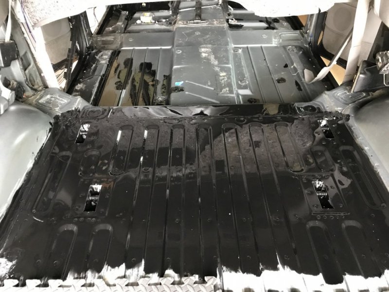

I have do the cargo area in two steps given the length of my arms and back doesn't allow me to do it all at once. Life

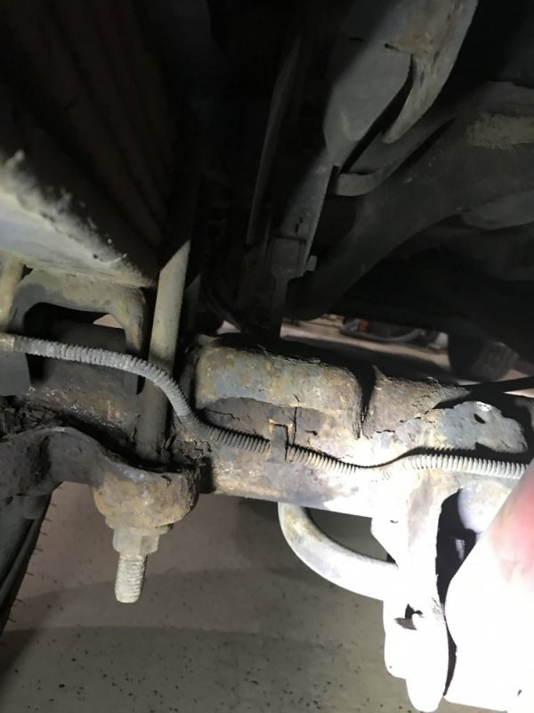

Yes there's some rust on the floor pan underneath as seen in post one. That corner underneath will get putty and seam sealer today. Then scuffed and hit with Rubber undercoating.

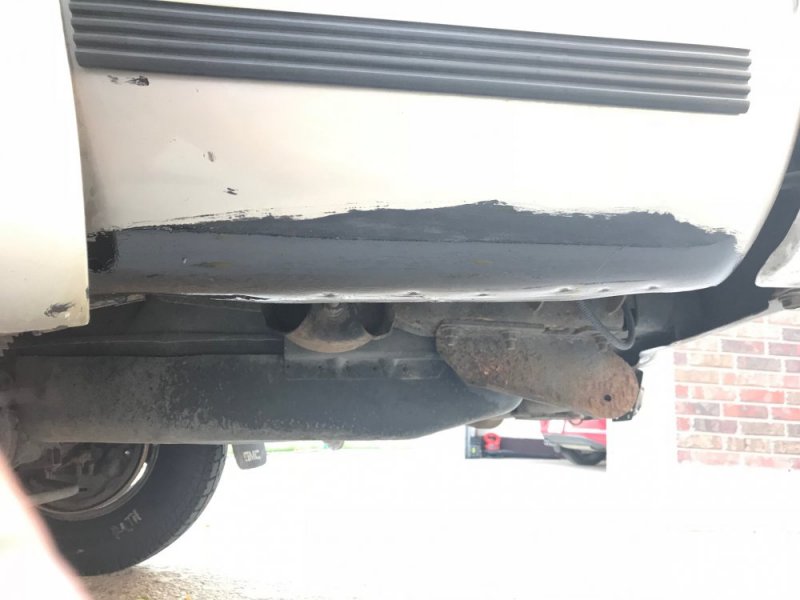

There's more rust on the lower edges of the quarter panels in addition to the lower edges of three or four of the six doors. It gets worse towards the back. The frame has some flaky rust that starts about where the quarter panel starts and gets worse toward the back. Even the fuel tank's vent tub is eight up with it. The trailer hitch is so shot to hell I'll just replace it rather than spend the time and $ to media blast it. I've yet to post pictures of that stuff as it is another job...exterior. This part is 'Interior.'

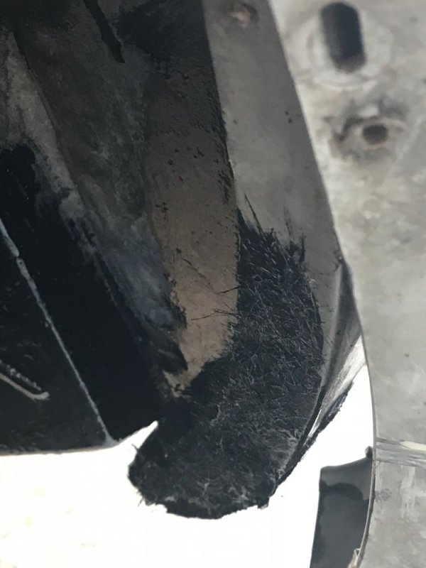

POR15s Sealer Putty (calk) arrived yesterday so today I went about seam sealing and when the fiberglass arrived this afternoon, it was just in time to do the small hole in the back by the filler neck. Worked like a charm and I ran out right at the end of the job. That's a minor miracle in and of itself. TTS Member 635 (Ted) called and said he had some grey seats, both 8 way power, that might fit so I sent him some specs just to be sure. Hate to look a gift horse in the mouth and all but, it can't hurt to do a little expectation management since these are out of ASTRO. While taking the measurements, I noticed that I had failed to address the rust on the bottom of the seat pedestals.

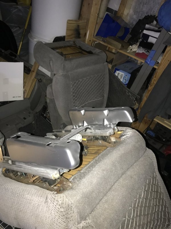

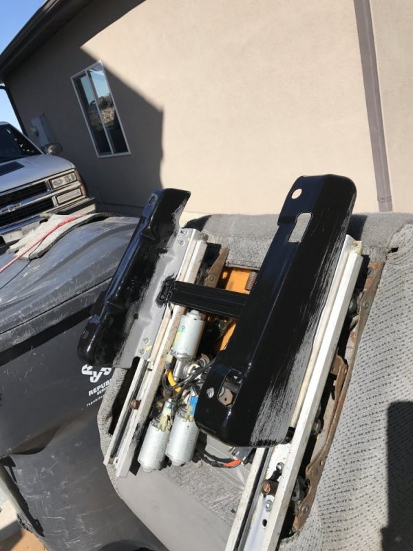

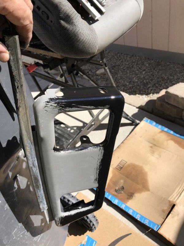

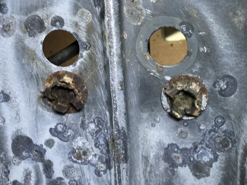

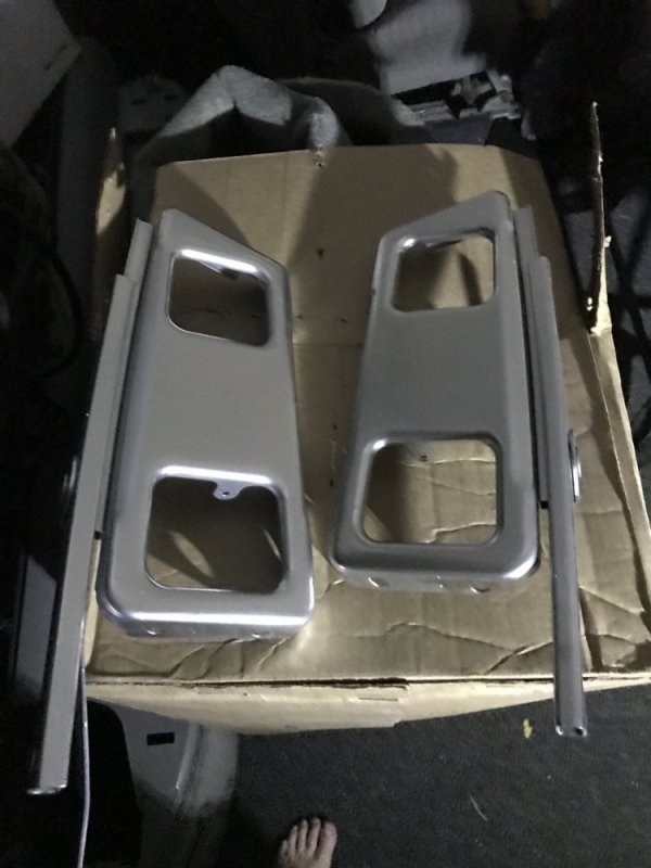

The driver's side was way worse. So, since I was stalled waiting on the sealer to cure I started preparing the pedestals for a little love themselves. Seems everything POR15 related isn't 15 minutes, its closer to 5-6 hours.
Then, since these will be visible and somewhat UV exposed, Top Coating is required. While waiting on the curing process to reach the 'tacky' stage I went to get paint. Couldn't find grey enamel so I picked up 'Aluminum' instead. Shiny!
Tomorrow, I'll do the RTV Sandwich of metal on both sides of the drain holes and maybe, just maybe, get started on putting Humpty Dumpty here back together again. At least, on the inside.

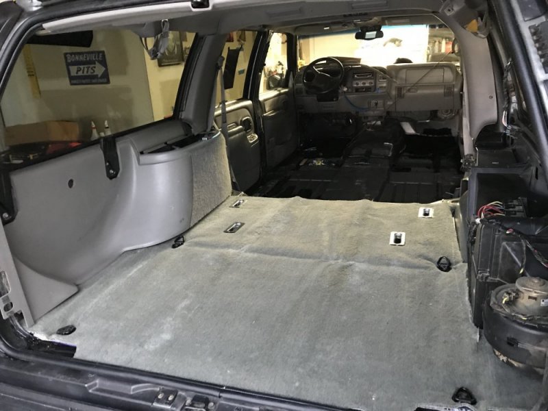

Cargo area carpet in. Still need to button down all the trip pieces but it fits. A little big but, it will do fine.
Replaced the Driver's side and cargo door weather strips. Sure sounds better now when the doors close.

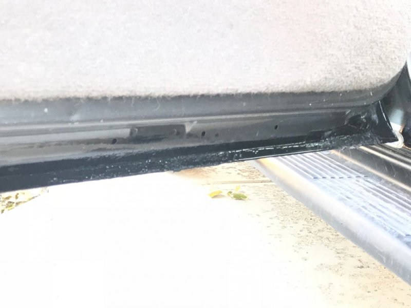

Monday, I did get the rust under the back the doors and the barn doors prepared and they all looked pretty much like this one.

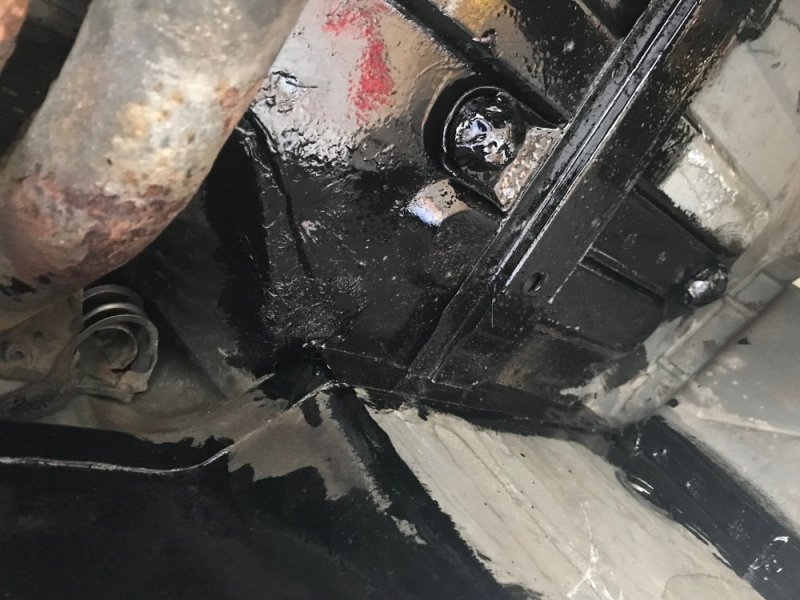

Tuesday, my '2nd day of work' I woke up early with my head swimming with work stuff so, at 0400 I put on the first coat of POR15 to the doors, quarter panels. I did a couple of spots inside the rear fender wells along with the left rear fender edge itself. Some of the areas had actually rusted through so I applied some more fiberglass along the door and fender edge. Yes, I know. My fiberglass technique sucks.
Here's the underside, back corner of the cargo area by the filler neck. That hole and seam came out good.

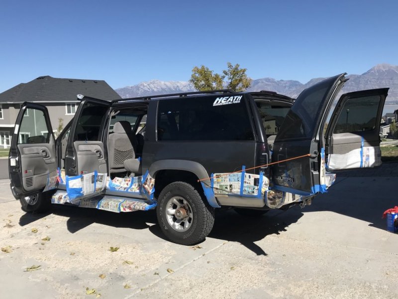

Big T split before I could rope him into helping with the painting. Really, it was a one man job. My original plan was to do a full spray job on the bottom half but, I have a bit more work to finish off the fiberglassed and other areas. Som, I decided to just cover the POR15 and be done with it until spring when I'll be back to 'Part Time On Call.' So, a couple more cans of GM11 Pewter and after scuffing it all down with the recommended 320 grit, I went after it.
Lesson 1.
I learned that when using the black POR-15 and trying to top coat it with a lighter color, such as Pewter, one needs to prime it first because the Color Match paint wasn't covering the black at all. I had a feeling but thought I'd give it a try. No good! After two coats, the black was hardly covered at all. So, out with the grey primer, cover all the POR-15 areas under the five doors, door sills and lower quarter panels, let dry and try the top coat again. Worked!

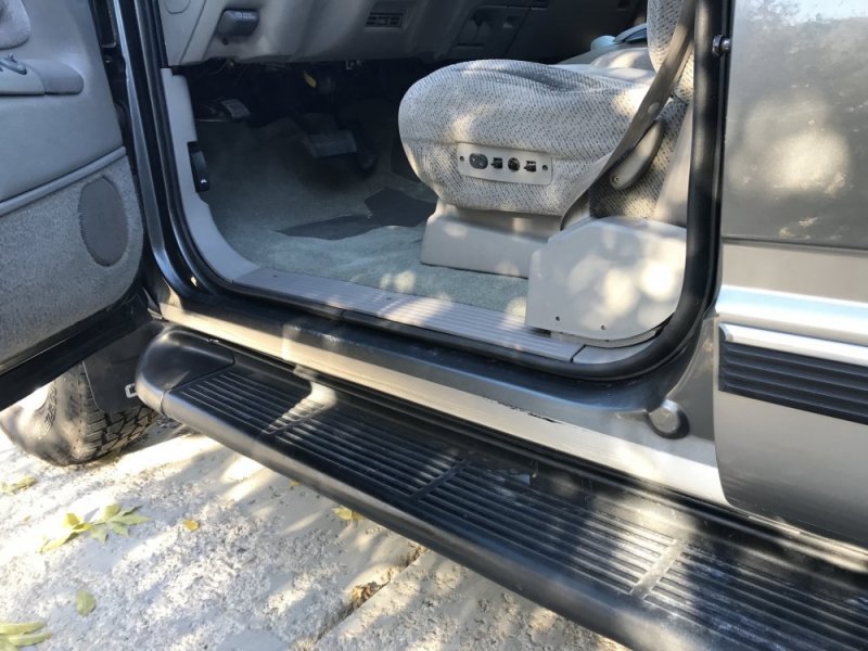

So, after it was 'done', all the sills looked pretty much like this one only I still need to go back and cover the black you see with 'Storm Grey.' Its just too soon to tape over the new paint and try again. I'd say 'meh' except the door sill behind this one has a few more spots than this to cover yet.

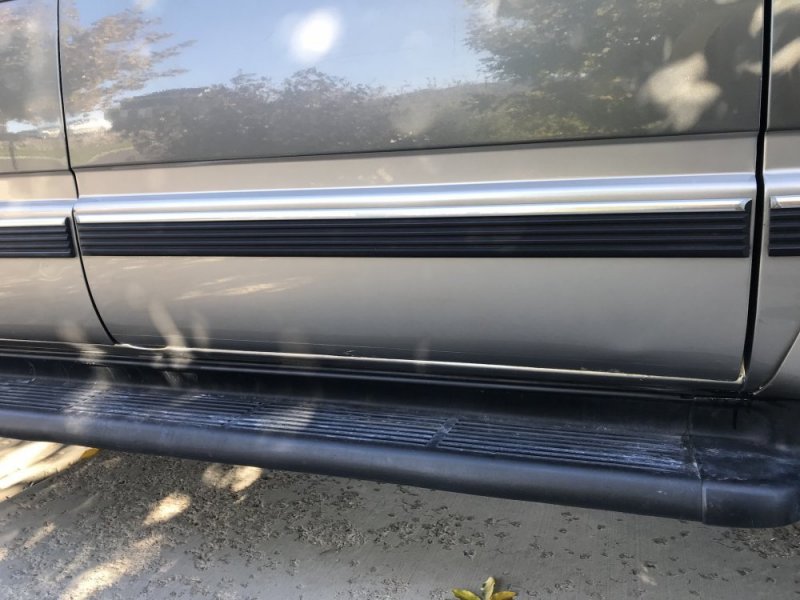

The exterior of the door with the rust hole and fiber glass came out nice.
