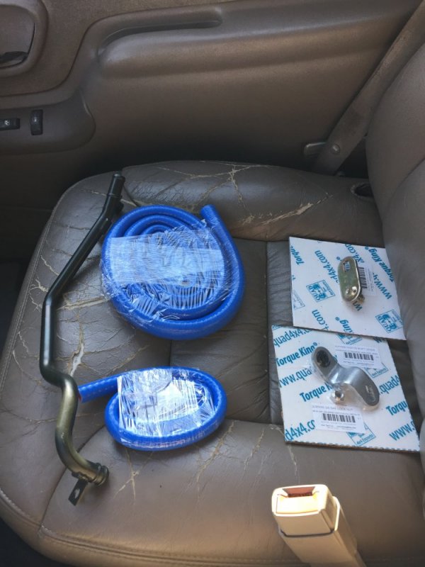

Mail call!! Finally got my federal emissions heater pipe. Turbo hose and heater hose. And 2 different t-case shifter linkages for the nv271. One is for dodge and one is ford. Gotta figure out the shifter issues with clearances.
