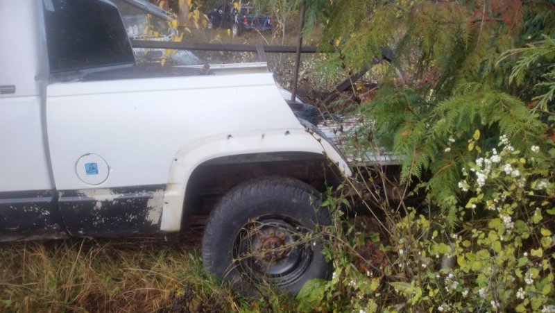

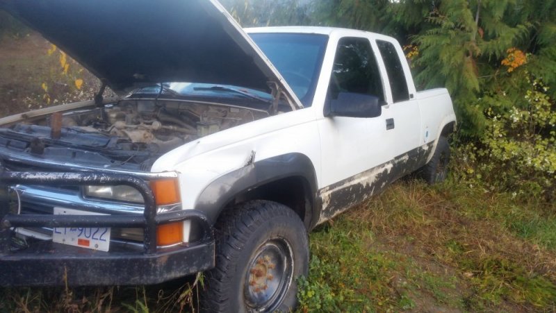

rear ended by a semi.. so to speak. Sister spun out in the snow trying to stop for a semi that was stopped in the middle of a hill on the coquihalla hwy and hit it backwards.![]()
So was this featured on TV: "Highway Thru Hell, Eh?"
