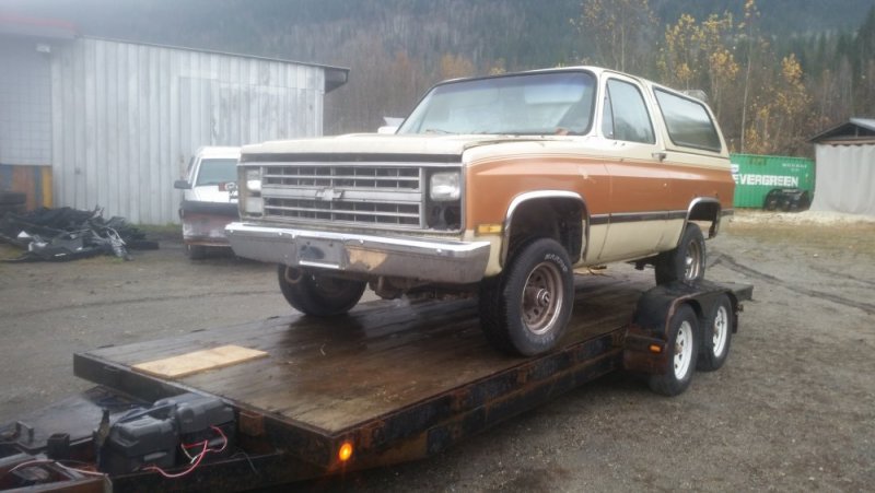

So ive been without a chev for a while but i just picked up an 87 blazer. More or less a rolling shell with a tbi 350 and no trans/t-case. My dad also gave me a 96 2500 6.5l.
First thought was to change it to all mechanical but i would like to use the 4l80e (i know i need a passenger drop tcase). Was thinking i could swap in the whole wiring harness and computer. Can this be made to work while still keeping the stock 87 dash? Any other problems i may not be thinking of?20181029_143628.jpg

The 96 engine can be swapped in. Your main hurdles will be finding a passenger side drop transfer case with a 40 tooth speed sensor in it, or modifying one. Otherwise you need to pull the 4l80e apart, and add a sonnax reluctor wheel to it for the output speed sensor. Many run the 90-91 square body cluster for the electric speedo, or you can buy a generator that will run your cable driven speedo off of the electrical output. 96 isn't a bad year to swap as it has no theft system to deal with. The biggest hurdle electrically is findi,g diagrams to turn your harness into a stand alone as you will not find anybody wanting to do it reasoneably priced. Without a/c the turbo shouldn't be an issue, but you could always pick up a banks manifold for it to move the turbo forward. Spri,gs shouldn't be an issue as people swap all iron nlick/head 454's into the k5 all the time without issue. 1 ton axle swaps are fairly simple to do as well if you want to beef up the drivetrain. It's all easily doable, just a matter of time and money.
