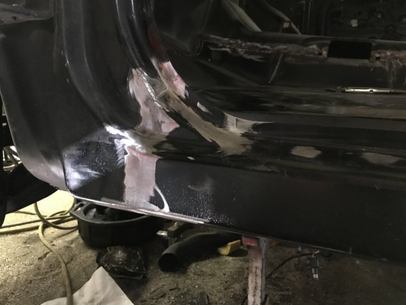

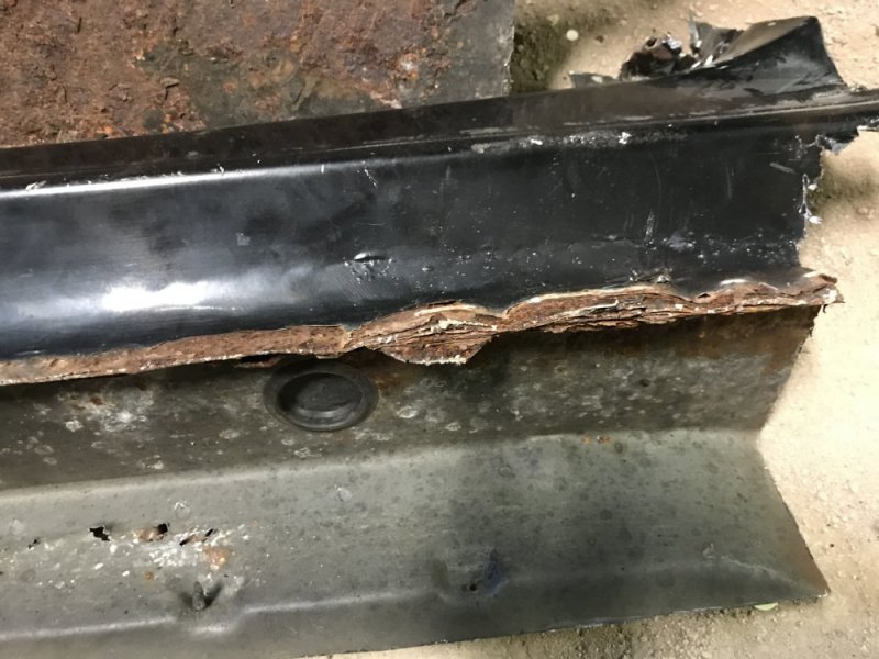

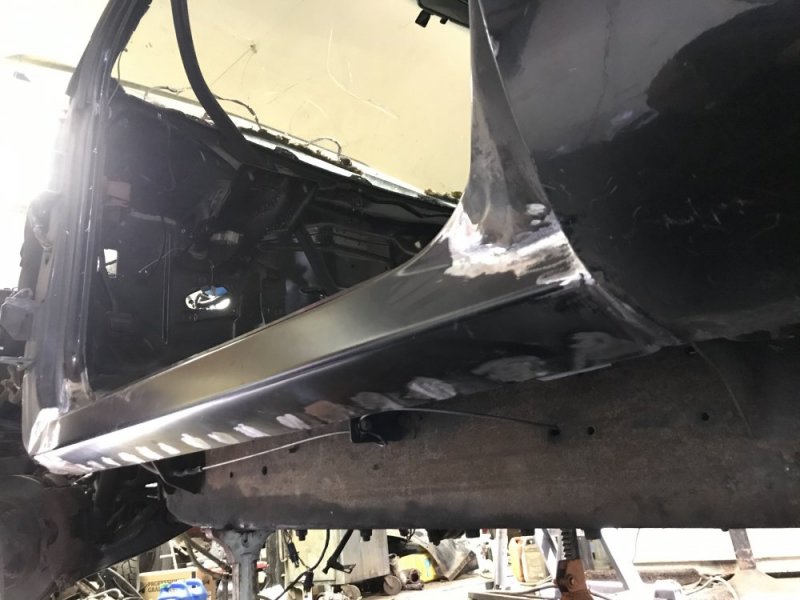

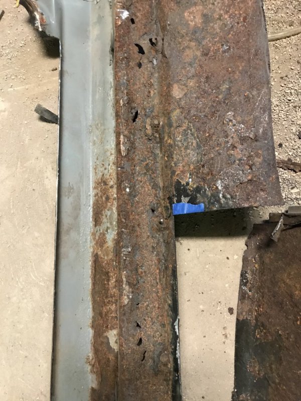

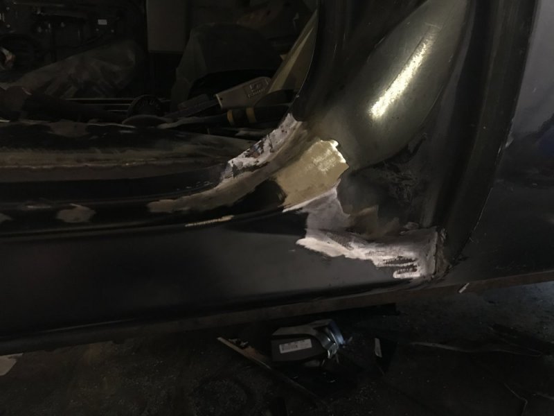

Finished the rocker panel tonight. It could be a little better, but it’s more than good enough for this truck and it’s all steel. Plus it’s an area of the truck that isn’t really going to be seen, especially once the weatherstrip is reapplied, so I think it’s going to be fine. If it bothers me, I can always do further bodywork in the future.

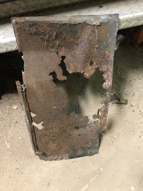

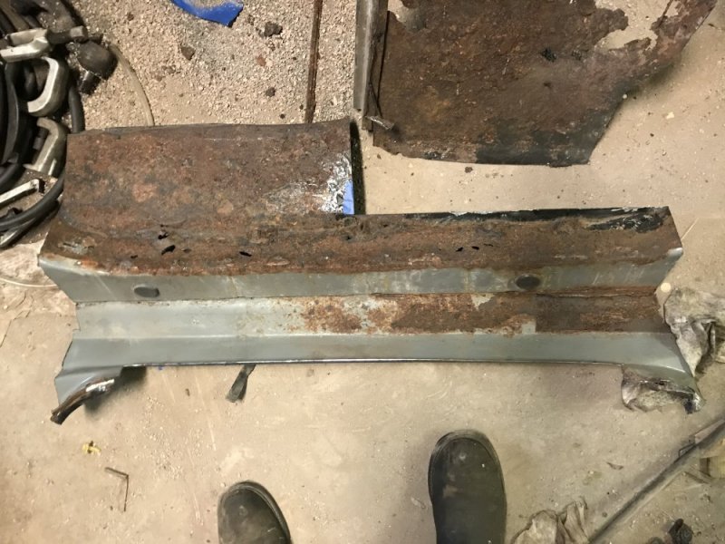

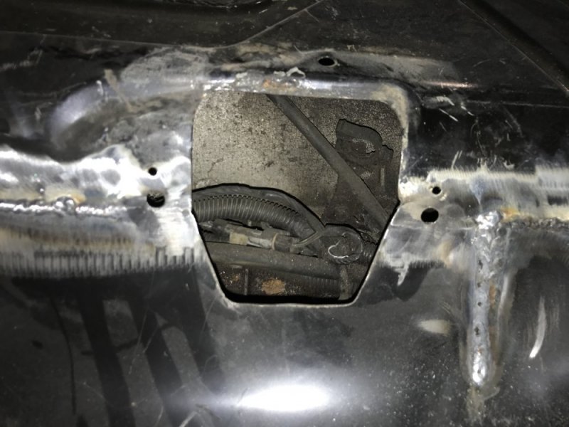

After that I re-cut the transfer case shifter hole and ground the welds down around the opening so it will fit properly.

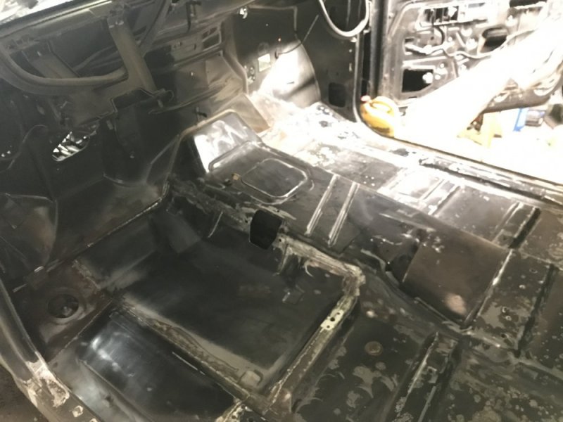

I’m leaving the rest of the floor welds alone so they maintain as much strength as possible and of course they won’t be seen anyway. Tomorrow I’ll be wire wheeling the parts of the floor that need paint and getting it prepped for paint. I’m so happy to be painting again.......

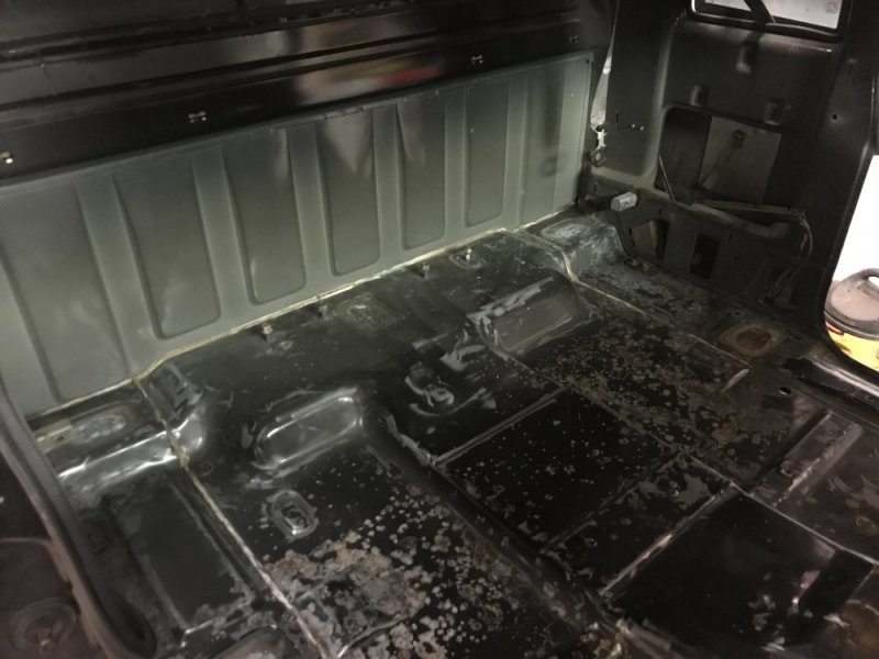

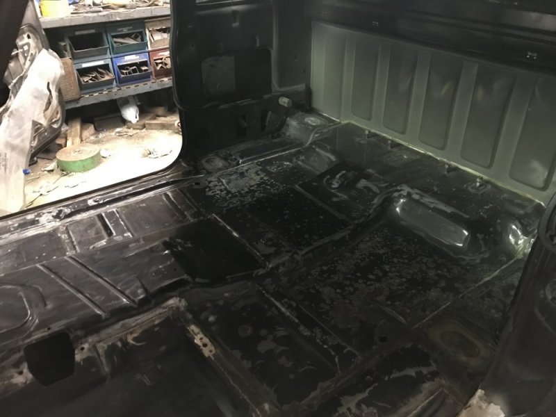

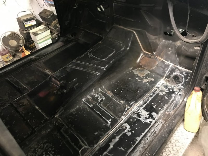

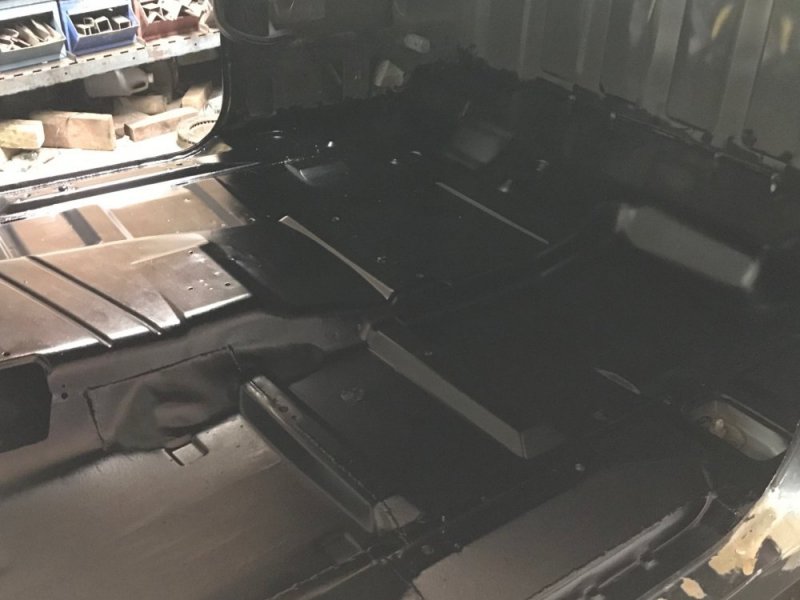

Slow progress this week. I started rebuilding the front brakes and upon closer inspection found the rotors I thought were good are hella pitted, so now I’m waiting on rotors (should be here tomorrow). I did get the steering gear and idler arm installed so at least there was that. After that I switched over and got the floor wire wheeled. Tomorrow I’ll be prepping it for paint and then 2 coats of Rust Seal on Sunday.

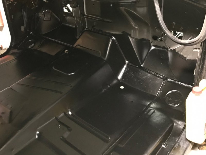

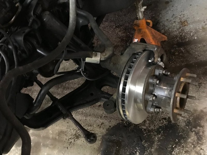

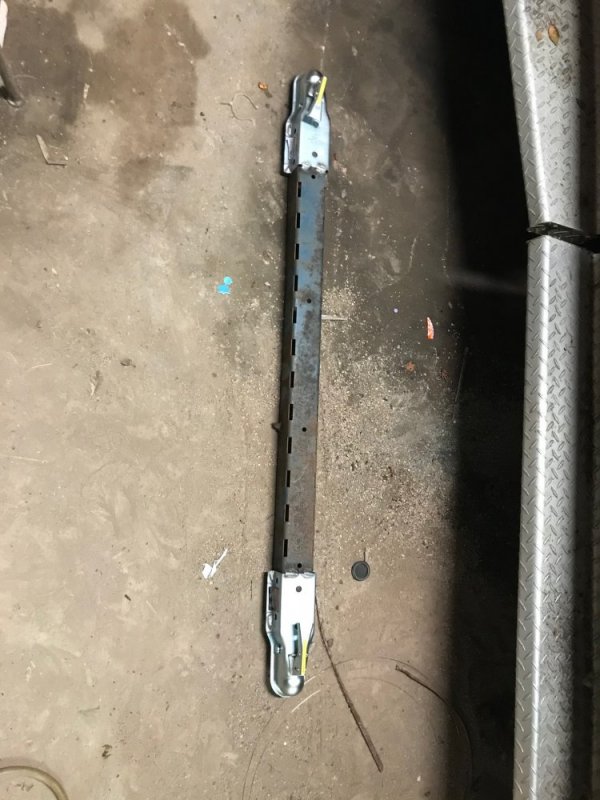

Made some more progress this weekend. Saturday I got the 2 prep steps of KBS Klean and Rust Blast done. My driveway is at an incline right up to the door of my barn so I was concerned about rolling the truck outside and not being able to control it. I could have used the Turd Ferguson, but the brakes aren't the best on it and hopping off-and-on it while checking clearances around the truck would be a pain....so instead I picked up a couple cheap 2" hitch couplers from Harbor Freight and used a chunk of old shipping shelf support and made a double ended trailer tongue so I could use the F150 to move the truck safely.
When I got it back in the barn I jacked it up to put it back on jackstands…...this is when I realized I made a boo-boo. I still don't have the driver side CV axle in because I don't have the replacement boot yet. When I grabbed the left front wheel to remove it from the hub I was shocked to feel the whole hub moving around with the wheel! I removed the wheel and found that pretty much the only thing holding the hub and rotor assembly in place was the brake caliper. This really surprised me! I knew you weren't supposed to drive these with the CV axle removed because the bearing could come apart, but I didn't think just rolling the truck back and forth about 30 feet would be a problem. Perhaps me kicking the wheel to steer the truck didn't help. Well, lesson learned there. I slipped the CV into the hub and tightened the axle nut to draw the bearing back together, which worked, but then the bearing was stiff. Damn. Maybe it would loosen as it got used, but that wasn't a risk I wanted to take. I almost bit the bullet and ordered a new bearing assembly when I decided to check the compatibility of the bearings I took off of Krovvy when I did the GMT800 swap. What luck! The bearings are physically the same, with the only difference being that the 96 K2500 bearings have tone rings and holes for wheel speed sensors. So I capped the hole with the end of an old sensor and cut the lead, then I was back in business. I was glad that worked out because eventually this truck will be getting a GMT800 brake upgrade so it would have sucked to invest money into a wheel bearing for a somewhat temporary repair. Sunday I finished up rebuilding the calipers and buttoning the brakes up.

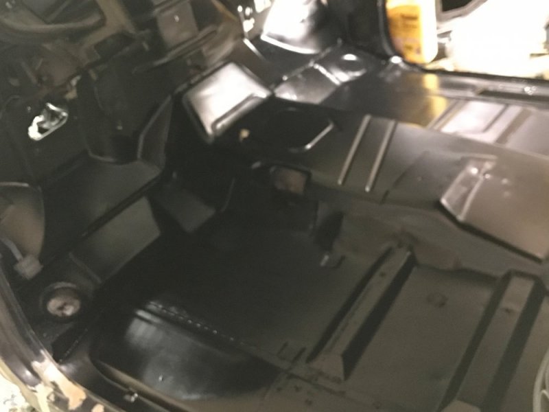

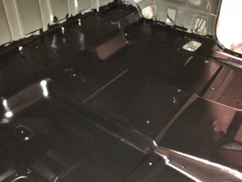

Sunday was also paint day. I applied 2 coats of Rust Seal to the floor. I started by using a foam roller, but less than 5 minutes in the foam came off of the spindle - the solvent in the paint must have attacked the adhesive. So I switched to a standard 2" trim roller to finish up. That worked well along with a 2" brush for getting in tight corners. I'm pretty pleased with the finished results - the floor looks good as new. I'm going to let it cure for a couple days and then I'll lay down some sound deadener.
Damn that petrochemical-based sealer softening and loosening the petrochemical-based adhesive holding the open-cell foam on the roller core. Just out of curiosity, is that stuff HVLP sprayable?
When the DS front wheel bearing failed on my daughter's 02 Dakota Sport 2WD while driving down US 34 at speed, it did a similar thing. The only thing that kept the tire and hub from departing the truck completely and passing her down the road was that the brake rotor was still retained by the caliper assembly. The tow truck driver had to jack up the front end with a floor jack and shove the tire up into the wheel well in order to back the lift under the front and pick it up.
I had to get a new spindle assy at a U-Pull-It yard and a new set of wheel bearings (to replace both sides as the passenger was probably near failure on its "sealed and lubed till failure" wheel bearing). The old spindle had the inner bearing race pretty much welded to it and it was easier and faster to just start over with a good used spindle and pull the bearing off of it and go from there. Needless to say, despite the replacement bearings being "pre lubed", I packed the crap out of them by hand with Hi-Temp synthetic wheel bearing grease through the gap between the inner race halves before installing the bearings.
Yes it is. This is the same paint I used on the underside of the Tahoe. I started out with a gravity-feed HVLP gun, but had clearance issues so I switched over to an LVLP siphon-feed gun.
