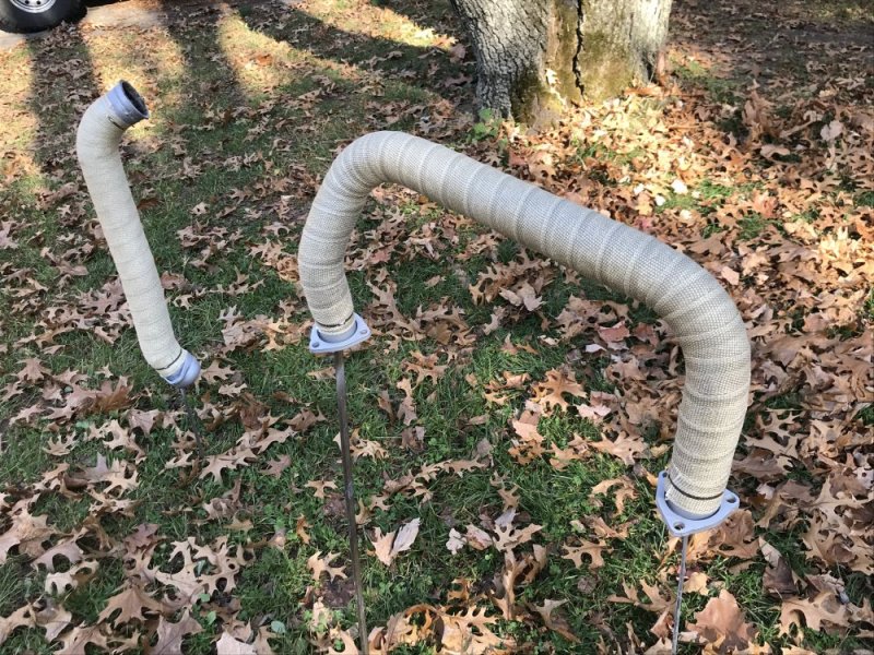

It was really nice out today so I took advantage of the warm temps to take care of a few things.

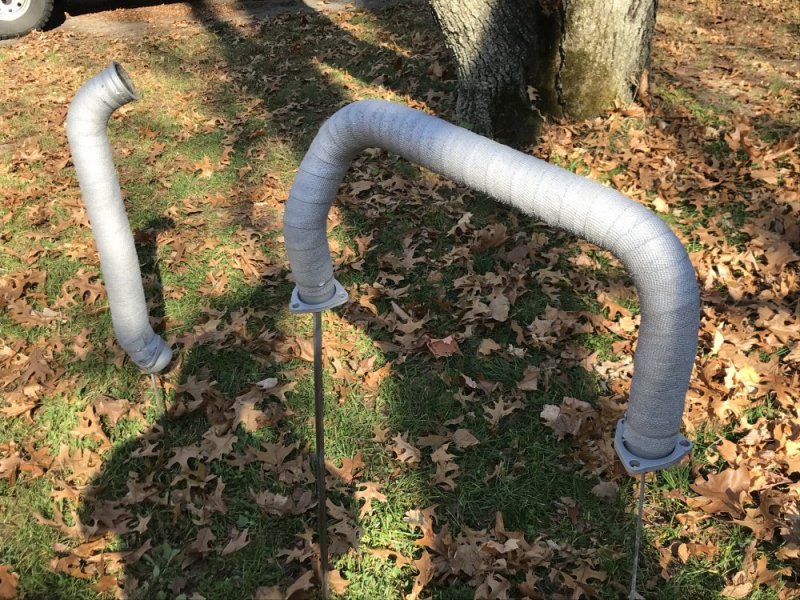

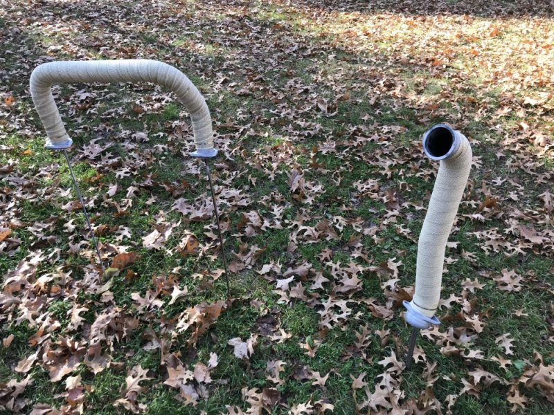

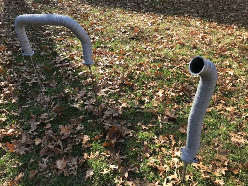

The wrap on the crossover got damaged when I was sandblasting the Hoe, so I removed the old wrap, wire wheeled it, repainted it and then wrapped it again. I didn’t have wrap on the downpipe before, but figured it would help to keep some heat out of that region so I also painted and wrapped it.
Then a couple coats of DEI paint to seal their wrap.

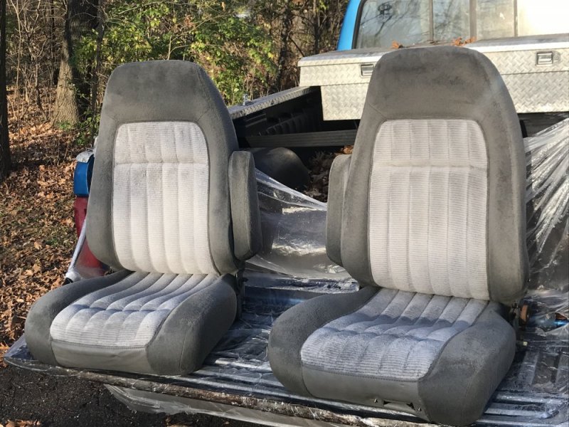

Then I moved on to cleaning the seats. They didn’t look terrible for light gray seats that are 26 years old and have 250,000 miles on them, but they were a bit dirty.

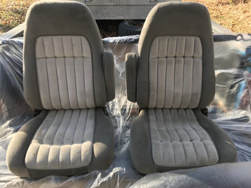

I soaked them with Folex and scrubbed them with a brush like I did with the carpet. Then I rinsed them off with the garden hose - the water that came off of them was nasty!! They turned out pretty nice, now they just need to dry.

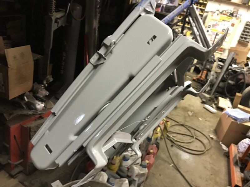

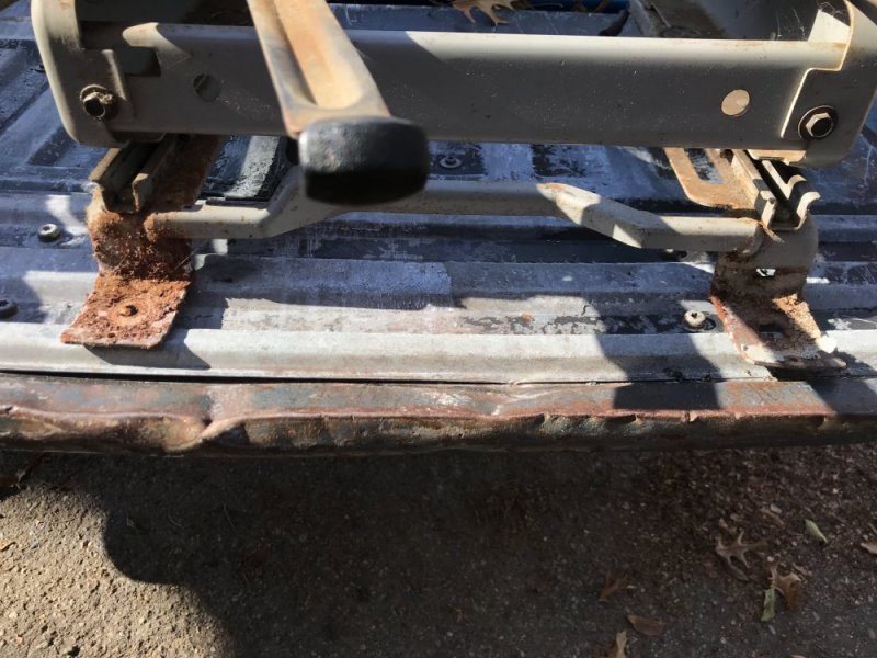

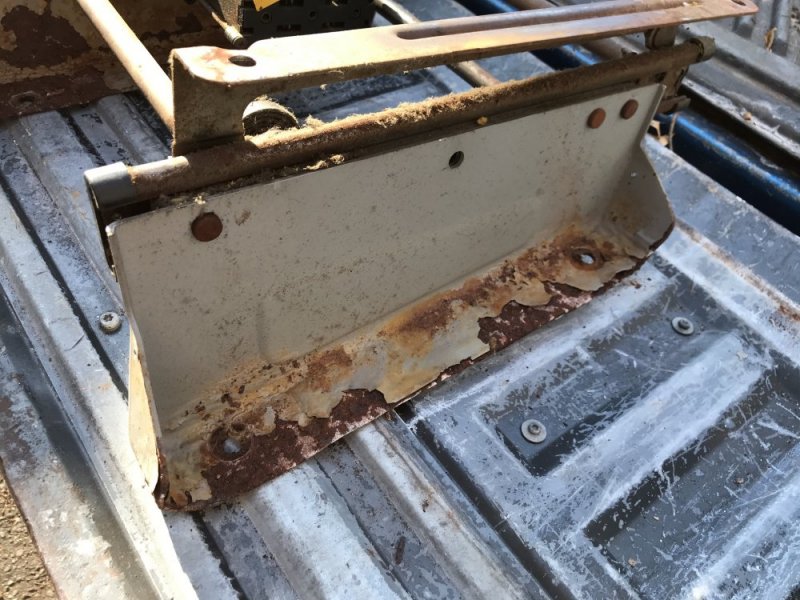

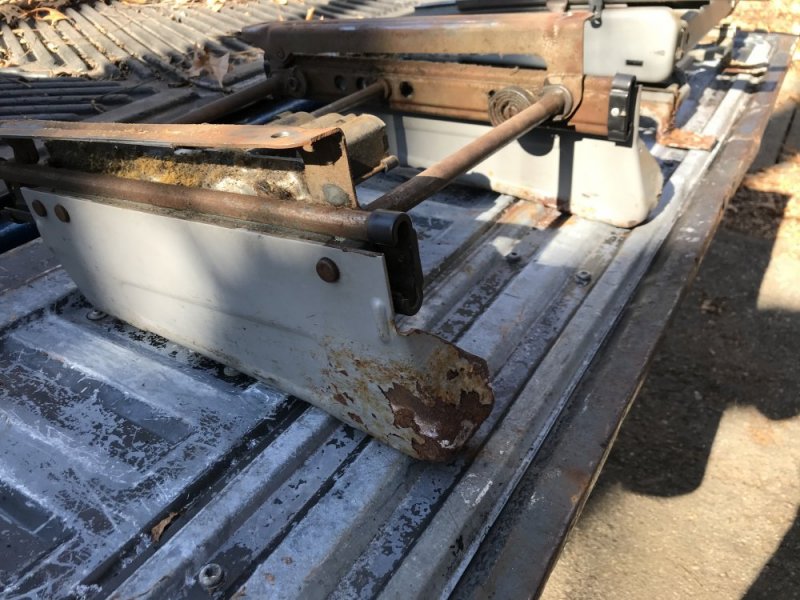

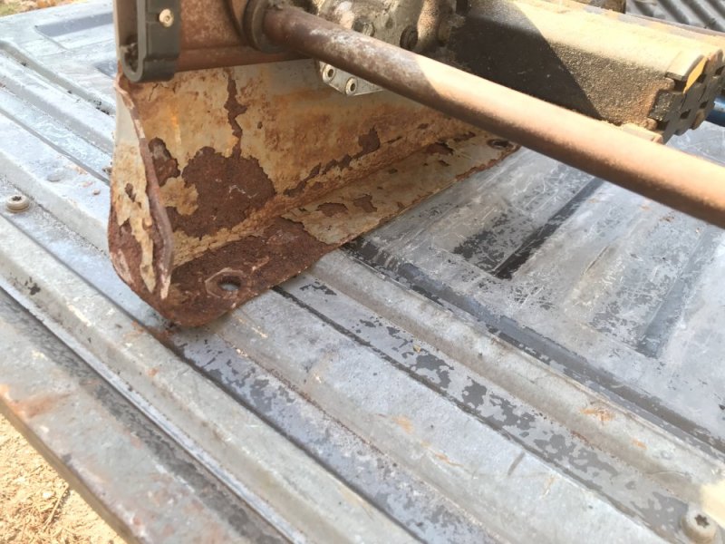

The seat adjusters were hella crusty and I didn’t like the idea of them being in the interior like that with everything else looking good, even though they wouldn’t really be seen, so I removed them so I could wire wheel them and paint them. Here’s how they looked before.
69902486-B1C0-4CD2-B0EF-3C0BE0216B03.jpeg479127A8-35FB-4260-853B-3E3EE5EDBE82.jpegC600F98E-ED39-4D7B-8AAE-FB62451C805F.jpeg6526BAF8-5620-43A2-837C-2207A0C12C2F.jpeg

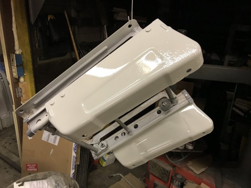

A coat of Rustoleum gray primer and a couple coats of Rustoleum Thunder Cloud gray and they look much better. Please excuse the mess in the background - the barn is a disaster area with 3 trucks taken apart in here 😣

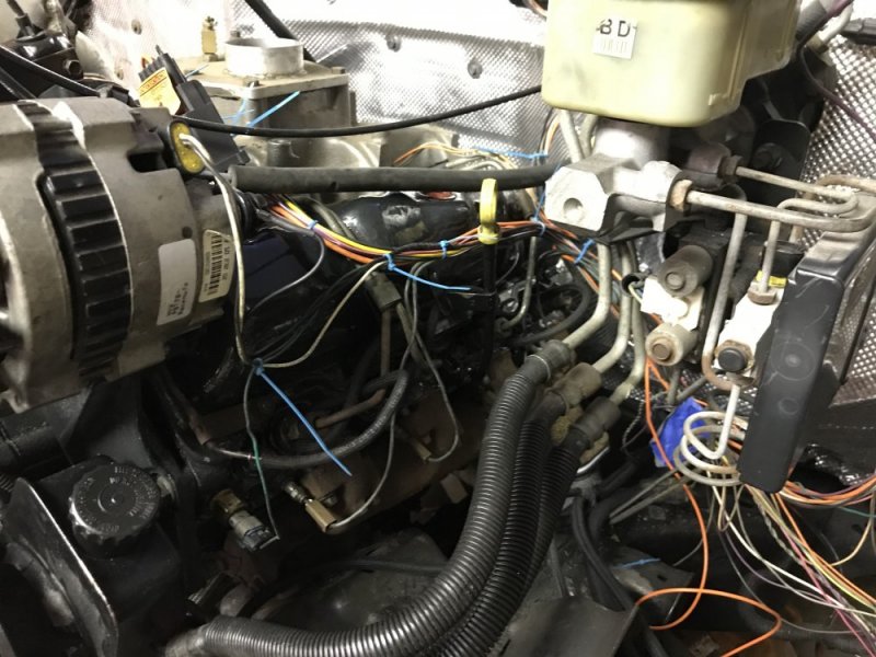

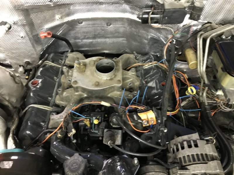

I have most of the engine wiring to my liking. The main thing left is wiring up the lift pump circuit, once that’s done I can terminate wires in the bulkhead and feed through the firewall.....cover it all in loom and then it’s on to the dash side.
