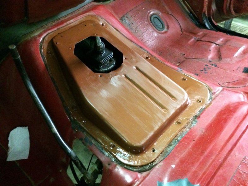

Primered the trans tunnel to prepare the floor getting coated in bedliner. I also accidentally primered part of my barn floor :mad:

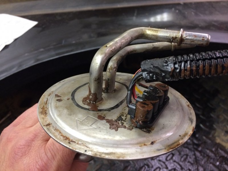

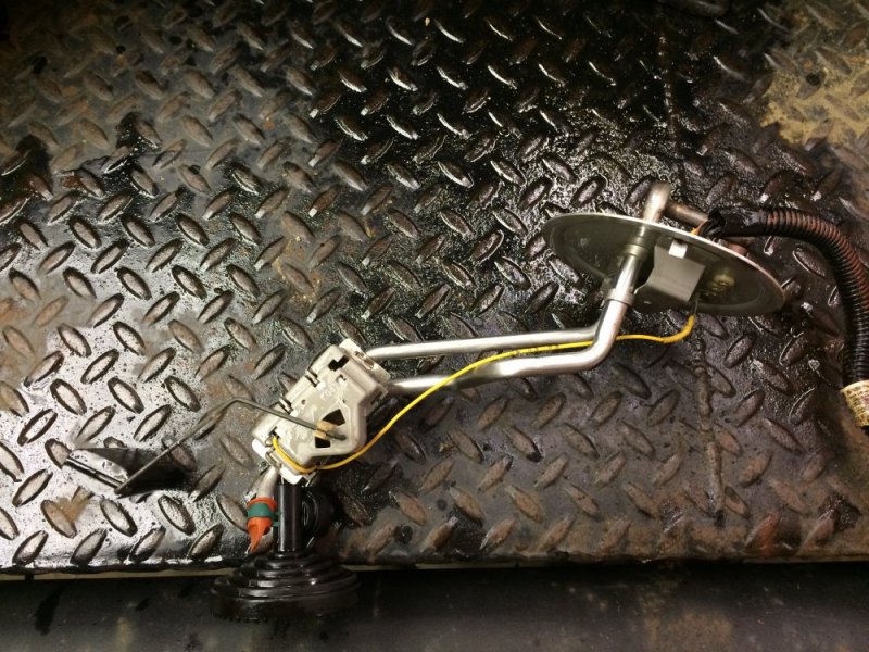

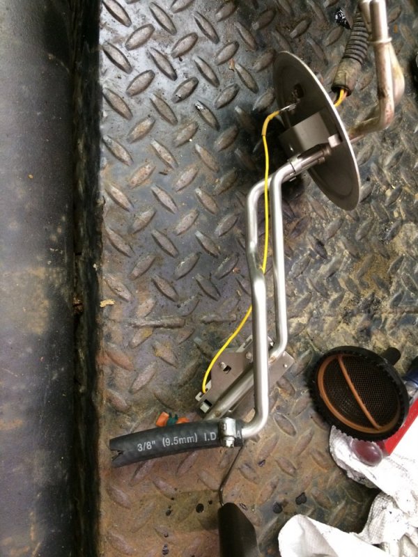

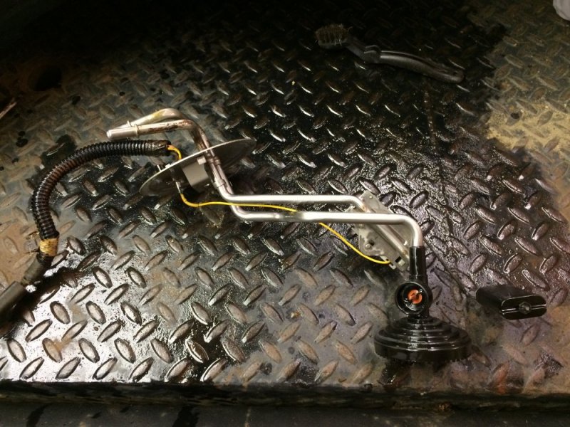

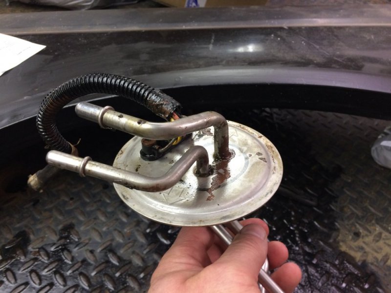

I then decided to pull the fuel sending unit out of the tank after WW's comments and knowing that it's a typical problem area on these trucks. Well not only is it not the problem, but it's also in better shape than most!! Typically that shower head looking pickup is rotted off of these. Even so I'm going to mod the pickup so I don't have to worry about it failing in the future. Time to start rigging up fuel lines at the IP so it will run on a 5 gallon can I suppose. IMG_8469.JPGIMG_8468.JPGIMG_8463.JPGIMG_8464.JPGIMG_8466.JPGIMG_8467.JPG
What kind of lift pumps do these have if any? Every inch of line is suspect.
They have an engine-driven mechanical lift pump that is driven by the cam - just like any old-school gasser engine. Not ideal obviously. I am suspicious of the lift pump, but rather than throw more money at it I will try to methodically test each component and narrow down where the air is getting in.

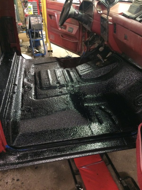

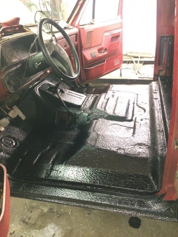

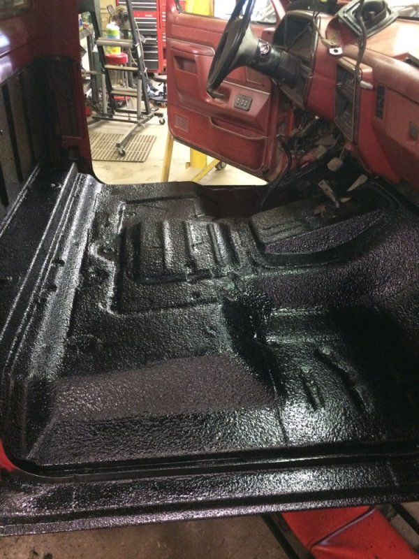

I got three coats of Herculiner on the floor of the cab. It's still pretty wet in the pics, but you get the idea. I had been thinking about doing this on the body too, but now I don't think so. I'm looking at the John Deere Blitz Black now instead.
I also started troubleshooting my air instrusion problem. I first tried running the fuel can straight to the IP, but it just wouldn't fire. I tried getting it primed, but it just wouldn't go. So instead I bypassed the filter housing and ran the lift pump straight to the IP. The lift pump is still drawing from the truck's fuel tank. I also have the return to the fuel tank bypassed - I have the bypass line run to the can under the hood. This configuration seems to have made an improvement so far. I've let it sit for over an hour a couple times and it starts better than it had been. Oh I also did the mod to the fuel pickup so I don't have to deal with that in the future. If it starts well tomorrow after sitting overnight then I'll start adding parts back in the system and see what one adds the problem.

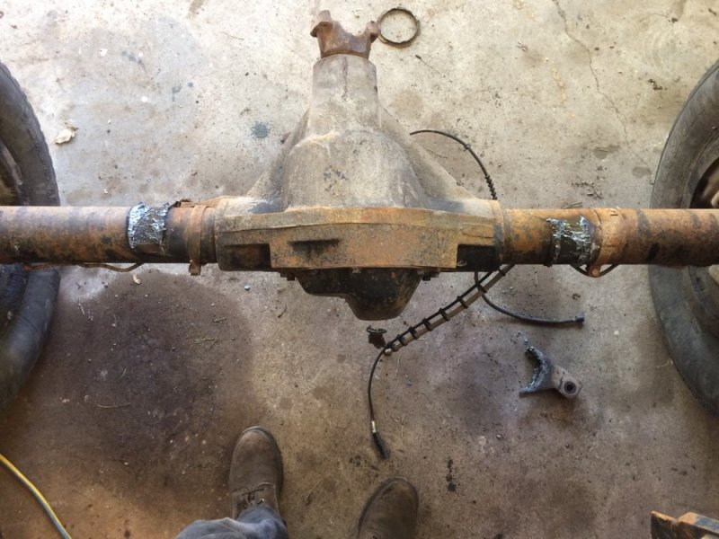

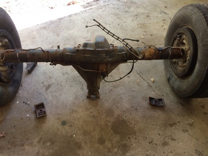

Finally I started working on the Dana 80. I got it dug out of the stash and then cut the old spring perches and shock brackets off. Still a bit of grinding to go....

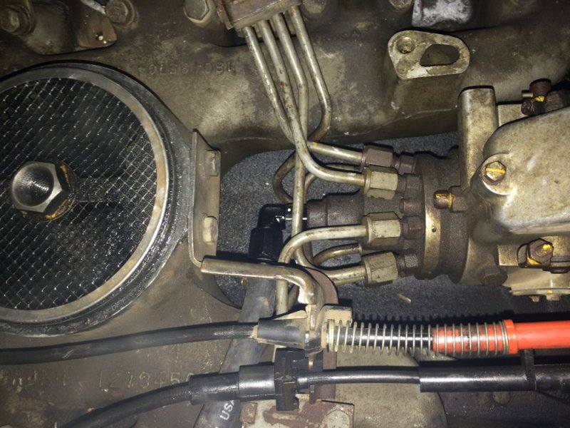

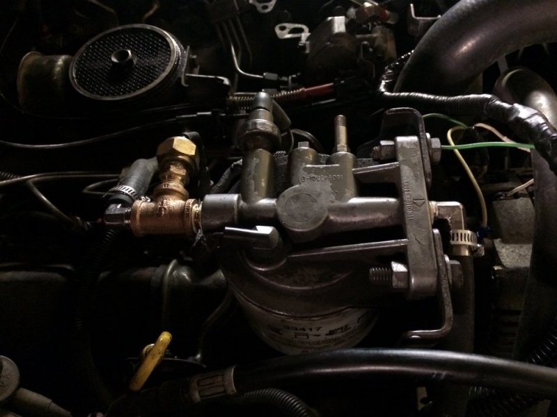

The truck started up well after sitting overnight so I decided to plumb the filter housing back into the fuel supply. If it keeps working well, then it was either the connections at the filter or IP or it was the strainer on the sending unit. If it acts up again then I'll start probing the filter housing. The heater sounds to be a typical problem for air intrusion. Oh I also plumbed in the sending unit for the old fuel pressure gauge that came out of the Tahoe so I can add that in soon.

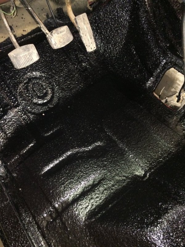

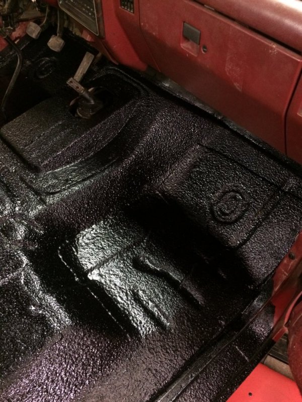

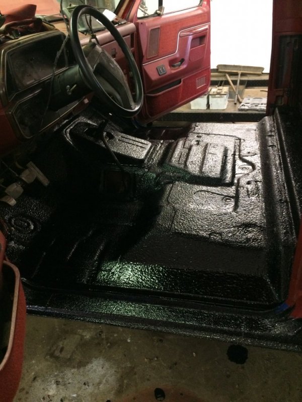

I also took some pics of how the floor looks after 2 days of dry time.
