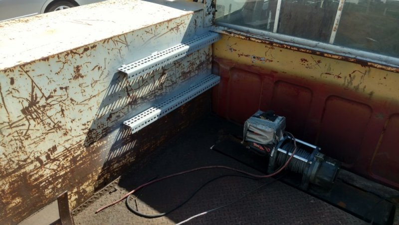

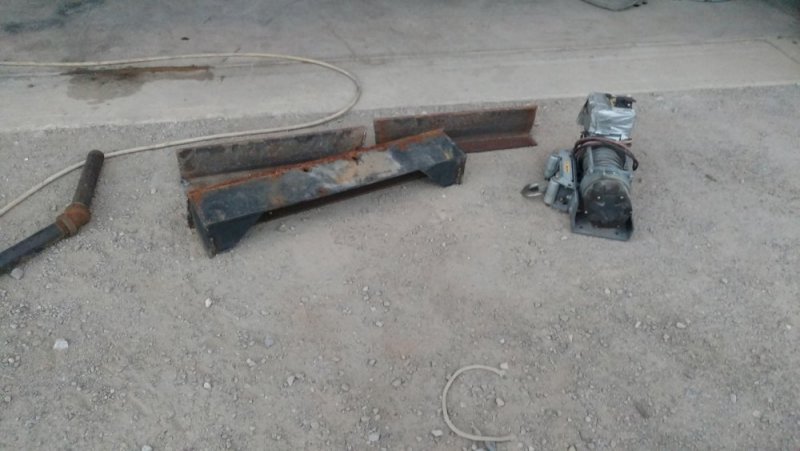

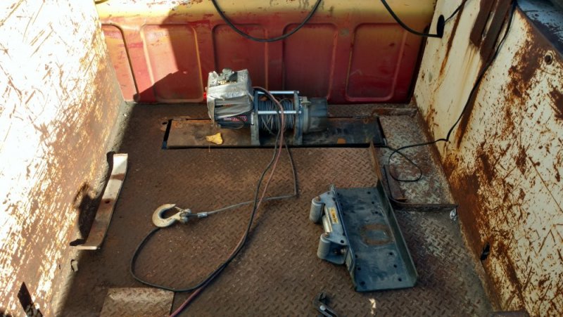

Took long enough for me to get around to installing it but the bed winch is now mounted. Don't need the fairlead on this bed since the bed sides (even after they get cut) will be taller than the winch. Gonna look into moving the solenoid box to a spot out of the bed where it will be easily accessible. After I initially cut the hole I noticed that the front of the bed was not centered. Little more cutting and some work with the portapower to shift the bed and that's fixed. Pic is from before, no after pic currently.

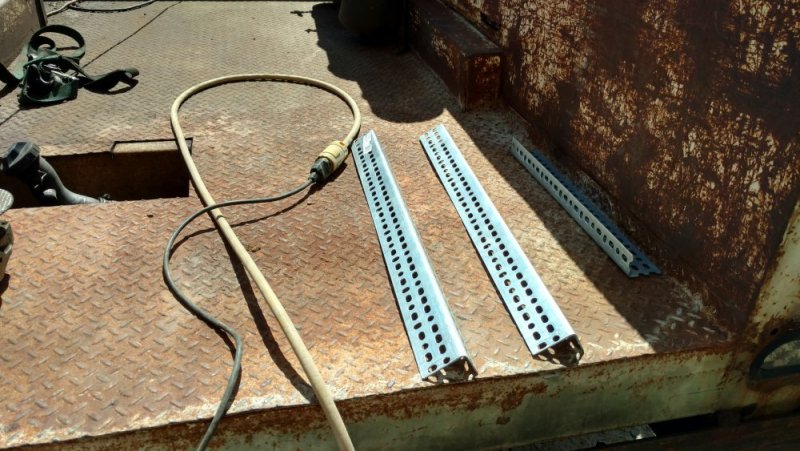

Running some of that 3x5x5/16" angle iron to serve as the mount for the bed and winch. Welded to those, bolted to the frame. Waiting until the new bit comes in for the mag drill so I can finish drilling those frame mounting holes (through the angle iron). While waiting for those went ahead and removed the air tank. While in Moab the tank developed a leak in the bottom of it (rust) so will have to go with a different air tank.

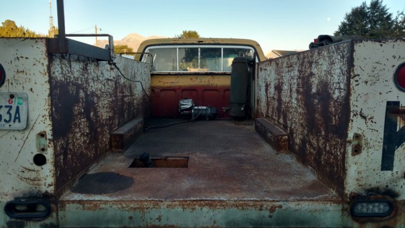

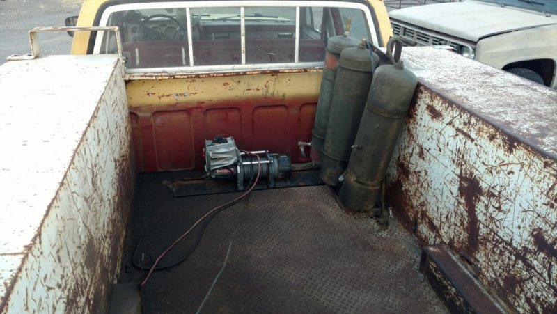

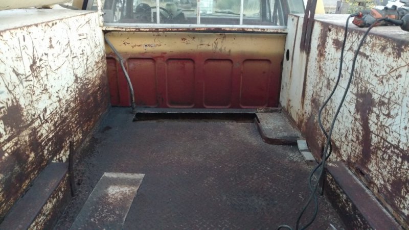

Doing some test fitting and design layout at the front of the bed today. Can't find a hydraulic tank that will fit well enough under the front of the bed so considering placing it on the opposite side of the air tanks. Came to that realization after these pics were taken and decided to move the 3 tanks over to the driver side. The winch solenoid is going onto either the top or front of the box where it will be accessible from outside the bed.
Going with 3 tanks since the 2 that were on the flatbed just wasn't enough capacity with the current little electric compressor. Won't be as much of an issue when the other compressor gets plumbed in.

When you plumb it in good extras are: finned copper lines to cool the air. Water seperating unit. drain at each tank.
Biggest lines possible that connect the tanks. Speed of air flow through tanks helps tools work better.
What are you using for compressor unit?

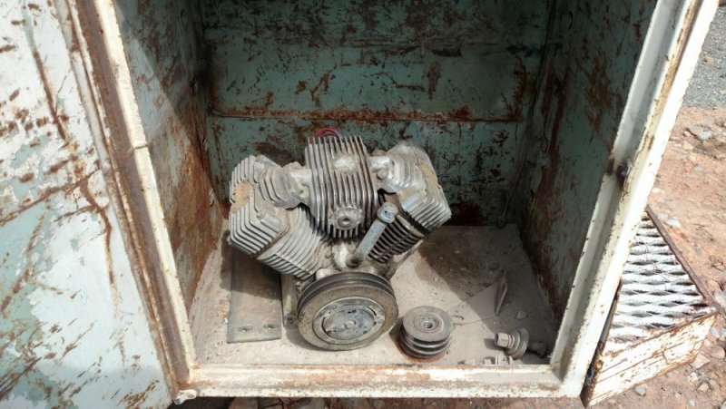

Right now? A tiny little Viar 88p compressor. I have 2 engine driven compressors sitting here that I can go with. One is a spare from my old m35a2 that is a dual piston rated for about 8cfm with a nearly 8" pulley. The other is this 4 piston guy that came with the service bed
Basically I bought a compressor and got a service bed with it hahaha. That thing was bolted to the engine of the truck that this bed came from, which took up alot of the engine bay.
I'm thinking of mounting the big compressor on the bed and drive it with a small hydraulic motor (truck has a PTO waiting to be installed for driving a hydraulic pump).

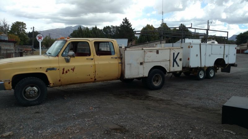

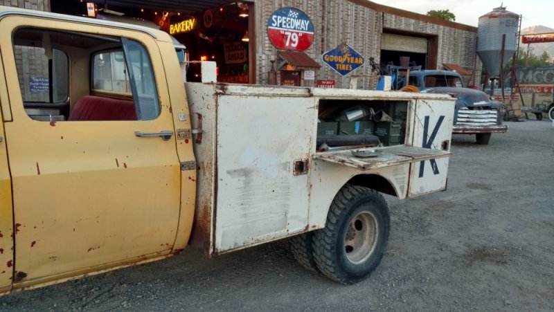

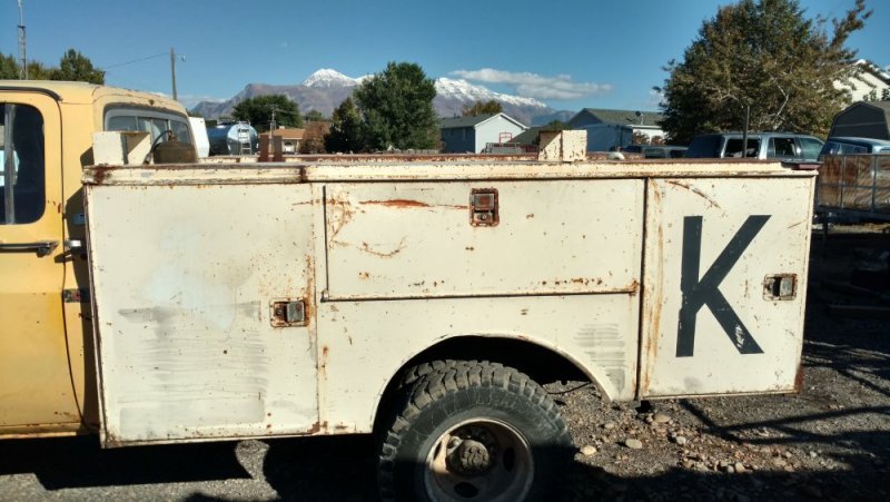

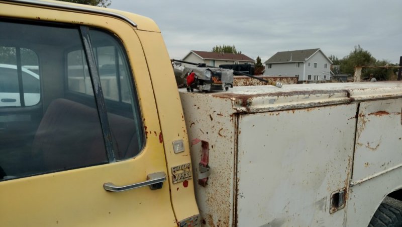

Speaking of service beds, picked this up today for cheap. Yes too small of a trailer for it (strong enough just tiny) but local haul and the planned trailer was occupied. Bed is 11ft long so will be going onto a trailer chassis but has a few benefits, mainly that it's large enough for all my tools. Which will lighten up the pickup and remove the need for a service bed on it.

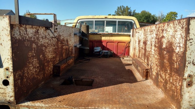

Been fighting a cold this last week so haven't been that active. Made some progress today though with the air system after getting most of my tools out of the truck's service bed. Need to order up some more fittings for the other 2 tanks to get everything taken care of. Planned plumbing is:
1 typical QD per side of the truck (so 2 total). At the top/front of the bed.
1 inlet for the small electric Viar pump.
1 inlet for a belt driven pump.
1 outlet to be plumbed into the suspension helper bags later.
1 outlet to the trailer.
All 3 tanks tied together at the bottom, and run out to a 1/4 turn ball valve to make for an easily reached drain.
Nice find.
Thanks. It will be nice having the vast majority of tools off the truck again and all in one area.

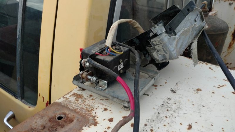

Good progress today. Started off by mounting up the bed winch solenoid to it's permanent home. Easily accessed when needed. The plastic housing has certainly seen better days yet it keeps on working haha.

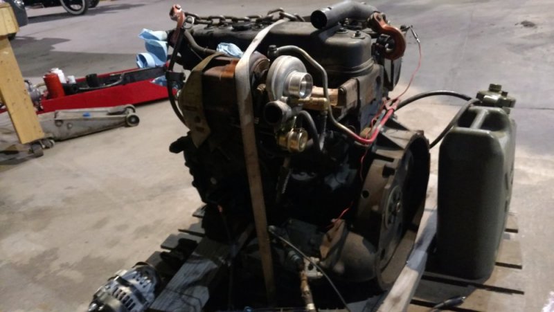

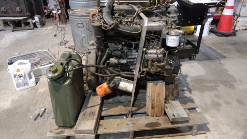

Spent the new few hours cleaning up things at the lot to gain access to the rear of the storage trailer (leftover scrap metal and random lumber). Dragged the Isuzu 4bd1t out of the trailer and brought it into the shop. Hasn't been started in about 3 years if I remember right from the previous owner. Rigged up a battery, remote starter, jumped the glow plugs, and primed the fuel system (hand pump didn't work so filled the fuel filter). Cranked it over twice at about 15 seconds each before plumbing in/priming the fuel system. Cycled the glow plugs for 10 seconds, bumped the remote starter while holding the throttle at nearly wide open and....
Fired right up within a few seconds of cranking. The exhaust (black) smoked me out of the shop actually hahaha. Later starts resulted in no smoke out of the exhaust. When I traded for the engine I was told that it had blowby issues. With about 1 minute of total run time so far I haven't seen any smoke out of the breather yet, will remove the oil fill cap on the next test run to check there.
Have to keep my hand on the throttle, it's bringing the RPM's down too far and won't idle. Runs good at above estimated idle RPM but right around where idle should be it gets a bit rough and has a slight miss till it stalls out. Thinking most likely an injector problem.
