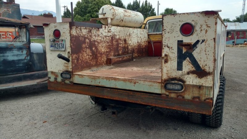

Couple things done to the truck bed lately. rigged up a fuel filler neck and will eventually get it cut down flush with the end of the box. With its location the options were to either go through the box, or cut through one of the beds main crossmembers. Due to the 9ft length of the bed the stock rear bumper could no longer be mounted properly so finally got rid of it. The total length is actually just about the same as where the stock bumper ended. Attached a piece of 3x5x5/16" angle iron to serve as the basis of the rear bumper. Removed the tailgate since it can't be there with the tail roller plans. Also mounted the lower reverse lights, and am planning to mount the same oval style brake/marker lights next to them on the outside edge.

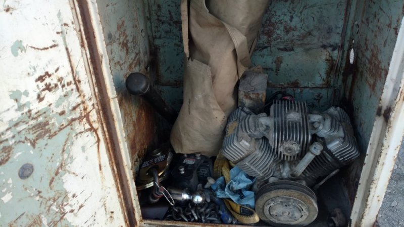

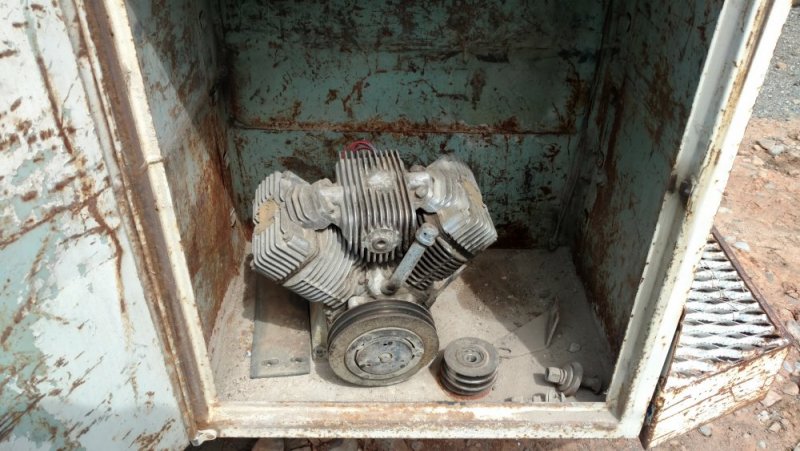

Being an old square body there is a decent amount of room for a CAC if that happens. Going the turbo route since it's cheaper and I already have plans for enough belt driven accessories (AC back together and a air compressor). For the air compressor I have 2 available. The spare one from my old deuce and a half, or the big one that came with the service bed.
Probably going to stuff that large compressor somewhere else and run it off the PTO for when I need lots of air haha.

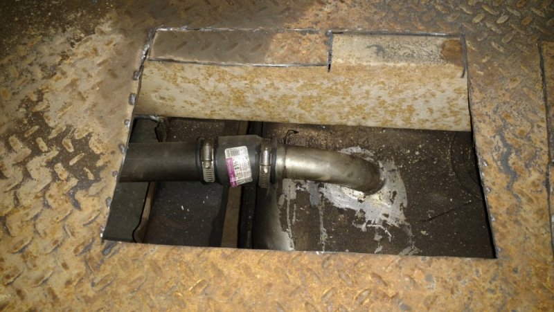

Second issue, the suburban fuel tank. Filling this thing has been giving me hell since it was installed. Figured it was sitting too high for the filler neck when the flabed was there as it would burp fuel out of the filler neck and sometimes through the vent. Has a new, clean vent line. When the service bed went on the fuel tank was lowered to where the bottom of it is even with the bottom of the hitch, and the fill tube routed through the rear box to a 90 degree fitting, then up at a pretty steep angle to the rear of the truck. Filling took roughly 2 minutes per gallon (timed on the phone) and it would still send fuel out of the vent line and drain on the ground randomly. Decided it might be the 90 degree at the bottom of the service box (to aim it at the rear of the truck) so removed it and installed a 45 degree upwards fitting, where the filler neck was inside of the rear box on the service bed. Basically, when filling the flow is down at a 45 degree angle for 18in, then raises to flat where it connects to the built in connection at the top of the tank making for as straight of a line as it could have.
Verified that the vent line is on the proper fitting when the pickup was installed in the suburban tank.
So, the suburban tank is coming out and will be lucky if it doesn't get used for target practice. Going to place that 60 gallon tank from the old dump truck at the front of the bed. Means I'll have to climb into the bed when filling up but at least I won't have to dodge fuel getting burped out of the filler neck.

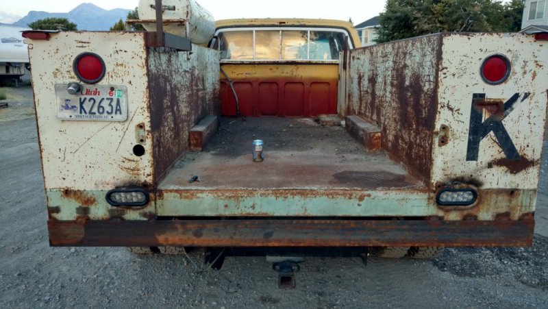

Pic of the last filler neck setup

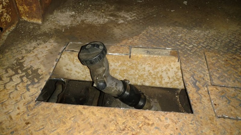

Going to give the suburban tank 1 final attempt, if the ****er burps diesel on me again it is target practice. Going to cut a access hole in the bed and modify the stock filler neck to be vertical. Where the can is sitting is basically the cutout location.

The tanks last chance was given today.
Zero fuel burps for the first time ever on this truck (even with the original saddle tanks). The old stock filler neck was temporary since I didn't have a short piece of pipe. 25 gallons pumped in with the fuel pump on the second notch. Will make that into a panel door and by using a short section of pipe the filler neck is short enough to hide. So for long trips only easily moved stuff can sit on the rear 1/3rd of the bed to maintain easy fuel access, but at least the damn thing works for once.
