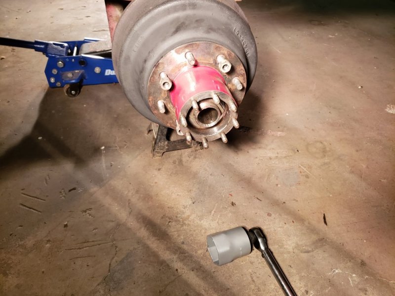

Struggling finding a "non" rounded 6 point hex spindle socket that is thin walled and 1/2'' drive. Ones I have found are $50 and up! NAPA only had rounded style sockets that are not correct for my application. Ordered one off Amazon Prime today along with a 1/2'' to 3/4'' drive adapter so I can properly torque the rear axle nuts. My impact socket will not fit within the snout of the hub.

Finally got the axle socket in. Stupid thing was a nightmare to get! All the sockets at local stores were rounded.

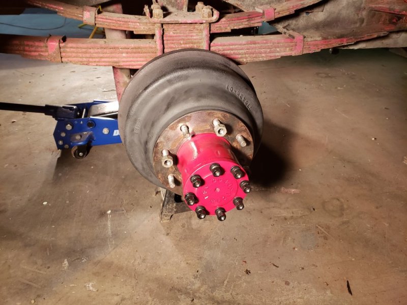

Finally made some progress. Got the passenger rear torqued as specified. Torque to 50 lbs, back off 1/4 turn, install lock washer and torque outer nut to 150 ft lbs. Got the axle shift back in as well.
Drivers side not so much luck. Turns out the lock washer was shot. Mainly the tab locking the washer to the snout. Also in my prep for the temporary ford alloys I need acorn style lugnuts. Will also need to confirm that I have enough stud protruding from the thicker rims.
