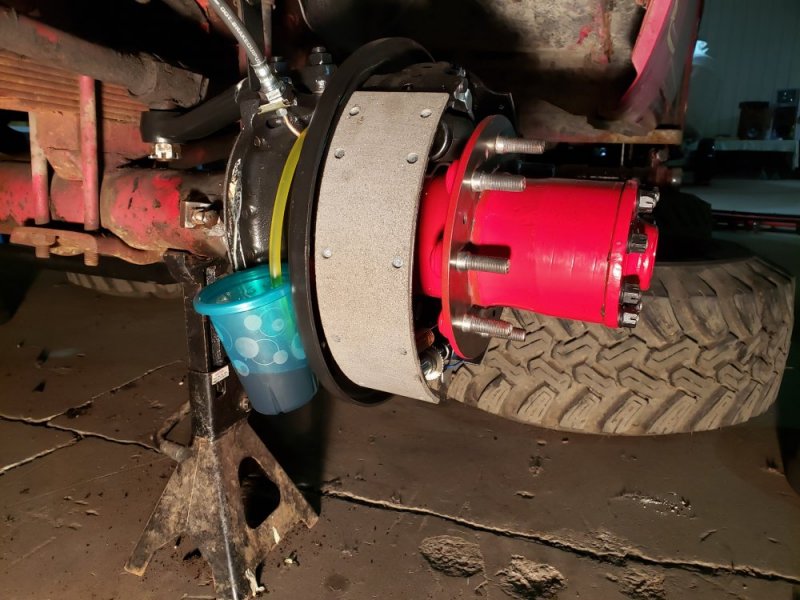

Is there a ⁷/¹⁶" female x ⅜" male bushing you could use to reduce the fitting size and avoid either waiting on new w/c's or making new lines with 3/8" fittings on the ends?
I think I do know that unforgiving individual.....
Def a good idea that I didnt even think of. Luckily I already placed an overnight order from RA for the correct ones to be here by 10:30 tomorrow. I tried NAPA, Advance Auto and Autozone with this part being special order due to the 7/16 fitting. They had 3/8 all day long.
Trying to get this done prior to installing the rear drums, axle nuts and axle flanges. Lots of work to pull off again. Gonna be a late night tomorrow......
Last night was a joke...
Found out my rear WC are wrong. 2 options at RockAuto and I got the wrong once. Didnt realize till now I need ones with 1 & 1/8 bore with 7/16 fitting. I got 3/8. Would have been nice if RA notified the buyer of different sized parts under the same listing.

In reaching out to NAPA they only list rear WC's in the 3/8's flavor with 7/16's special order. For them to get the Wagner part would have taken a week from Omaha, NE. I also looked at Autozone who has both sizes listed for my truck but the 7/16's is special order.
My feeling is at least RockAuto needs to list the fittings size on each WC when you hit info. I did see several parts were lacking that information when selected. I may have had a chance in picking up on it if this was the case.

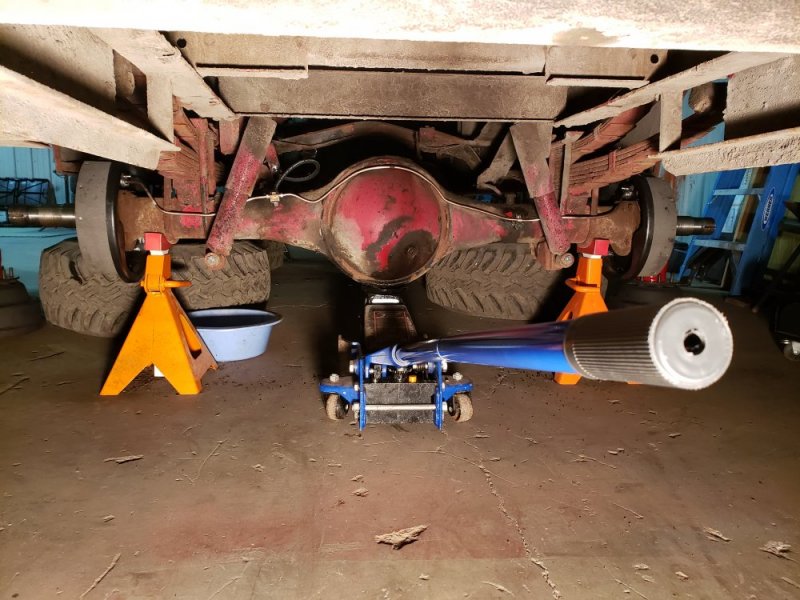

Ended up installing the new ones from RockAuto I overnighted. Truck is rolling. Need brakes adjusted and I have a leak somewhere now.
Thanks for the help!
Well, now that everything under there is cleaned up and pretty, it should be really easy to see where the leak is coming from. Most likely from a flarenut not tightened down enough (and hopefully NOT cross-threaded) and not one of the old lines that wasn't replaced giving way. Besides, who needs brakes when you have the wall of the shed to stop you? :joyful:
Stewing on it overnight I think Its the connection at the block on the axle. We will see next time I go back.

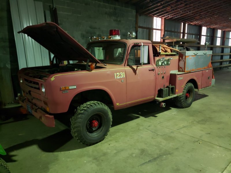

I would not paint the truck, the faded red looks cool imo. But the box on the rear fender could use some red primer or something to match the faded red.
I really want to leave it faded as well. Would love to clearcoat it just the way it is. Agreed on the side cabinets. They are SS and the paint obviously didnt adhere as well.
