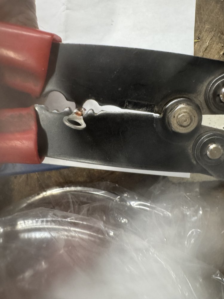

The only way I use that type of terminal is to grip the metalic part of the terminal with pliers, then another set of pliers and pull off that insulator.
Then I have a crimp tool that has a sort of a punch on it.
With that tool I cave against the wire right where the seam is on the terminal, then cave the other half of the seam down against the first cave in. The terminal is then soldered to the wire.
When I get out to the garage I’ll pic the process.

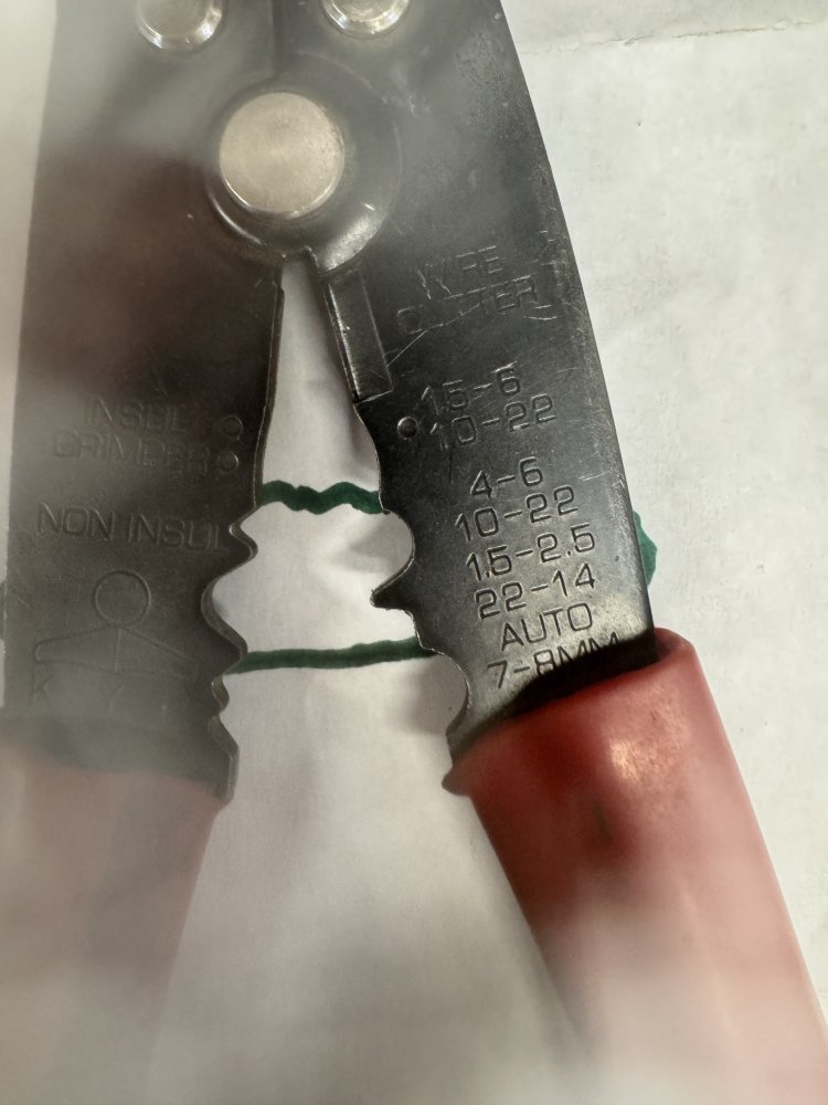

These are a pair of the automatic stripping tool. The point and the U is where I do all My crimping.
Locked in for the first smash over and it is smashed down.

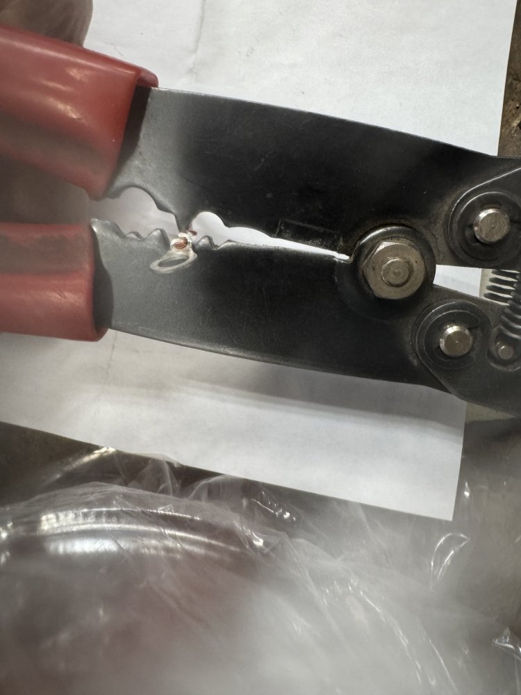

Second smash over and it now is ready to solder.
If insulation is desired, slide a piece of heat shrink over the wire before crimping/soldering the terminal to the wire.

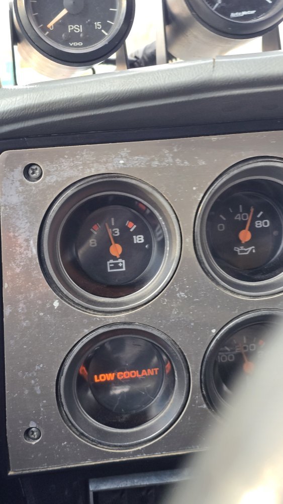

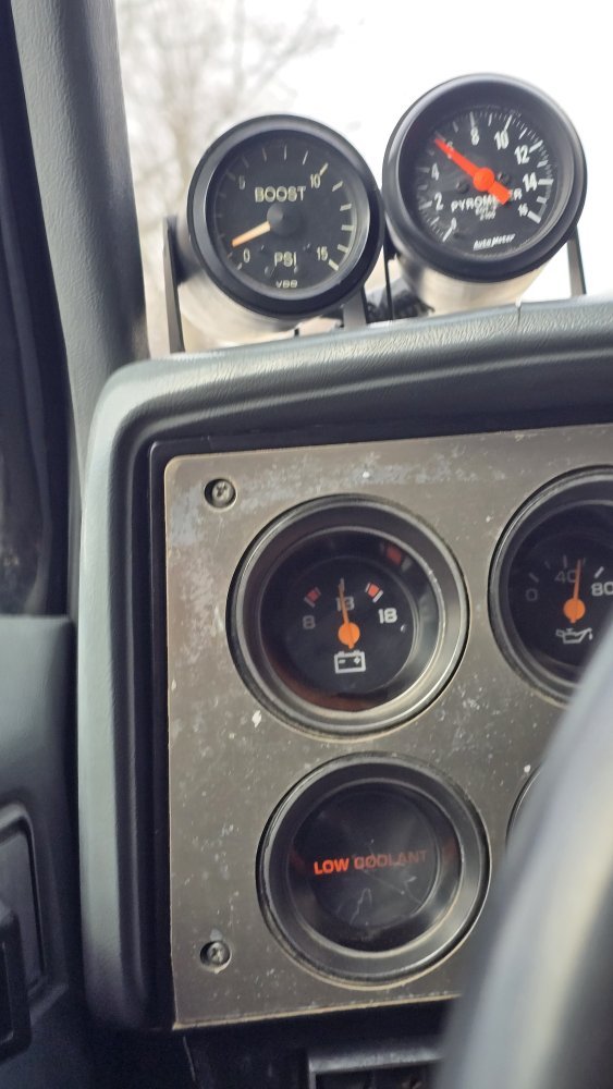

Left it alone for an hour or so, didnt plug it in (32°F here) and it actually fired up, didnt hesitate or show signs of struggle.
Still, its been that voltage at idle (granted heating is on blast), second pic is voltage while on the interstate (headlights and heating on).
Should I test the alternator and batteries tomorrow? Or am I just overthinking it?20260203_152839.jpg20260203_131753.jpg

I use some volt meters that plug into the cigarette lighters
it's possible that the main power line going into the cab is not handling the draw. check voltage at the battery and then again at the cig lighter plug. if you get different reading with everything on (fan, lights etc ) then it's the small gauge wire GM used to power the entire cab.
I need to beef that up on my son's truck. battery voltage shows 13.5 but with the heater and lights on, the gauge shows it at or below 12v. GM pinching pennies using light gauge wires.
