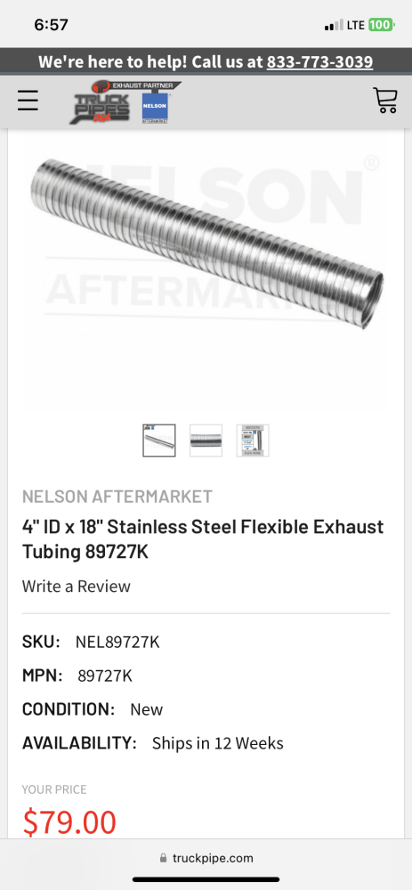

A random screenshot of the type of flex - I don’t know or recommend this company- just random example.
Do you think a short piece of that type of flex would be better than this?
I honestly don’t know which is best for which application. I know the type I posted is what Almost all semi trucks and heavy equipment use- and they last a lot of years/ mileage before having problems. When they do fail, replacing is easy with a cut off wheel to size the exact length you need. Then because I am overly picky, i use a 2” roloc sander wheel on the die grinder to eliminate sharp edges. Wrap the clamps around and get them close. Slip in the little seal part that goes near the bolts if that brand uses them and tighten the bolts. I don’t think I ever seen anyone use a torque wrench- usually just impact gun till it gets a couple ugga-duggas just alternate between the two bolts a couple times as ya go. The flex O.D. Is slightly more than the pipe, the band just conforms to it.
