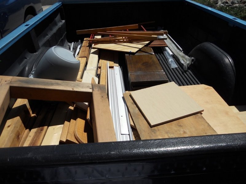

Hauled a load of assorted stuff in the bed of patch: Used it as a pickup Truck. :D Still have to unload it. :(
Ok, Ok, Ok. Pics or it didn't happen...
To unload (when it's NOT near triple digit temps outside) and next scrap metal run cargo needed to be loaded shown.

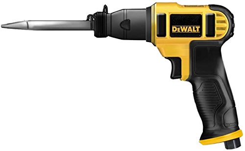

You will need an Air chisel and the special (or a good) spring compressor.
You use the chisel to knock off the mashed up part and it will come out easy. I forget the details about removing the spring. The new part has a retainer that slides over the top end to hold it in place. The Dorman Help section has these as well as the GM dealer (last I checked may be discontinued.) LMC Truck and Rockauto are worth a look.

Oh, I have a good (15 gal, 6.3 cfm@90psi) compressor and a medium duty air hammer with various chisel and punch tips. I suppose one could also grind off the factory peened end, too.
