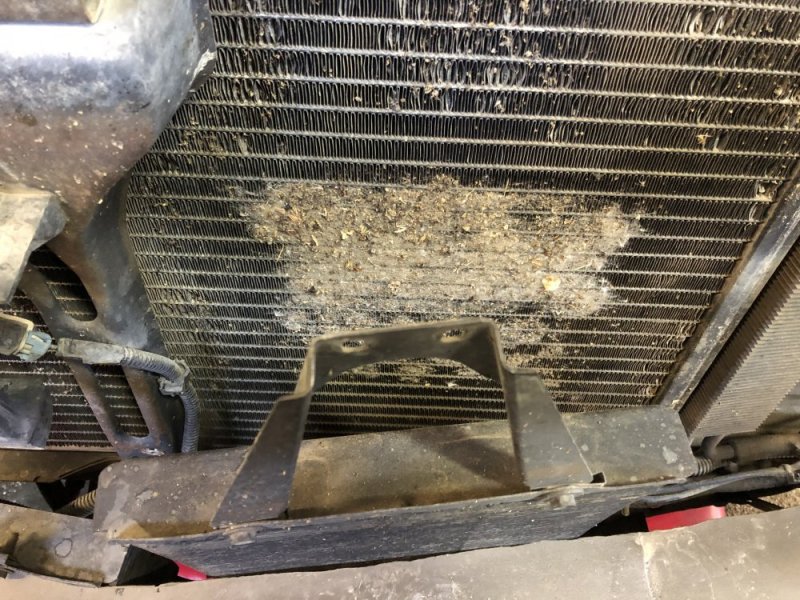

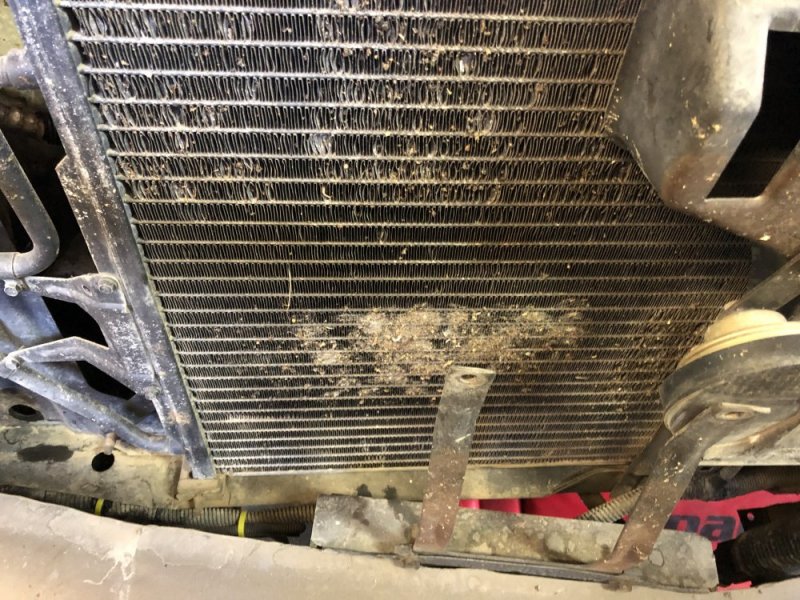

Also pulled the grill and moved the two oil coolers out of the way. Have a little cleaning to do there.
I made a blower tube to clean out all that junk from behind each component. It is a brake line about 20" long with one end crimped over and a small hole drilled near it, at the other end is an air line connector soldered to it and a slight bend to direct the tube when necessary...blowing out all that junk before it clogs up the works.
