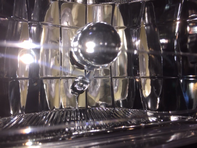

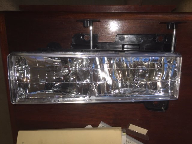

Try to find these headlight housings. The key is in how the deflector cup is constructed and where it attaches. In this one the metal for the attachment is vertically on edge and the attachment is below the bulb. Avoid the ones where the arm attaches above the bulb and the metal is horizontally on edge as the arm will heat up and droop down. Basically all of them are constructed like the latter and you have to pick through on e-bay or Amazon to find the right ones. Sometimes a batch of the right ones will show up, but they aren't always available. The bad ones are always available.

Husker, what are the specifics of the headlight housings and HIDS that you are using?

Mine are similar to (but not exactly the same as) these: Look at this on eBay http://www.ebay.com/itm/291250255183
True projector headlights use a parabolic shaped solid glass lens with a metal "hood" behind the back of the lens with another parabolic reflector behind the "hood" in which the bulb mounts so that it is at the focal point of the reflector. The light beam is concentrated past the hood which blocks half the beam and gives the distinct, sharp cutoff line for the low beam or fog light that does not dazzle or blind oncoming drivers or reflects off of the fog or falling snow/rain. The glass lens then spreads the beam out, the width dependent on the curve of the parabolic glass lens.
What @Big T is describing is actually a reflector light, not a projector. The metal cap keeps light from being directly emitted from the bulb out the front of the headlight, rather reflecting it back onto the multiple reflecting surfaces that shape and focus the light. That style is one step up from the standard incandescent sealed beam or Halogen capsule headlight as far as control of the light pattern goes. I did run aftermarket reflectors on my Burb briefly before upgrading again to true projector Low Beam headlights.
As far as the specs of the HID's I'm using, they are 55W 5000°Kelvin temperature (natural sunlight, or daylight) and my headlights are designed to use an H1 capsule in the projector Low position and an H3 capsule in the reflector High position.

Here's a close up of the housing showing the reflector cup with the mounting bracket that attaches at the botton and the metal is vertically on edge. These will not droop down. Also, more vertical hatchings in the mirrors, the better.
