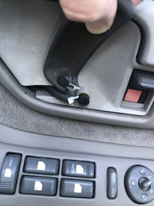

Ordered a new driver’s interior door handle for the Burb. 6* this morning and the sucker just snapped off!View attachment 55253View attachment 55254
Gone through 2 of them on the driver's side already.
This was a really common repair we did in fleet. We got to where we could Notice ones that were slightly bent. We would stock one in the parts room. If a person is at a junkyard wondering what else they could grab for $2 that might be worth a spare, start examining them and you’ll be able to judge which are not bending already.
The material used isn’t the strongest and is amplified by technique of opening the door we figured out. People that use right hand to pull handle and left hand or arm to push open the door never have them bend or brake. But many drivers (myself included) would push out with the left elbow while left fingertips pull out on handle. As the door opens the use of the arm as a lever to swing the door open maxes out the handle throw and applies pressure while the handle is pulled out causing alot more stress on it.
But it usually take about 150,000 miles worth of one person doing this to cause it. Kinda surprised I don’t hear more about it online.
Add in sticky doors from worn hinge pins and lock latches. Then you have to use left elbow and bump the door open. Yes, the first one goes at 150K. The second one will go at 200K, unless you fix the sticky door issues.

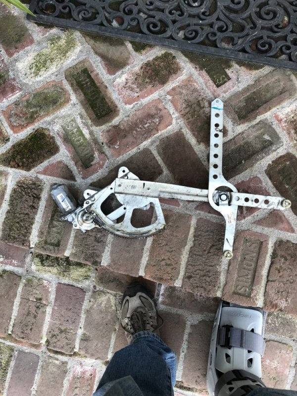

Alright I pulled the driver’s side window regulator and motor on the ‘99 and ordered a new AC Delco regulator and motor from RockAuto. Old motor was stripping internally. I am getting so proficient in removing door panels that I had both the outer and inner out in 12 minutes.

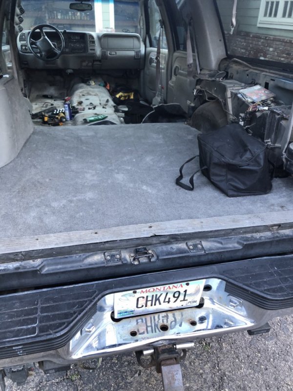

Haha, that’s how I ruined my wife’s suburban is a 6.5 being hauled.

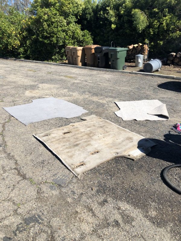

I’m replacing because of a quick stop from some dick cutting me off and in the process a 5 gallon jug of diesel tipped over with the vent open. Dumped 2.5 gallons of diesel and the only way to get the smell out was to replace the carpet.
