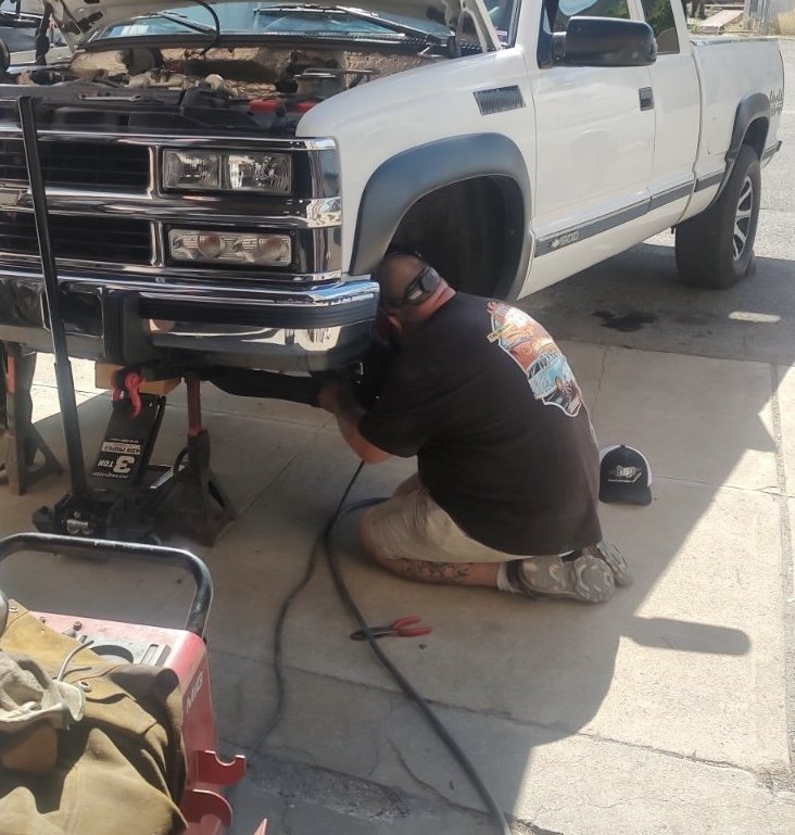

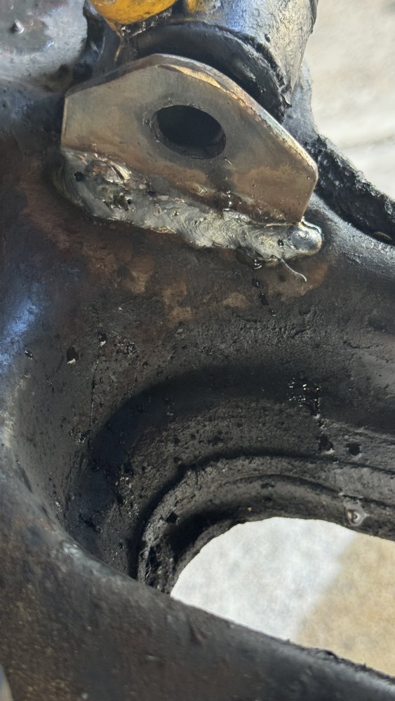

I’m welding on another heat sink mounting tab behind the front bumper, this morning, if the wind stays at zero. Then I’ll mount that heat sink and run the Stanadyne PD and hope it is a good one.
