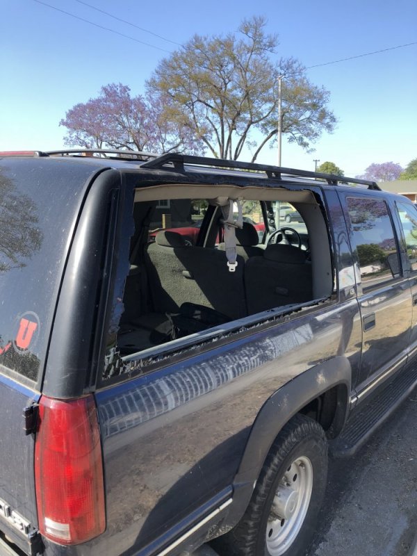

Sister put a rock through my right rear quarter panel window while using a weed whip. Cost was $225 which is below my insuarance deductible. She covered it and also got me a new windshield for $200, replacing the heavily pitted original which had a developing crack from a rock strike.

That sucks for sure I have been down that road before, I put a rock through the back glass of my Century Truck Cap a few years ago at my parents house while weed eating, there was about 10,000 pieces of glass. Insurance company was trying to make me pay a deductible, I said sorry Charlie there is no deductible on comprehensive coverage, it was not a collision. My Collision coverage has a deductible.
Stupid body shop had done an estimate on it and wrote it up as a collision, I educated the girl at the body shop what a collision was, be danged if the check I got in the mail was less the deductible after all... :mad: I picked up the phone and called my agent, she apologized and made the insurance company send me a check for the full replacement cost.

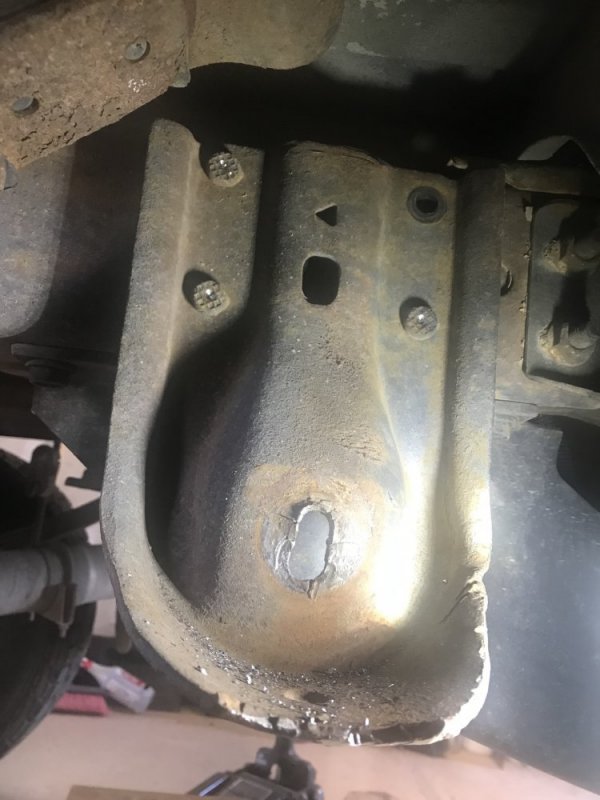

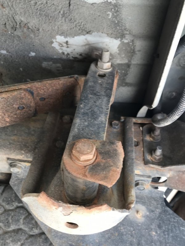

But, as I was cleaning up the gravel spilt on the parking pad I was looking under the truck and noticed something that didn't look right....Left side leaf spring shackle was busted and about to completely fail.
Fortunately, this had happened to the right side a few years ago so I bought replacement hangers for both sides.
Off with the old... Not sure why one hole was bolted but the others are riveted and don't like to come out. Lesson learned from the right side go round and drilled out the rivets in a three step process (no, drill slip, bang head and swear) vs. trying to chisel them out, grind the out, pound them out.... This time, drilled a small hole first, then larger hole and then 3/8 to match the actual size. Chisel out the rivet heads and pop the thing off.
As you can see, this thing was just waiting for the right moment to bust out completely. I got very lucky with the gravel and paver loads not causing a complete failure. The bolt I pulled out was worn where it made the elongated hole to where it was pretty much fluted all the way around. Replaced it with a new M-12 10.9 grade bolt, nut and washers.

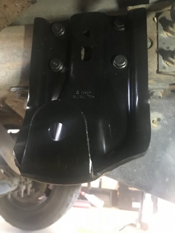

Attached the new hanger.
Mud wrestled the leaf spring back in to place and, bing bada boom, finished.
As per the norm, easier the second time.

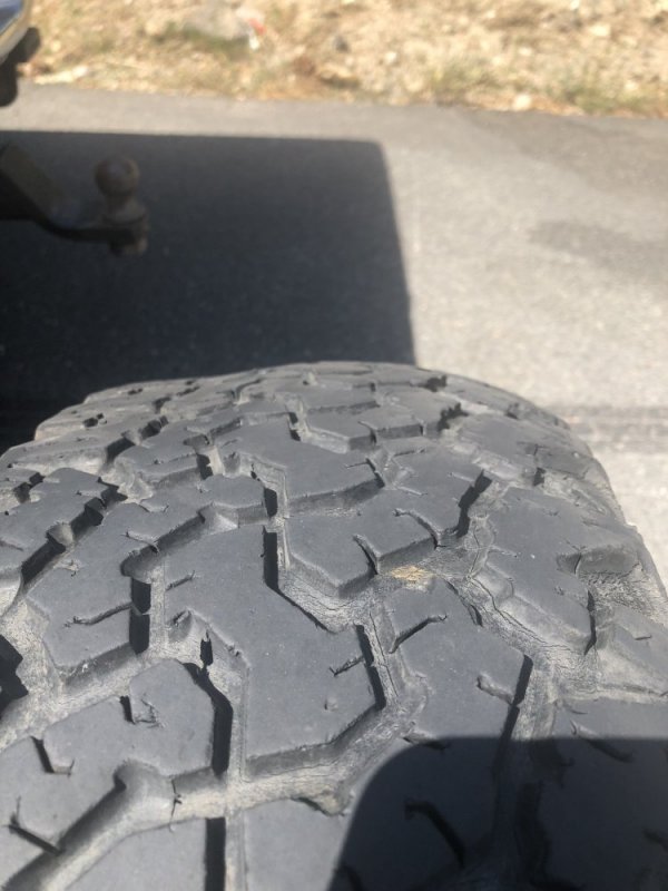

Had a BFG AT KO separate a belt on the way down from Big Bear Lake. Tire was old and I’ve been wearing them off on the rear. Also got into it with a Prius driver who pissed me off. New Cooper AT3s being order. Though I do have 3 old BFGs to wear off, they just don’t make it through summer heat.
