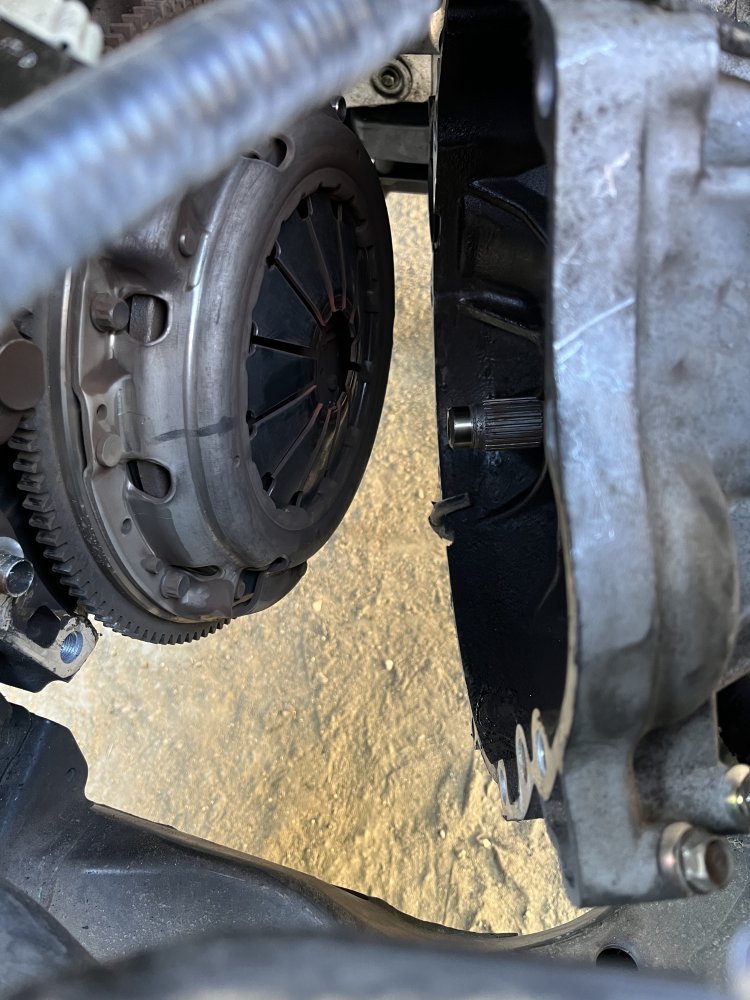

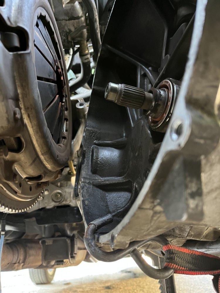

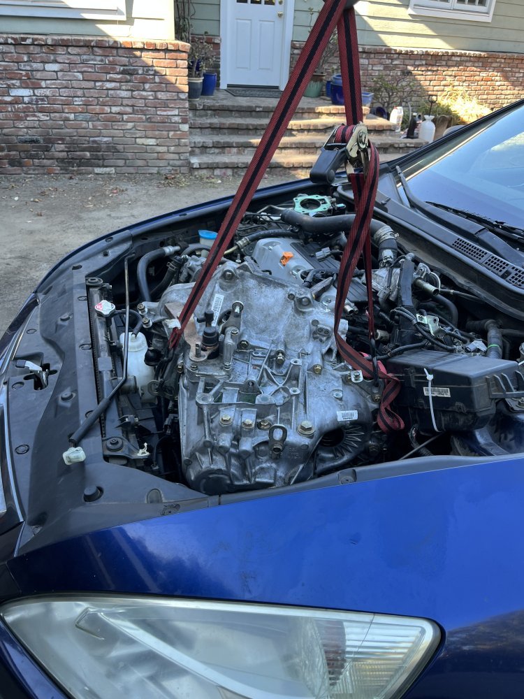

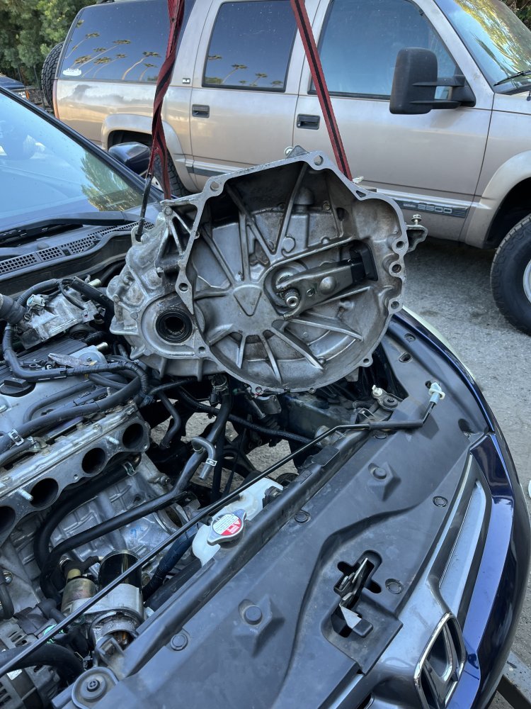

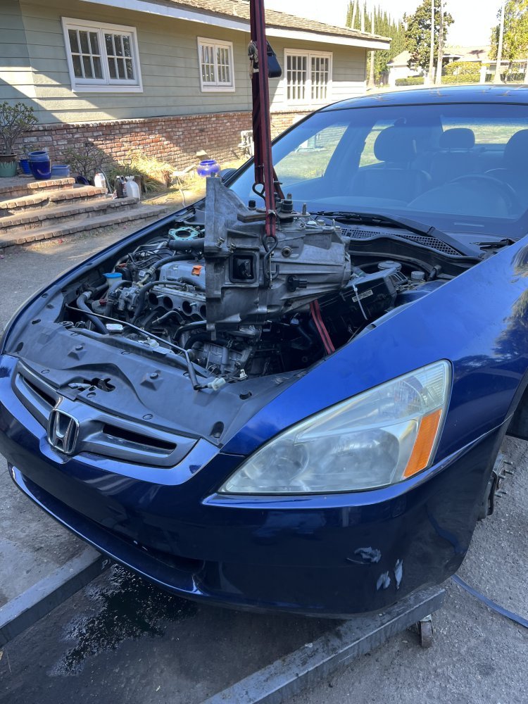

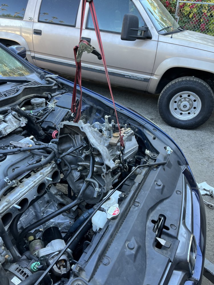

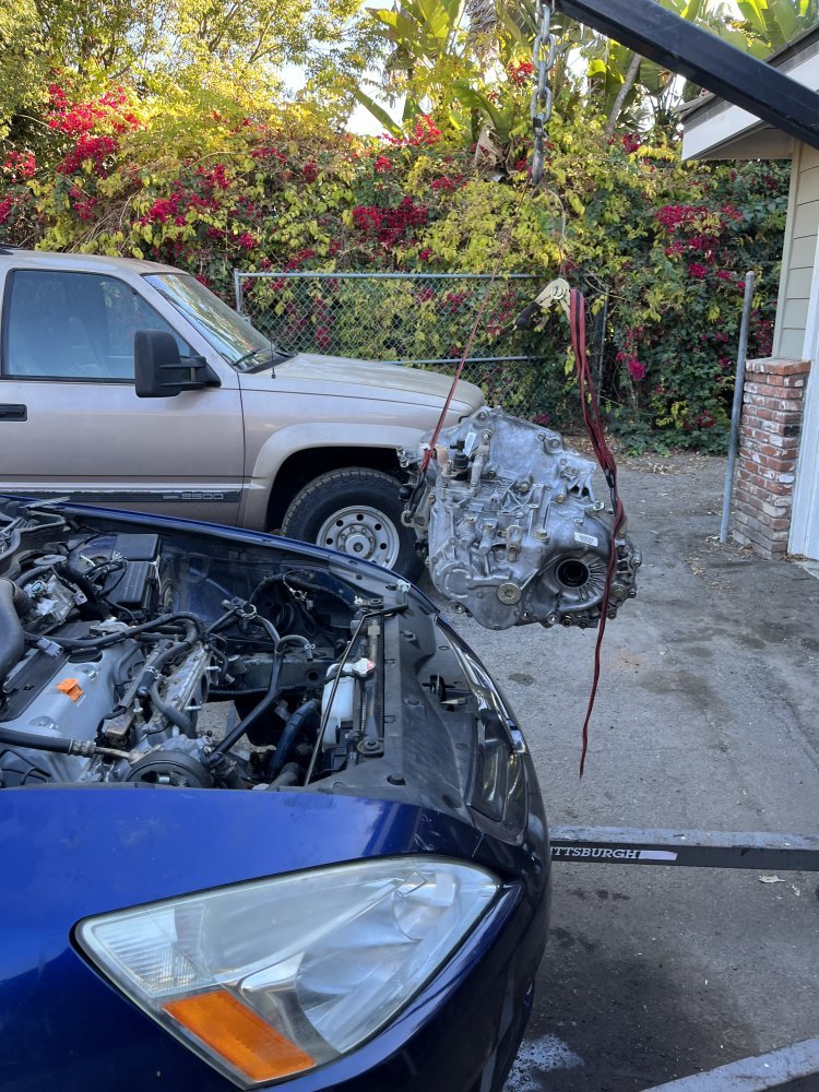

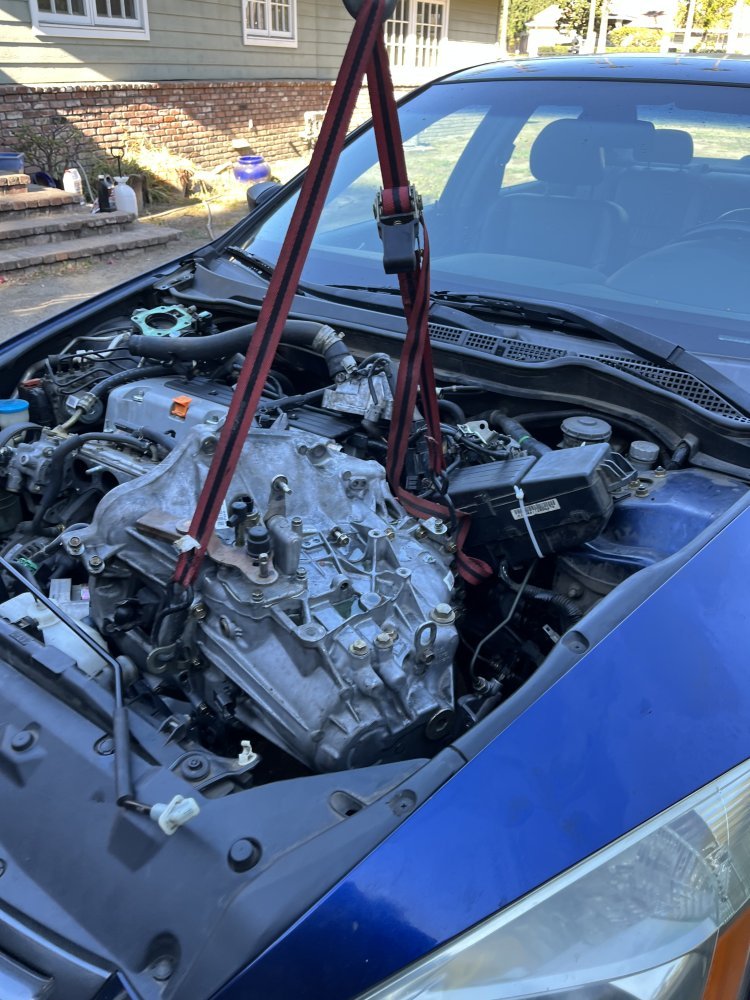

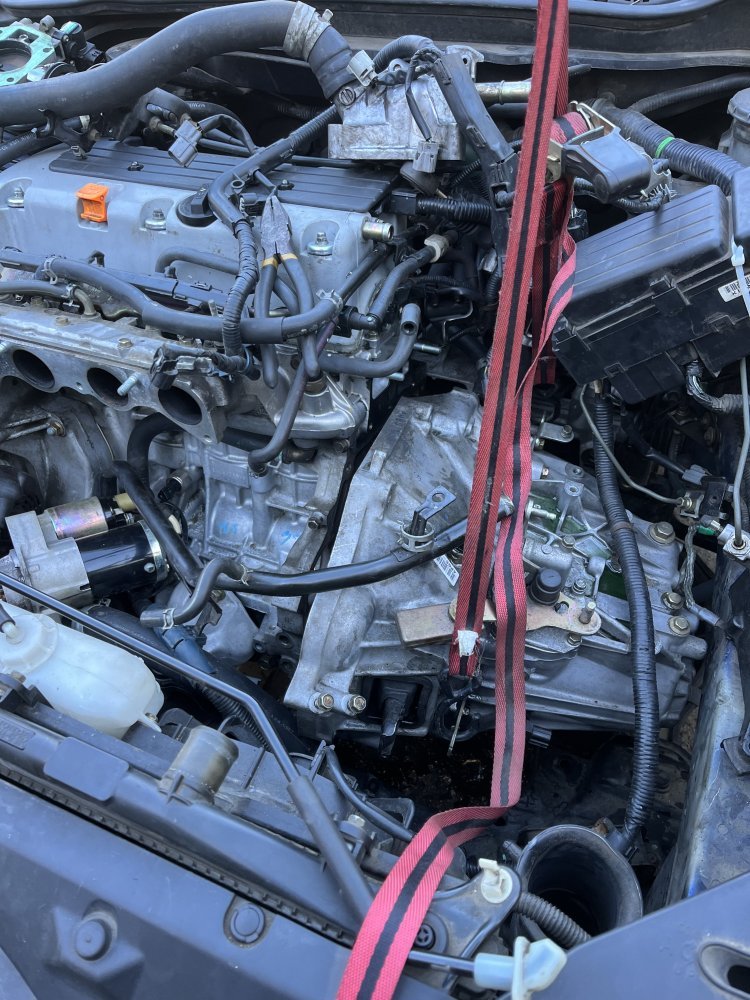

DBrannon had me second guess on pulling the transmission from the top of the engine bay, so I checked…

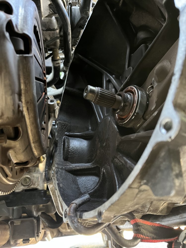

There’s enough room as only the smooth tip portion of the input shaft that goes into the pilot bushing sticks out beyond the transmission case. But it looks like I will have to pull the flywheel.

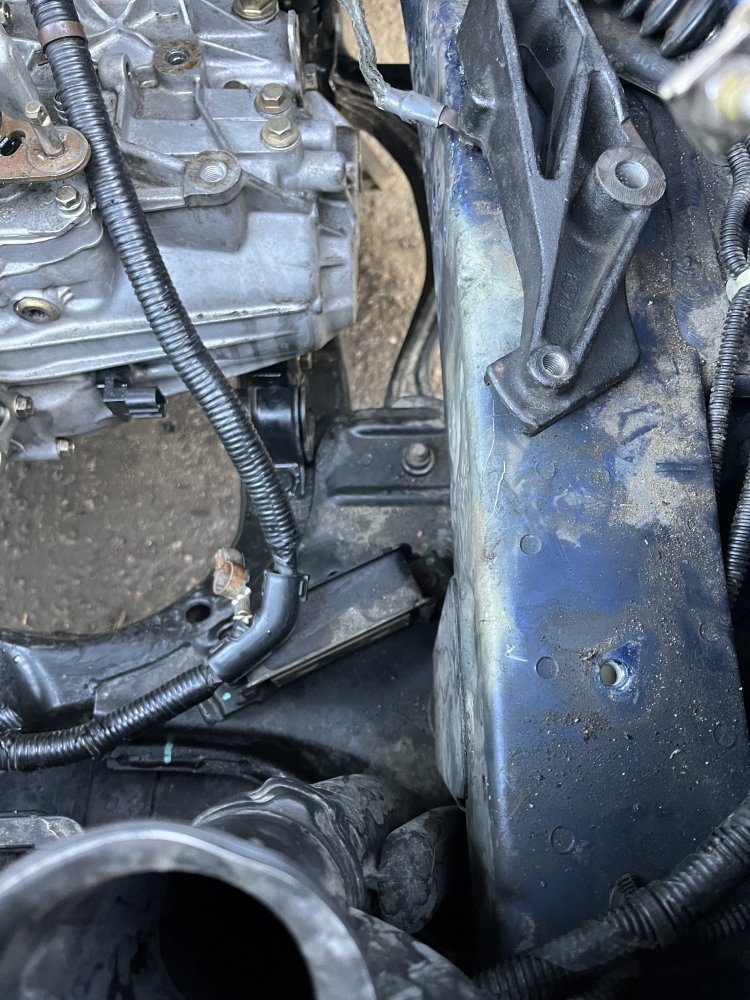

looking at what room you have between the trans and the radiator, you might be able to twist the trans some along with it looks like you still have a couple of inches of room between the frame and the trans to go up and out.
That's the plan and the video above, albeit a V6 with manual 6 spd, shows exactly that. So I'm almost there. Did not go into the office, so maybe at lunch today.

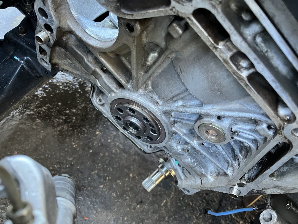

I had already replaced clutch assembly, throw out bearing and flywheel. Put it back together and the noise I was chasing persisted. Called this manual transmission rebuild shop, described the problem (noise disappears when I depress clutch while it is in neutral) and they said it’s in the transmission. So I pulled the transmission, and brought it in for rebuild. So I already have new clutch everything with just a couple miles on it.
That's good. And at least you had practice partially pulling the transmission doing the clutch replacement and it was recent enough that you could remember the procedure.
