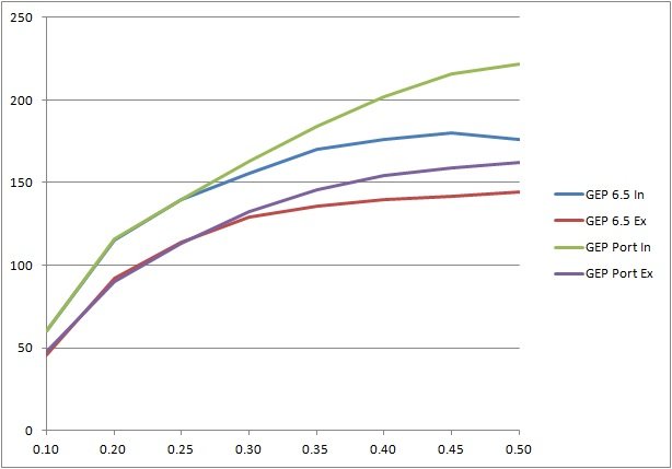

Has anyone one put the 6.5 heads on a flow bench? It would be awesome to see at what lift the there is no added flow. That way a cam can be designed around that. A little added lift, duration and a change in the LSA would really help the 6.5 when paired with a bigger turbo. I've been working on a cam for my build. But I'm not even close to putting the engine together... one day.

Several people including @Twisted Steel Performance have done flow bench and head improvements. Safe to say the stock heads are well known for leaving HP on the table.

Exactly, after the turbo and exhaust is upgraded the real hold back on the 6.5 is the heads and camshaft.
I would love to see a chart with port flow at various increments of valve lift for a stock 6.5 head. There comes a point where adding lift doesn't add additional flow because the head is the restriction. At that point port work is needed to increase the flow. So knowing at what valve lift does the port flow stop increasing would be very helpful in the development of a performance camshaft.
Well your in luck, I have been porting these heads for many years and have flowed countless heads. I have posted charts here and other forums many times.
Several years ago I knew of 2 other shops that offered porting, Diesel Depot & Peninsular Engines, Diesel Depot is long gone, Peninsular may still have another shop other than me that will do it, not sure tho...
I flowed heads from late 80's all the way to new P400's and aftermarket, and ported from the 2 other shops to compare my numbers with, I still have most of the charts as well .
I have slowly been increasing the flow as well as cc volume in the runners, and I cut a P400 head apart to confirm they are really different castings than GEP heads, yes I cut a 1K head in pieces so I would know for sure...
I currently have 1 new set of box stock heads here, they are in line as we speak to be flowed, this time a little different, I'm having the numbers taken every .050" lift all the way to .500". Then, my personal set will be flowed the very same way, but mine have the largest intake & exhaust valves possible. This run is two fold, the low lift numbers are as important as total lift is, and for those that want to know want a maxed set of heads can flow..
The below chart shows a stock 2003 GEP head with minor porting, as you can see the stock heads drop off or max out and fall, the others don't ... and this was a progress checking flow not finished work... The exhaust side is where I have been working to develop the greatest gains...

Thanks @Twisted Steel Performance that's exactly what I wanted to see!! It looks like the stock cam has enough lift to almost max out the flow capability of the stock GEP heads. That's really good information to know!!
