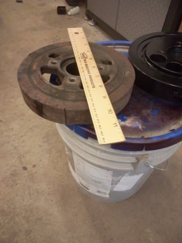

Wear marks on crankshaft snout

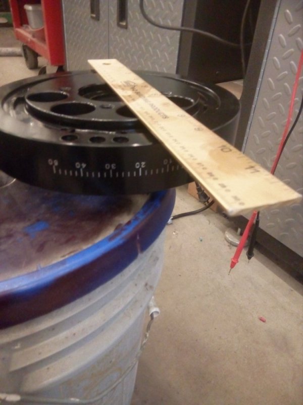

Anyone know what the mark on the OEM balancer is? Hopefully it's not 0*

First impressions are good . Quite a bit smoother at idle seems smoother all the way to redline. It went on just like all the others I've installed perfect world would be 1/2" longer bolt.
So sitting and thinking about this do you suppose the outer ring is 0 balance? It would make sense from a manufacturing standpoint.

When you sit one on top of the other, and line up the keyway, where is the line compared to the new one...
