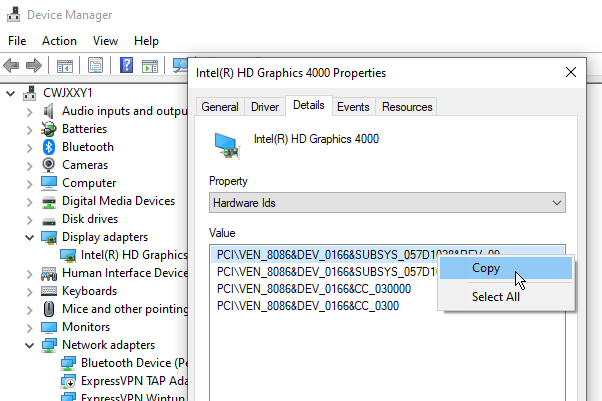

just one of the things windows isn't good at! finding our hardware. if the link I posted doesn't help. try opening device manager by right clicking the start button, choosing your display adapter properties, choose details. click the drop down box and choose hardware ids. right click the first value and copy. then in a search online paste the info and you might possibly find something that points to a driver. that's usually how I find drivers for older and outdated hardware I install windows 10 on that "they" say isn't supported. normally a windows 8 driver works fine, just try to find the most recent release date shown. if it's a pc like a dell. looking on their support site with the service tag or serial number sometimes helps.

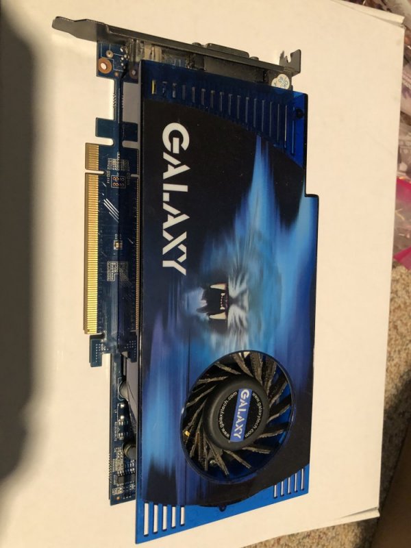

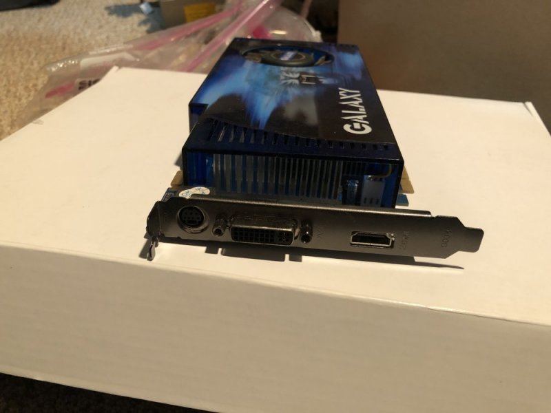

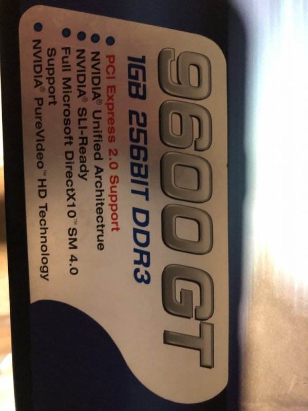

I was in the loft the other day. Amongst a bunch of stuff is a high powered video card.
I do not remember why I got this card or what computer I was building when I bought it, or why it is still setting there in the box.
I’ll get a pic of it and throw it out here.
I imagine it was for something that I was running windows 7 on.
If it would work in a ten I know knotttt.
You are welcome to it if it os something You, or, anyone else could use.
Better than going into a scrap heap.
