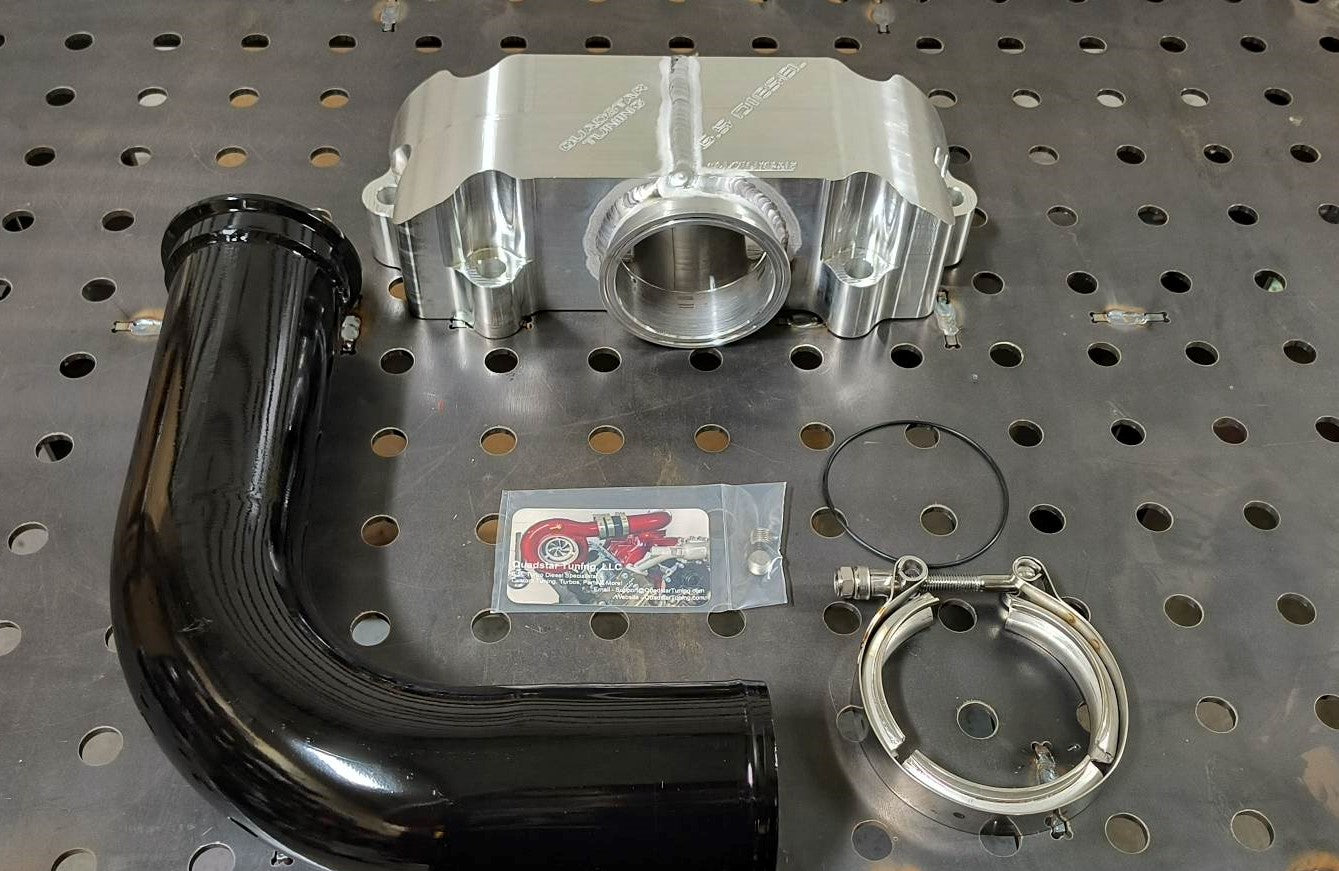

Center Mount to Side Mount Conversion High Flow Plenum​
Yeah- thats a nice set up for it. You also have to get the oil block off plate & seal for where the centermount turbo normally is.
The van/hummer/hmmwv intake manifold doesn’t flow as well as the truck lower or hummer n/a intake. Idk if @Twisted Steel Performance has the flow numbers handy but I remember one cylinder (#2 iirc) was horrible. Idk what it would take to fix that… massive hole saw? Haha.
I think the kit comes with the block off plate
