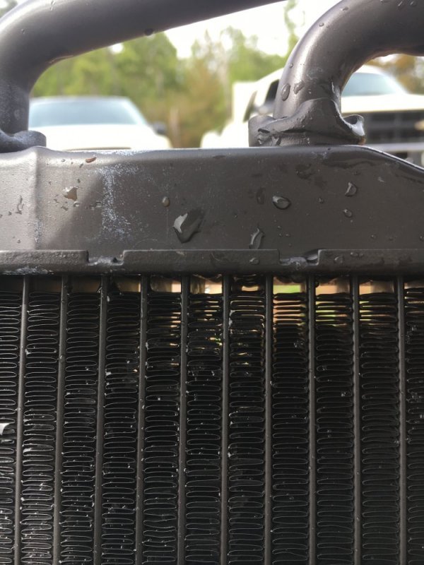

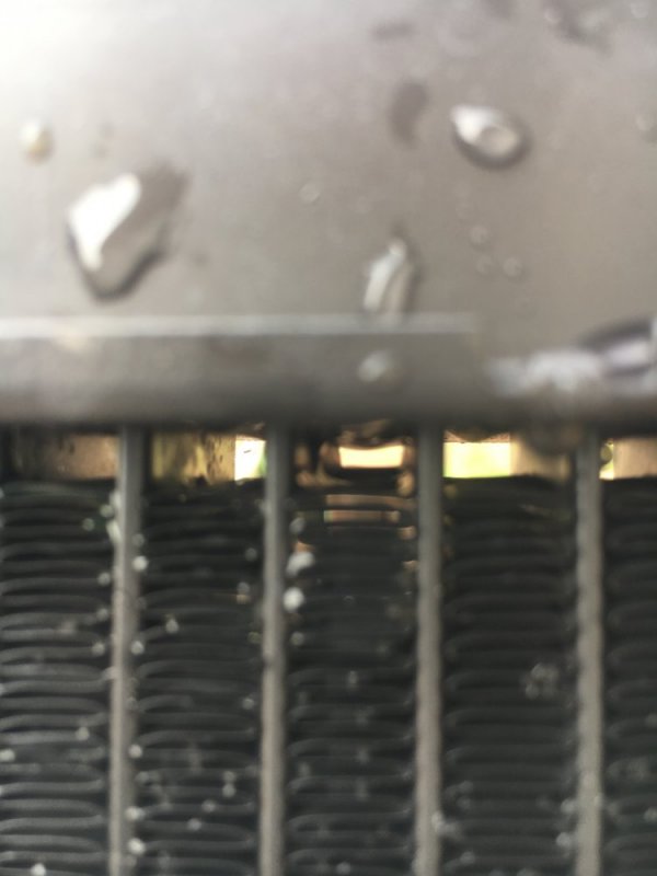

Well, I don’t think welding up the heater core is going to work out. It ain’t leaking around the oring like I thought it would be. I pressurized it with my hose pipe and I can’t tell if it’s leaking at the top of one of the tubes or where the tube is attached to the top of the core. It’s hard to tell especially by the pictures

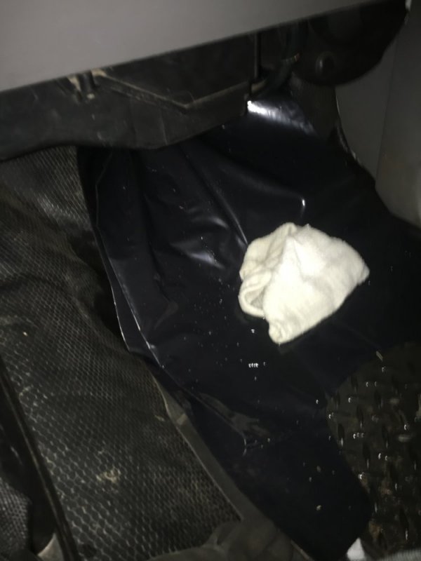

I wedged a trash bag under the heater core to stop as much antifreeze from getting under the floor mat that I could then threw a rag on the trash bag to soak it up on my way home from the hospital. It helped a little. If you look close you can see two different steady streams of coolant running out. I made it home that night by pulling over 4 times to fill up the reservoir. I Made the over a hour trip home from the hospital with no problem.

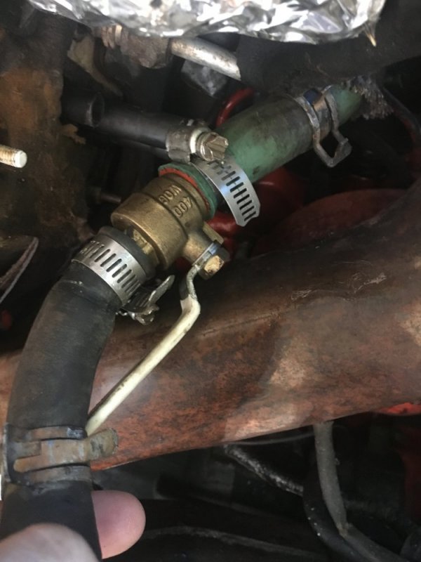

I temporarily fixed it by bypassing the core with a 1/2” pex ball valve. This is the second time in less than a year that this pex ball valve has been used for this.
