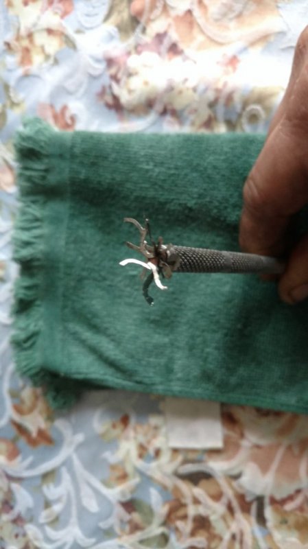

Found ferrous metal shavings in the fuel bowl.
About 3/4 inch long and 1/8th wide. No clue why but obviously something got chewed up. Might be why I had white smoke too. I've ordered a moose junior pump. I hope my injectors are OK.

Pictures? What/where do you mean "fuel bowl"?
